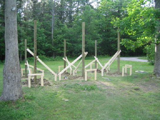

Here's a pic with the posts set and ready for concrete. I finished laying concrete tonight, so as of now it looks the same only it's not going anywhere.

I'd use a doubled up 2x6 for the front and back. A 4x4 is just 3 1/2" high, and that's not enough to span 8' without eventually deflecting. The width of the 4x4 doesn't really help that much, but the extra 2" of the 2x6 does. It will just make the roof 2" higher, but top plate a lot stronger. If you make one of the 2x6's flush with the outside edge, you won't see the inside one being a little shy of the inside of the 4x4 posts. Nail the 2x6's together every 12" for added strength.

Thanks bebster. I'll plan on at least a 2x6 double top plate laid on its end (6" dimension vertical). Got any recommendations for drafting software (inexpensive would be nice) if I wanted to draw up plans?

Well, I'm back at it and have the lumber to frame the roof. I have 6 20'x2x6 to support the rafters, and 12 12'x2x6 for rafters (24" centers with one rafter on each side of the posts). I am in a bit of a conundrum as to whether to nail 2 2x6's together for the rafter supports, or to nail one 2x6 to each side of the posts. All the pavillions/sheds/barns I have seen nail one support to each side of the posts, although I would think I would get more strength out of the 2x6's nailed together. My concern about nailing them together and placing them on top of the posts is getting lateral stability: you end up with the rafters sitting 5 1/2 inches up on top of the support with only 3 1/2 base. Does that make any sense?
Also, should I have any front-to-back supports or are the rafters enough?
