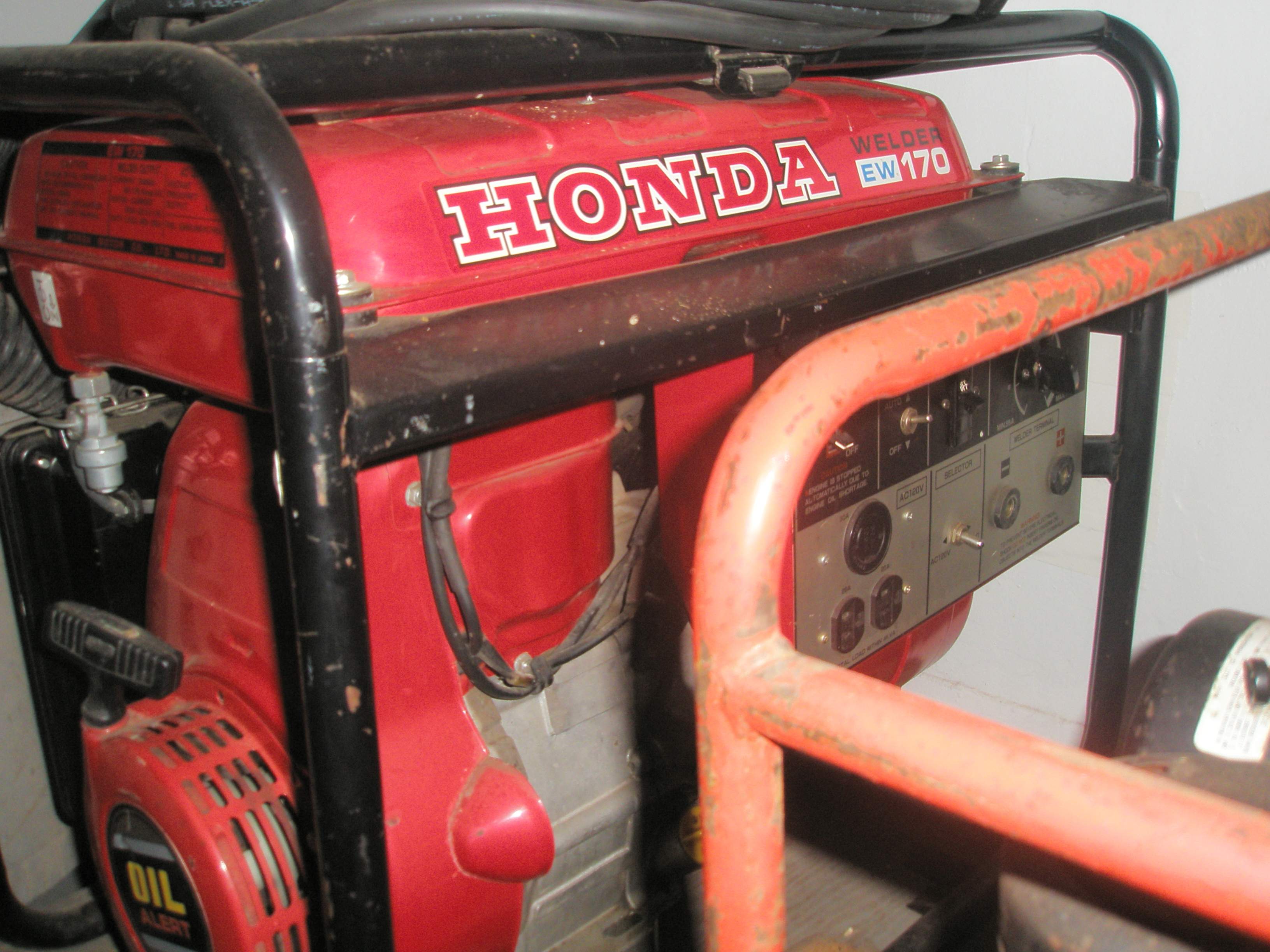

I have a Hobart handler 135 (the new model is 140) mostly collects dust. when I do use it I use gas, never even tried the free spool of flux core that came with it. Most of my welding is hillbilly repairs/builds with 3/16" and up.
I also have a Honda portable 170 amp machine. I don't need to do much remote welding, but have used it with decent results.
Anyone have an opinion on this type of machine, is it something you could make money with, or just a show piece. I got it very cheap from a friend, so I couldn't refuse it.
I really like Honda equipment, but I know they are not known for commercial tools.
