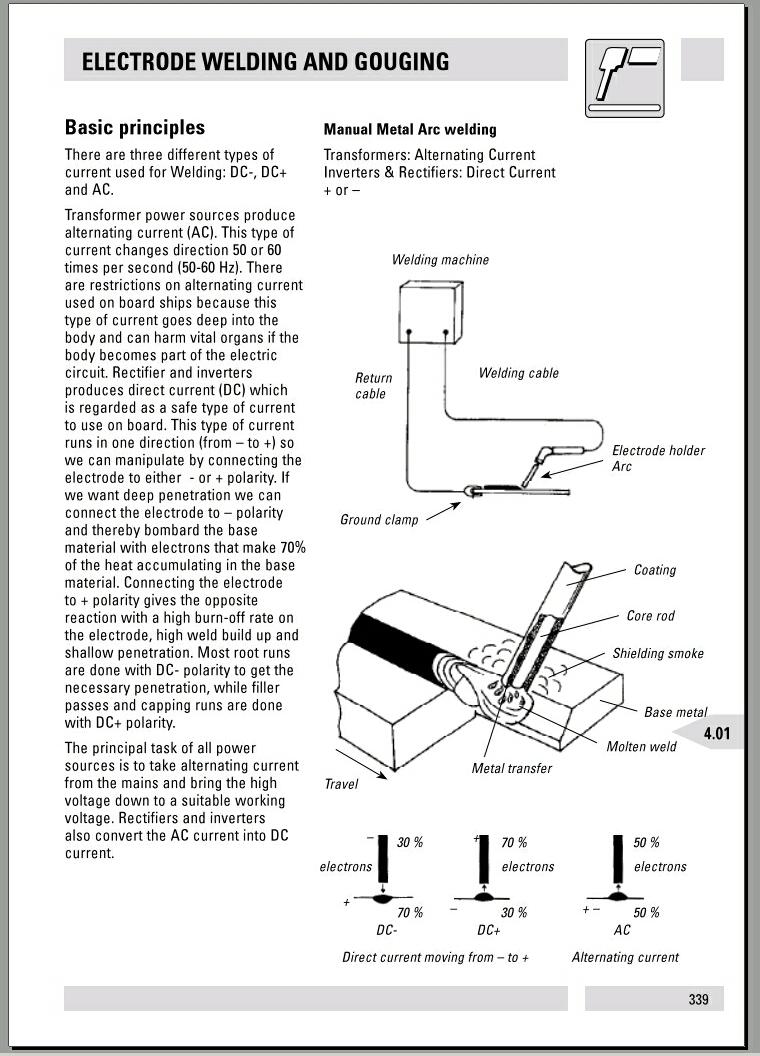

The Welding Handbook for Maritime Welders :thumbsup:
attachment.php
Nice find Rhett. I appreciate the support document from a published source as it definitely does help reaffirm my statements as it is real close.
Every document that I have ever seen has almost always showed 2/3 (or 66.6%) and 1/3 (or 33.3%) as the splits. Of course I always rounded to 67% and 33% to keep it easy for me in my head. I have a feeling that your source may have rounded a bit further to 70% and 30% to keep it at hole numbers of 10 allowing for even simpler mathematical figuring in the head calculations.
Regardless - either figure is close enough to get you in the ballpark.
My way 100 amps AC would equal 83 amps DCEP.
Your book 100 amps AC would equal 80 amps DCEP.
FWIW: I am reasonably sure my figures are correct as I have read a few welding studies documents over the years comparing AC weld current to DC weld current. Every one that I have ever read showed DCEP to be roughly 15% to 17% more efficient than AC. Using the 17% value puts the multiplier right at the 0.83 number that I always use.
If you want another document search for your free time, then let the hunt begin.

Typically, I think of it this way to help me:
AC = 50% heat into rod and 50% heat into workpiece.
DC electrode positive = 67% heat into rod and 33% heat into workpiece. (DCEP is most common polarity used and results in max penetration).
DC electrode negative = 33% heat into rod and 67% into workpiece. (rarely used, but helpful on thin sheet metal if no wire feeder and results in min penetration).
So what does it mean? In short for whatever setting that you were using on your old AC buzzbox take that setting and multiply times 0.83 for a rough starting point setting and adjust from there accordingly as needed. ( e.g. 100 amp setting on AC buzzbox would roughly equal 83 amps on DCEP).
Maybe I am a little slow, but doesn't the chart say DCEN gives more penetration and DCEP less penetration?:confused:

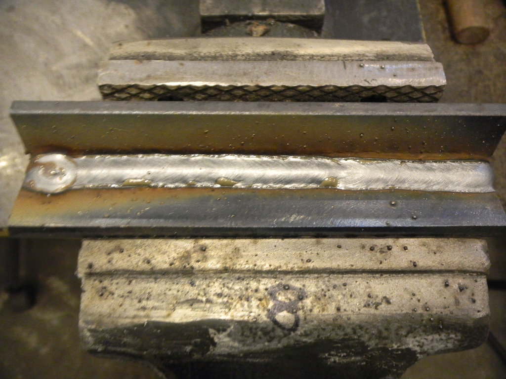

Here's some Mig welds I just did with a 46 year old SA-200, (no CV box) LN-25, and C25.
Those are nice welds. If I could find a used VS feeder CHEAP ($100 or less) I would probably pick it up. I dont really feel the need for a mig right now. I would rather have a tig rig for it. But if I found a deal that good I couldnt help buying it.
