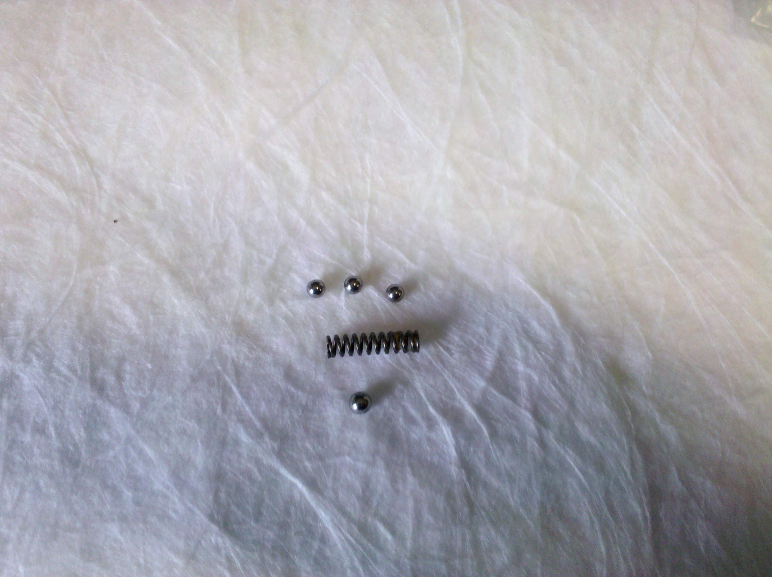

This is what came out of the valve on my CK35. The larger ball is .249" and the smaller ones are .218".

did you miss my previous post ? I provided a picture and measured the balls like you asked. That is what came out of my 2 year old CK35, I'm sure the 30 is the same.

Hey BJN I just looked at your picture.
Whew.
Where do the ball bearings go? I assume the spring is an inline thing, between the hex nut and the rod coming out of the valve...
Thanks
Mike
   / De-Detenting the Kioti rear remote valve #20
I'm sorry I can't say for sure where the balls go, the dealer removed them for me on the parts counter when I bought the kit. It didn't take him long, so I'm thinking it's an easy job. I would contact Bob @ Michigan Iron or Rick @ Wallace Tractor, both those guys are great, and I have talked to both of them on the phone and email and they have been more than helpful when I had questions.
