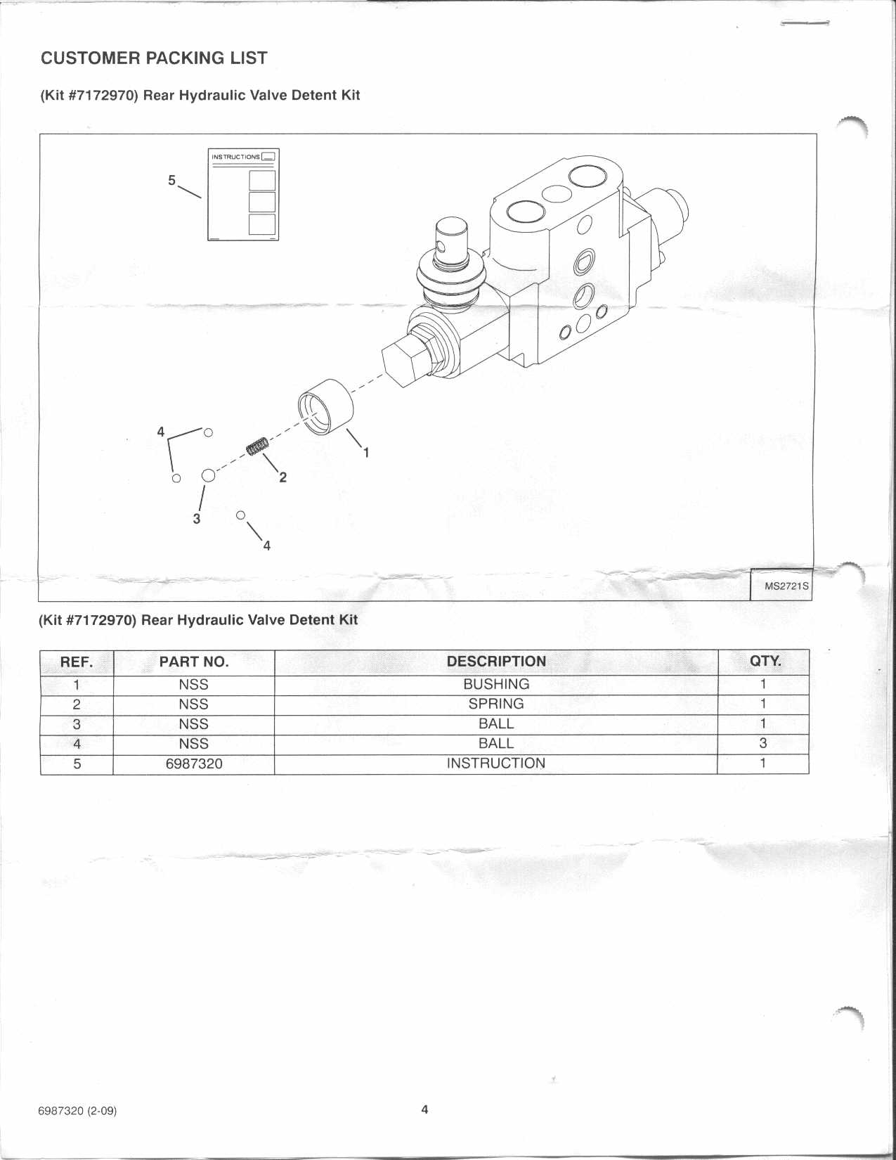

Here's the instructions from the kit Rick Wallace sent me. It is to convert a non detent to a detent remote.
Mike

Thanks for posting the instructions Mike. Mine still work but it's always nice to have some help when you have to dig in.
