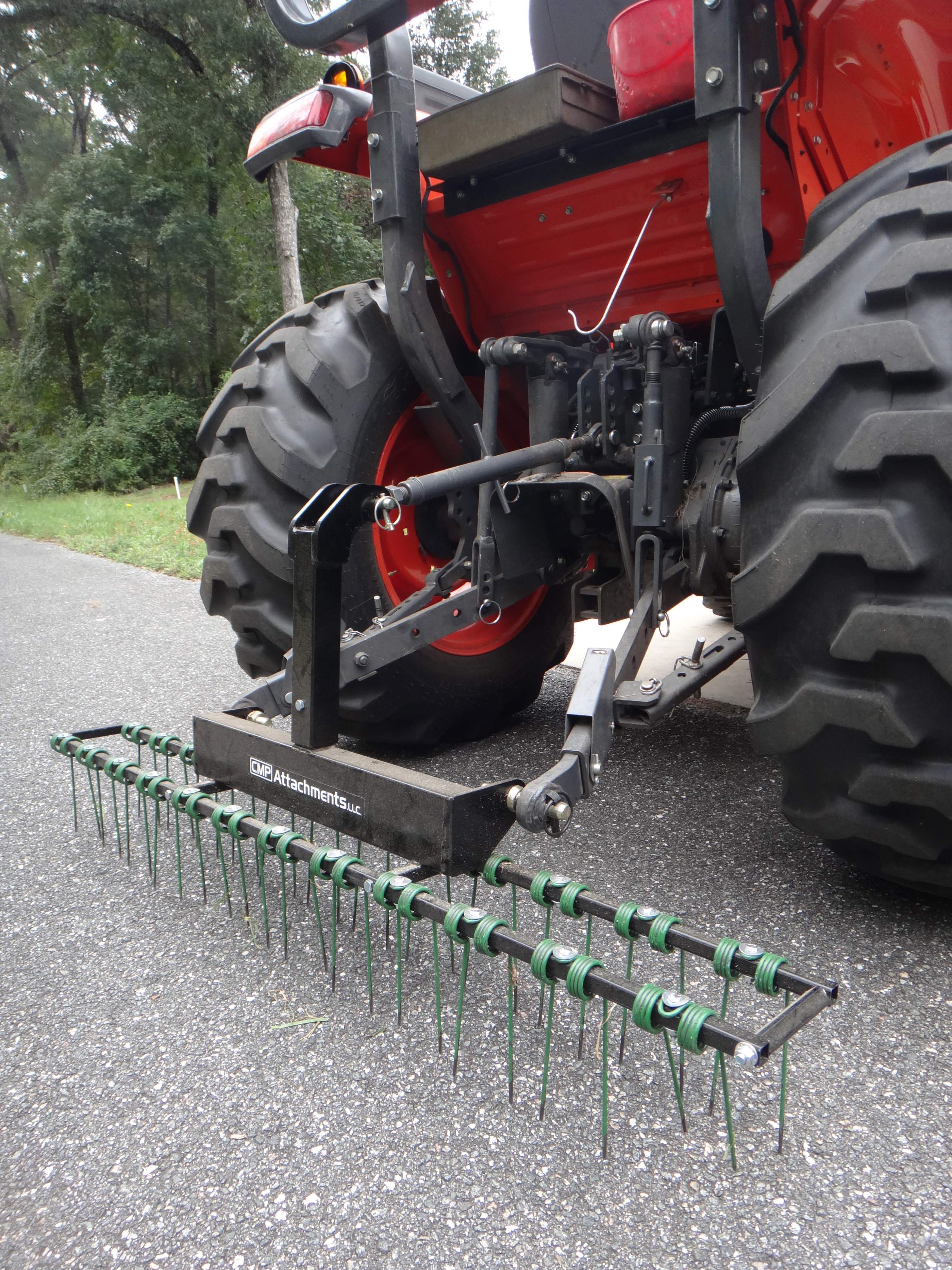

I suggest a Three Point Hitch mounted FRAMED CHAIN HARROW.
You will not want a drag Chain Harrow as manually lifting and cleaning it after every row will be too tedious.
Several outfits offer framed Chain Harrows. Note that ABI has 1/2" rather than 3/8" "chain". In all ground contact work, weight is your friend.
LINK: 3 Point Chain Harrows ::ABI Attachments::
I own a CMP (tined) Lawn Dethatcher. Great for a smooth 1/2 to 1-1/2 acre lawn. I would not recommend it for use on uneven pasture. I am skeptical a Pine Straw Rake, which is also tined, will hold up in regular pasture use. The spindly tines would likely bend or break loose from the attachment fittings.
A suspended, Framed Chain Harrow is a more robust implement and, being flexible, will follow the contours in your field.

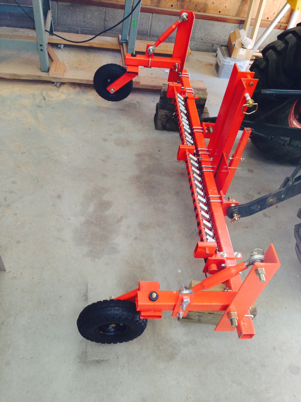

I had the same problem a while ago. Couldn't find anything that would follow uneven ground and remove thatch without tearing up either the ground or the implement. So I made this. It has spring tines, and secondary springs on each tine to allow easier conforming to uneven ground. It works well, and even better now that I have a top/tilt setup with floating side link.
That is very interesting. Do you have more pictures you could post?
