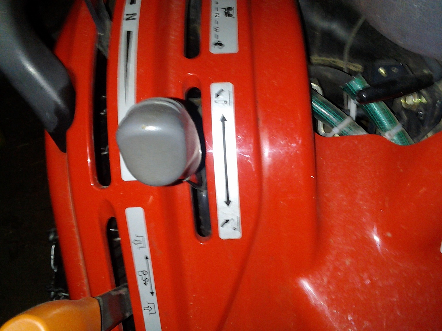

The GC1710 is said by many NOT to have position control. This was a question at the time because based on what the dealer told me, specifically concerning using the Tiller and controlling the depth of cut, that the three point hitch is used to raise the tiller to the desired height for tilling. Thus,,, PC. TrippleR then stated that the GC1710 did not have PC because it could not adjust for Drift. IF,,, you accept the explanation from Johnson City Kubota LLC as an accurate description of PC, then the GC1710 indeed has PC. So as have been stating repeatedly, this boils down to WHAT PC IS. Not trying to figure out 1000 different ways to accomplish it. My question is MUCH SIMPLER then that.
The Massey GC1710 can not both at the same time,,, HAVE PC, and NOT HAVE PC. It is one or the other. Can you speak to this JJ?
My opinion is that PC can be stopped at a particular position each time with no load sensing
Load sensing sounds like draft control to me.

Kubota is something for sure. There is a center neutral position, such that even though you can stop the 3pt hitch at an infinite number of places on long the length of its travel, you can't place the lever in any position that allows you to identically match the same height adjustment every time. So if we are using this definition of PC, simply being able to stop the 3pt at any place along the way is not good enough. You have to be able to place the lever in some specific position that recreates that height adjustment every time. A center neutral lever mechanism does not allow this.
Kubota does have some tractors with position control, where you have a scale and numbers on the lever that indicate position of the hitch. That is to say, there is a correlation between the lever setting and the hitch position.
They have other tractors that do not have position control, where there is an up and down direction to the lever, and it will return to middle (what you call neutral but it's just the default center position of the lever). There is no correlation between lever position and hitch position at all. You move the lever up and the hitch moves in the up direction, and vice versa.
Both systems let you stop the hitch anywhere along it's travel. With position control, the hitch position corresponds to the position of the lever. Without position control, there is no relation between the hitch position and lever position and it's up to the operator to pick the height via eyeball (or counting taps of a quarter incher if they have one).
