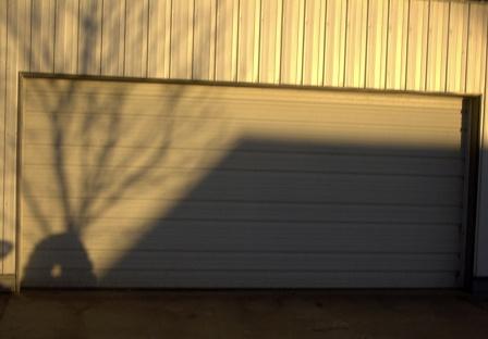

picture this time! /forums/images/graemlins/blush.gif
but still lousy..../forums/images/graemlins/grin.gif

I see now!! Looks like all you will have to do is set the buildings on top of 8 inch blocks.

Spiffy,
Not sure if your still looking for brainstorming ideas but if I'm picturing this correctly it shouldn't be too much work at all to deal with the support issues.
If that 4x6 above the door frame is load bearing could you just put two 7' vetical 4x6's on both sides of the garage doors going from the ground to the underside of this current support (to act as jack posts). Then directly above those put in two 12" vertical 4x6's then lay a horizontal support beam across the top of those. I'd probably add in some diagonal bracing too just because. /forums/images/graemlins/smile.gif Build these permanent supports then start your cutting.
Raising the whole door after redoing the supports would probably be more expensive since you'll have to add a new door section and extend your door tracks (or just buy a new door) but should be quicker/easier.
Installing the hinged door extension above would probably be cheaper but more time consuming.
Either way shouldn't be too bad though...

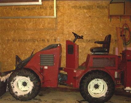

Been garaged since November, but finally getting the pictures of it [was out pushing snow and thought I better grab the camera before I even finished brushing off the snow].
Even beyond clearing the garage, I'm very pleased with the way it feels without the canopy. It clears trees nicer and it feels much less top heavy [of course, just the optical illusion of being 2ft shorter]. At the risk of alerting the safty police, I may even leave it off. Although a great compromise would be a slightly shorter ROPs without a canopy [so I don't wack my head with it being lower]; then I have somewhere nice to mount lights again! /forums/images/graemlins/smile.gif
   / Decapitate my PT (ROPS)? #36
Shorter ROPS is a great idea... Something I always wondered about the rear seated PTs like your 2445, how hot is it sitting over the engine compartment? In winter it sure can't hurt! /forums/images/graemlins/grin.gif There probably has been threads on this before but knowing I wouldn't go that route I probably skimmed by that question.
