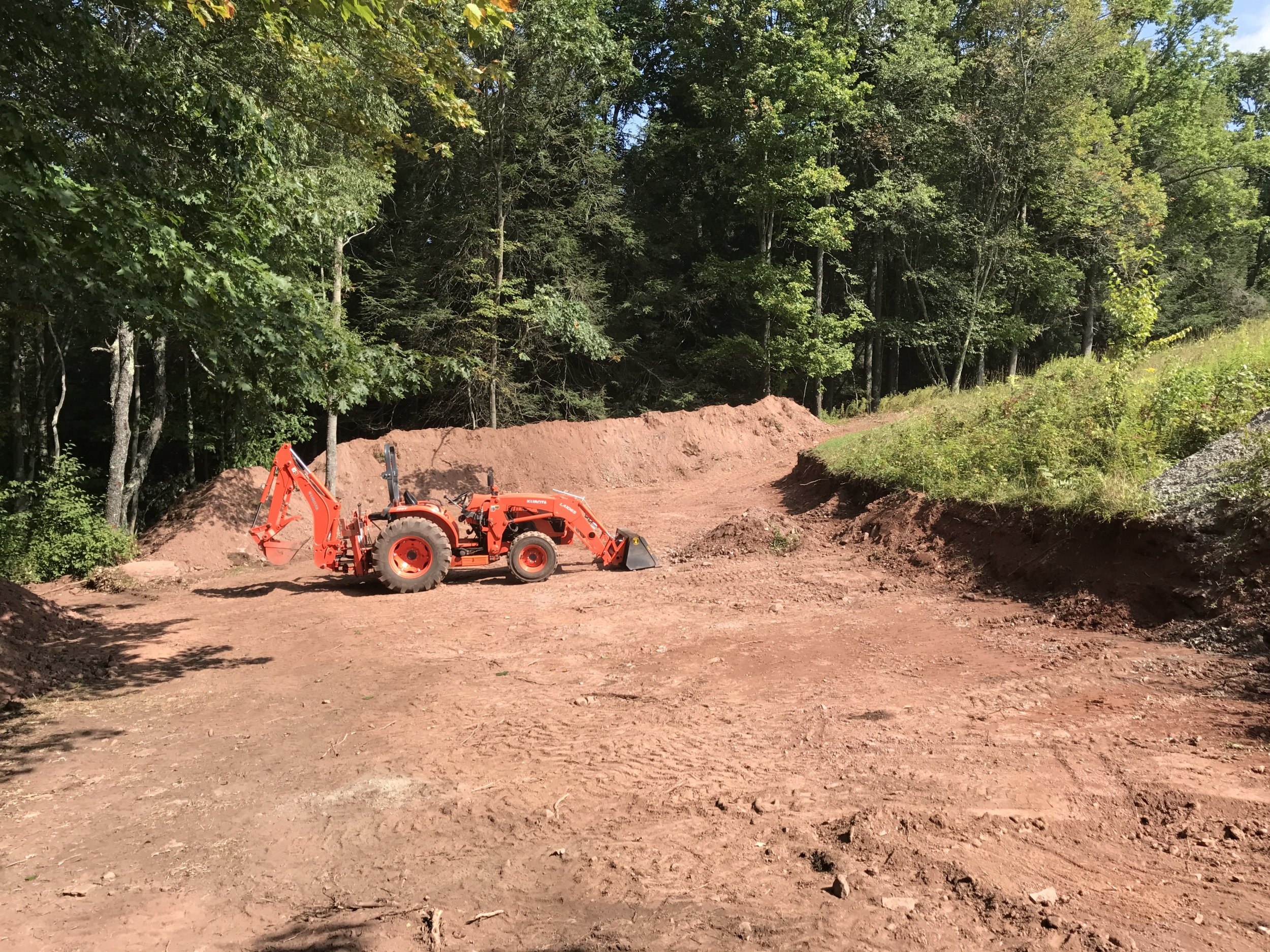

I have two HST tractors and would never go back to gear. I've never run out of power before the tires broke loose and I've done some fairly large excavations. Would have taken considerably longer to do this one with a gear machine:
Some newer HST's like the Kubota L series, have 6 speed ranges and some can be switched on the fly with no clutching or stopping.
You do loose a few PTO HP with an HST, but I bought a 60HP tractor to compensate.
