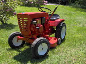

I appreciate the perspective you're offering. I'll be visiting one of the larger dealers around tomorrow and will talk with them about the capability of the upper level lawn tractors they sell and see if they can really do the work I want.
Another option that has just presented itself is an older used Wheel Horse tractor for sale locally. It's a recently restored tractor from the 60's with a freshly rebuilt Tecuseh engine and the seller is including a snowblower attachment, wheel weights, and chains with it. From the pictures it appears to be built much heavier than any of the new lawn tractors I have seen and the price is certainly right at a mere $600. I will probably go have a look at it later this week. Anyone have any thoughts on this?

Get it!!
None of today's machines will compare to this Wheel Horse. Especially at that price.
You'll have some repair and upkeep on it, but that machine is almost infinately re-buildable.

I definitely appreciate functionality far more than fancy gadgets or creature comforts. I have contacted the person selling the wheel horse and indicated that I will probably be buying it. I'm trying to set up an appointment to go inspect it later this week, and if everything is as the owner says I will buy it from him on the spot.
I think this is a good solution for me as I'm confident that the tractor will be much more durable that any of the other lawn tractors I've been looking at (it is still in service after 40 years after all) and if I decide that it isn't a capable enough machine I'll only be out $600. That's a heck of a lot better than spending $2k-$3k on a machine and deciding that it isn't adequate.

Here's some of the pictures from the classified add for a preview. I set up an appointment to go see it saturday morning and I'll be going with cash in hand. If it looks half as good in person as it does in the pictures it will be coming home with me.
-Steve
