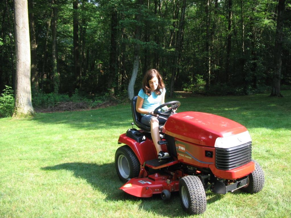

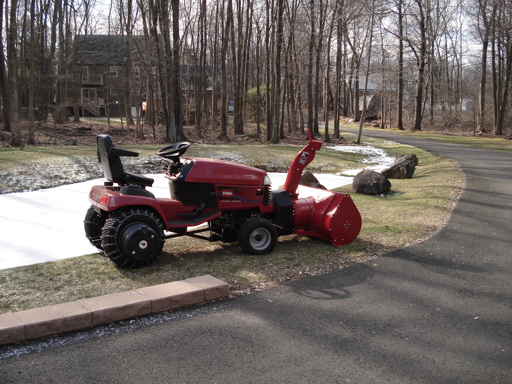

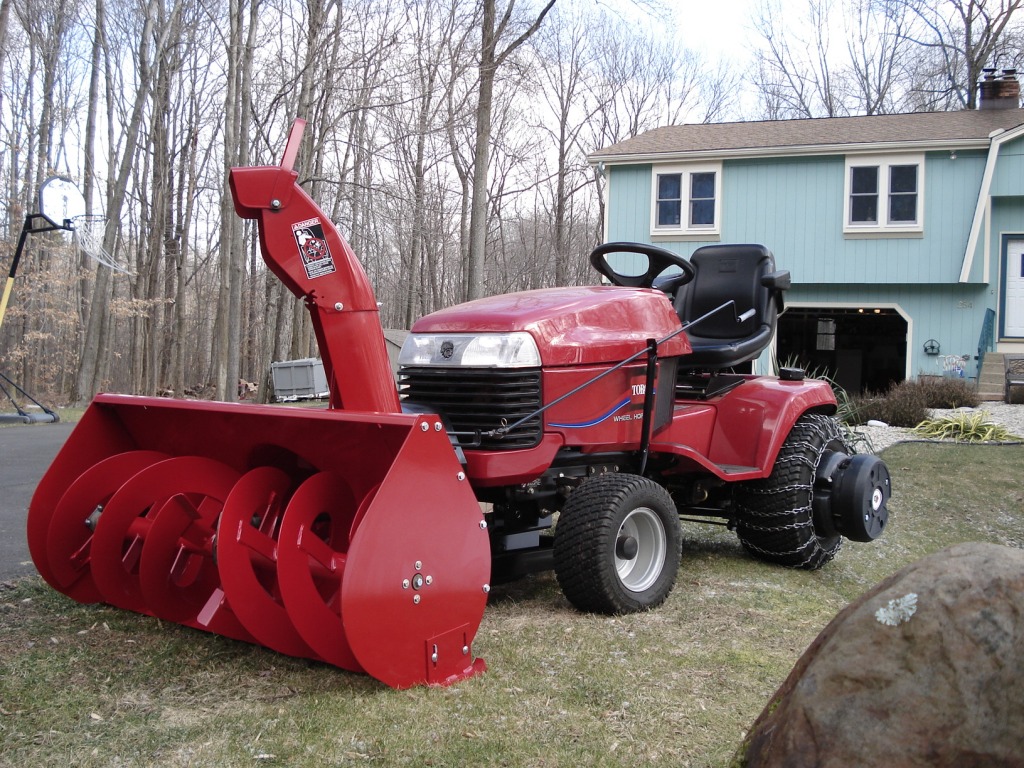

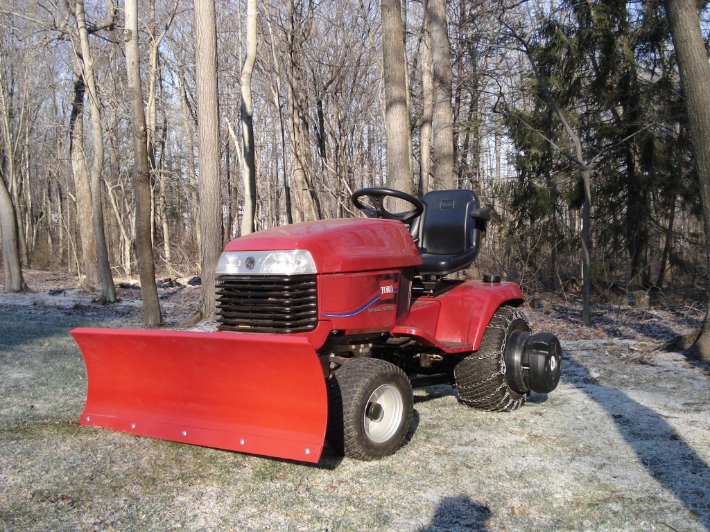

Hi Steve,
I too live in CT. I have three acres, one of which is grass that I cut, and a 550 foot paved driveway that I maintain in the winter. I use a Toro/Wheel Horse 522xi. 22hp, hydrostatic drive, shaft drive, power steering, hydraulic attachment lift, 48 inch cutting deck with vac, 48 snow/dozer blade, 44 inch two stage snow blower. This setup takes care of my yard just fine.
I use the blade for snow up to about 8 inches, anything more I usually switch over to the snow blower. Switching over is quite easy, as Wheel Horse has a quick attach system that lets you do it without even needing any tools. Wheel weights and chains round out the winter equipment. The snow blower can throw snow over a single story garage roof with no problem.
Before I got the 522xi, I had a Wheel Horse Charger 12, which was a 12hp heavy duty classic machine. I had a blade for it but no blower. I could clear my drive with it, but if it was going to be a heavy snow, I always went out several times during the storm to keep up with it. It was difficult at times, and without the hydraulic attachement lift, pulling the blade up gets to be a killer after an hour or so. I could not believe the difference between the Charger 12 and the 522xi at moving snow. There is no substitute for hp and weight. The 522xi makes it fun, verses what amounted to work. The two cylinder Kohler on the 522 is smoother and quiter than the single cylinder Kohler on the Charger 12, which you really start to appreciate if you are going to be on the machine for any length of time.
I also have a walk behind snow blower, a Toro Powershift 1232. This is the mother of all walk behind snow blowers, with 12 hp and a 32 inch cut. It can really move a lot of snow, but you will get a work out. It is heavy, vibrates quite a bit, noisy, and your fingers get **** cold and cramped holding down those levers. I have done my whole driveway with it a number of times, and it is more than up to the task, but if I have a choice the tractor is the way to go. I don't know why I hang on to it, should probably find it a new home, just hate to give up anything that has a motor on it!
Let me know if you need any other information. I have attached a few photos so you can get an idea of the size of the equipment. JD, Cub, and Simplicity make comparable size lawn machines.
Rick
