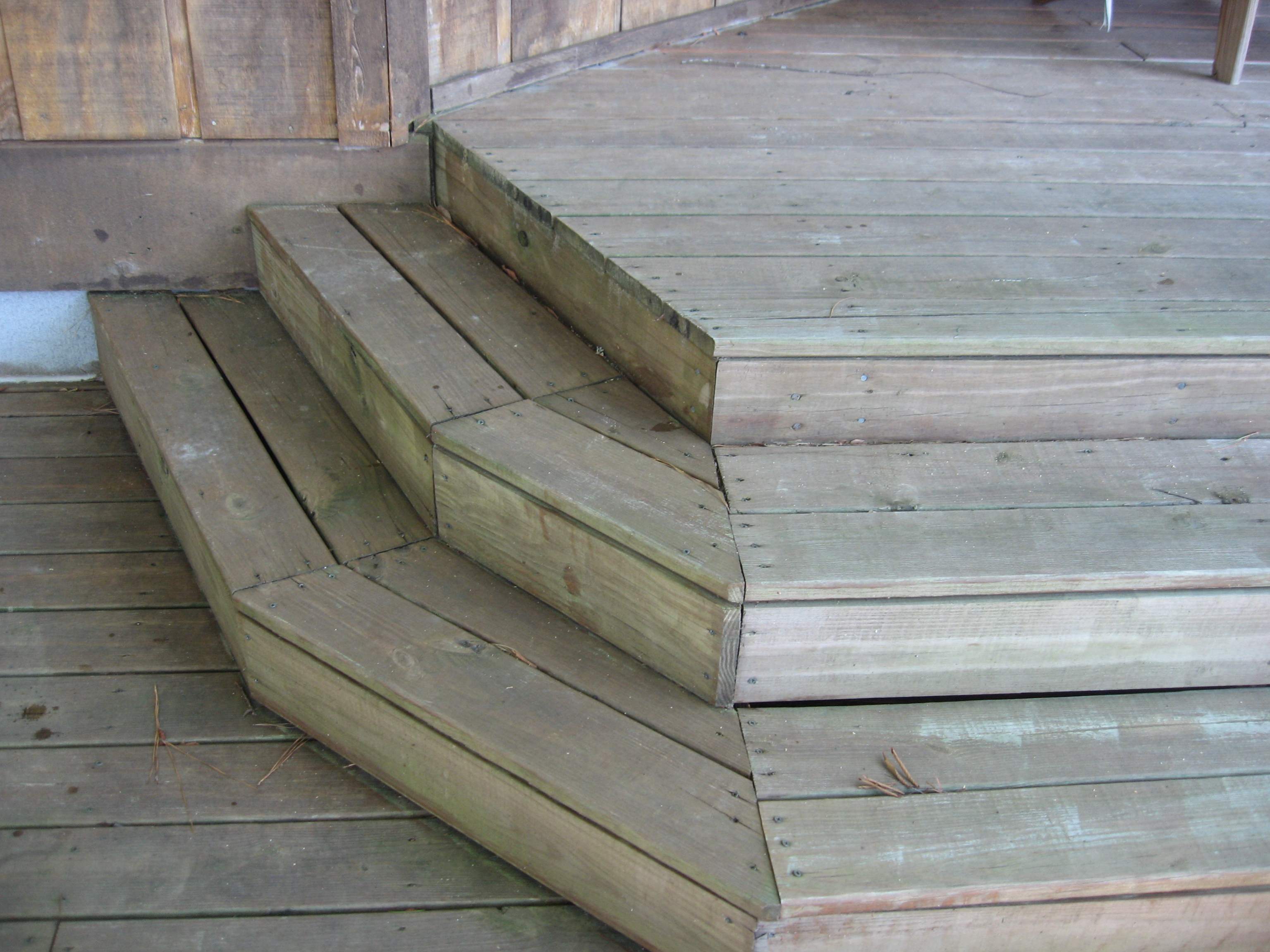

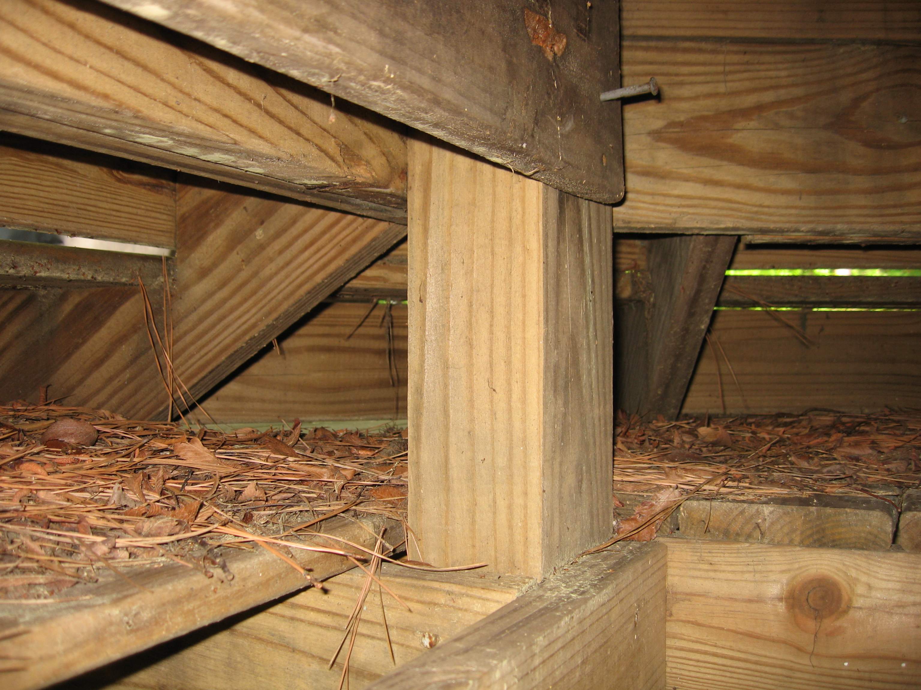

   / Deck Project Confusion #16
I think you probably have the info that you need, but here are a couple of pictures of what I did 10 years ago. It has worked well. Top and bottom shots.
