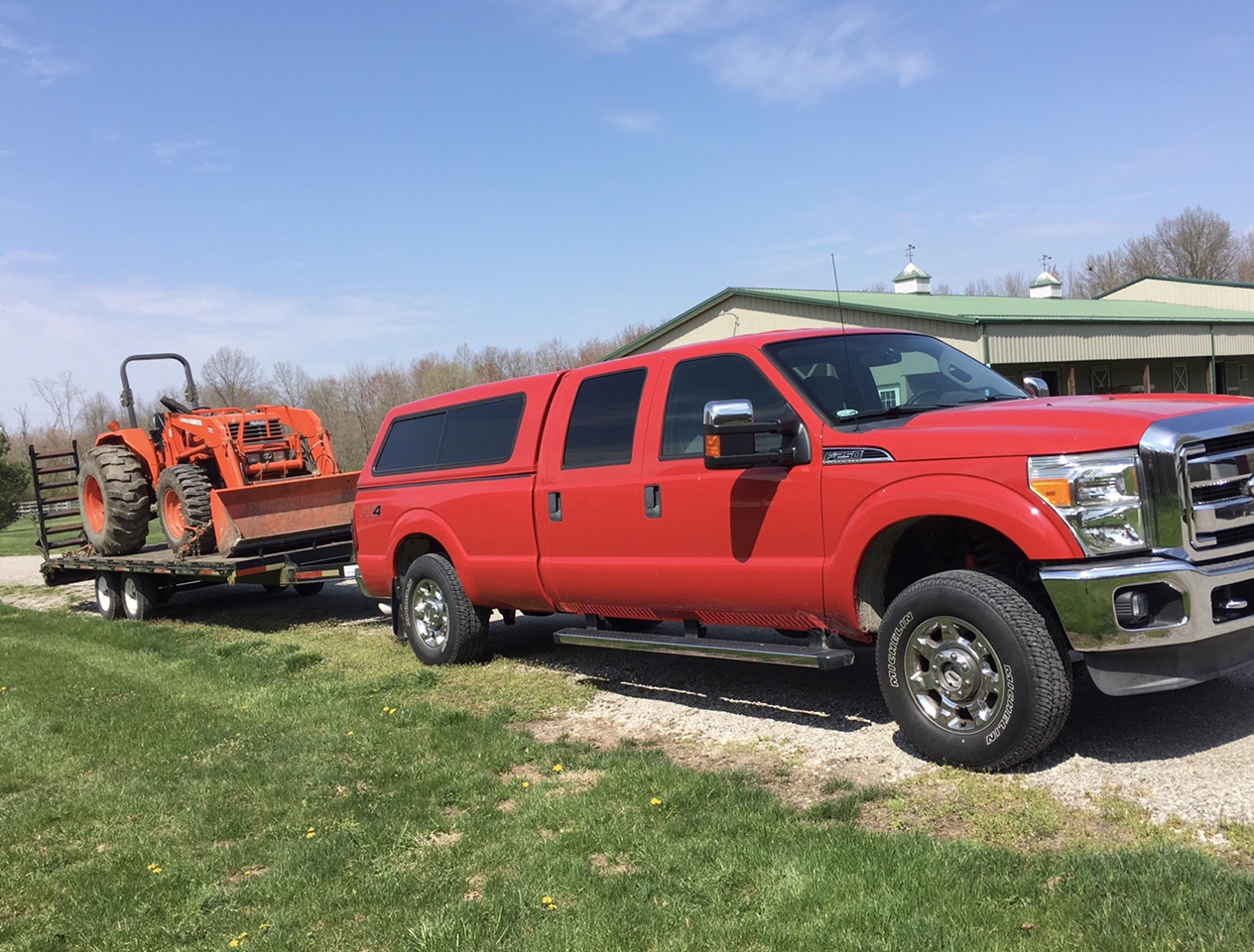

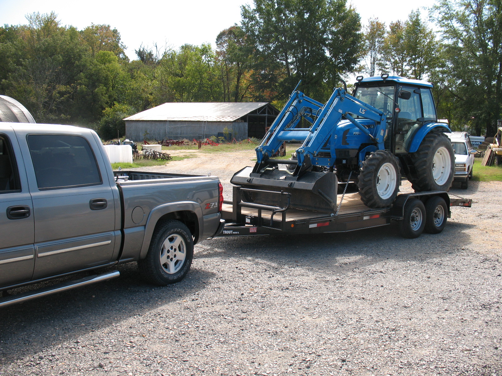

My car hauler deck looses nothing in width to the fenders and it is lower to the ground than a deck over. IMG_1135.JPG

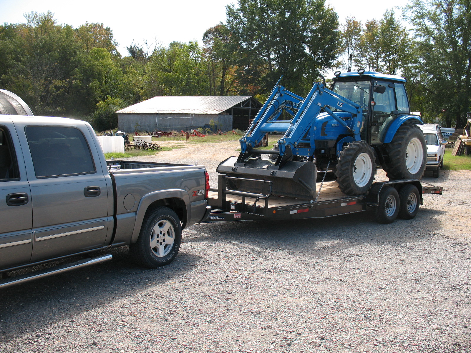

My car hauler deck looses nothing in width to the fenders and it is lower to the ground than a deck over.View attachment 657558
That's so cruel....that poor little Chevy.... :laughing:
How does that not loose width? wouldn't a deckover version of that be current width + of the fenders?
I did look at the car hauler ones too, but the ones at local place (only checked website from where I got my current one so far) the car haulers were 2 x 3500 lbs axles, which is what I have now, just different style. They had a double car hauler with heavier axles, but it was real long & axles set very far back - looked like it would be good for 2 autos, not so good for anything else. But I do like the lower deck and what you have pictured would work for me if heavy enough axles. Just seems the deckover would be more versatile, but having never owned one, there might also be a big downside I'm unaware of.

Not many deckovers with 82 inch wide decks. You are giving up 14 or 20 inches in deck width as compared to 99% of the deckovers in service.
