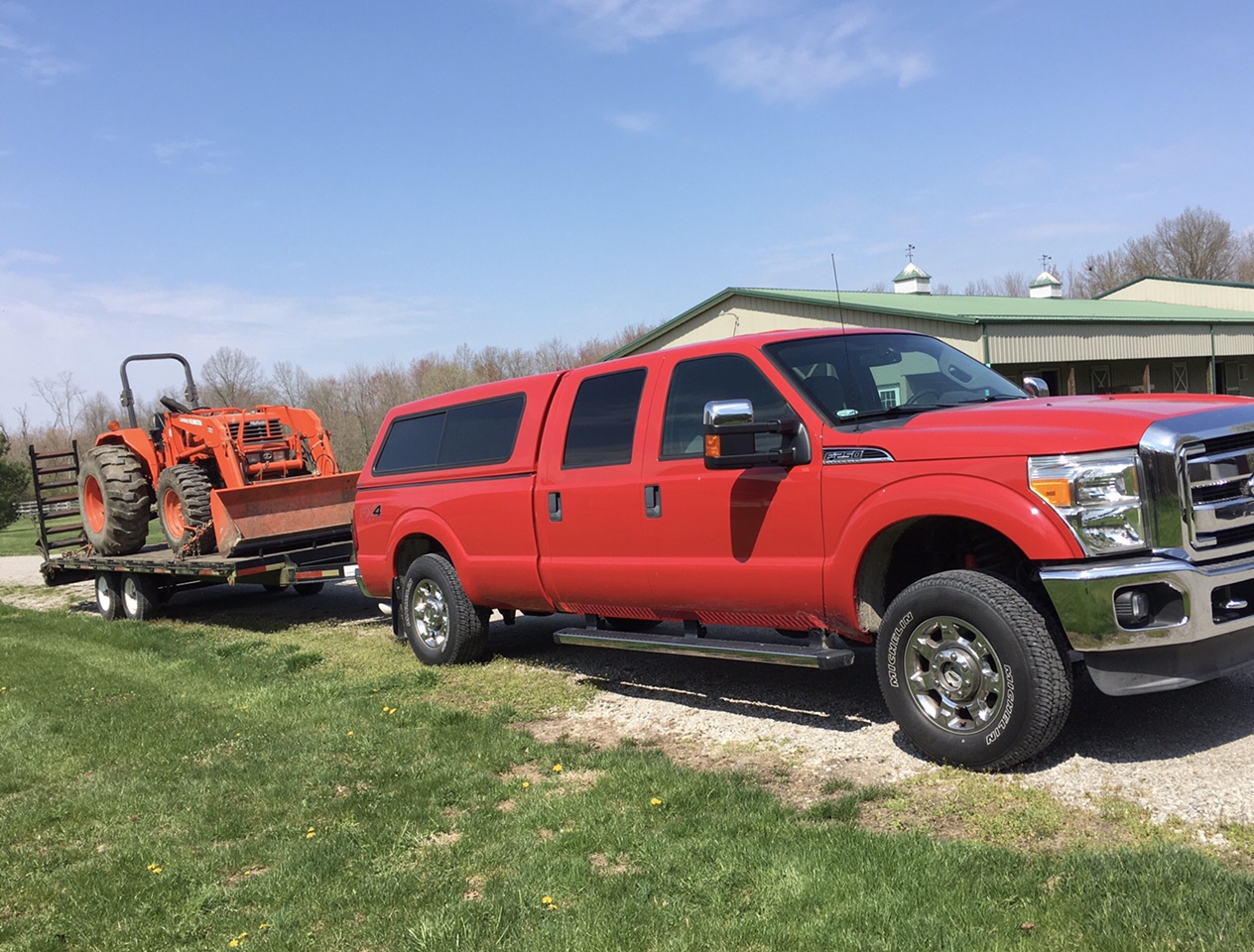

u can always add drive on fenders. i have a 18ft open car trailer with regular fenders.
   / Deckover vs standard equipment trailer #19

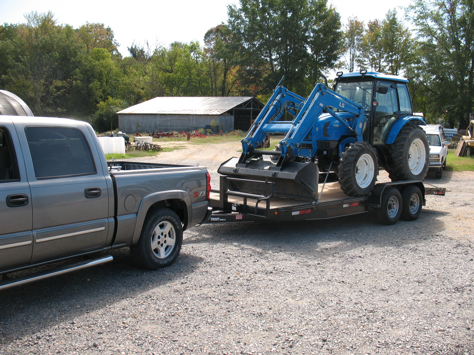

8 lug wheels, at least 10K, could easily be 12K.
I saw that, I was wanting to know what he said. That tractor has to be 8500 lbs and the trailer itself weighs 2500 lbs. The half ton is definitely overloaded.
   / Deckover vs standard equipment trailer #20
Could even be a 14k. Infact Id say either 14k or 12k. IF it was a 10k it would most likely only have 6-lug wheels.
That half ton doesnt look to be hurting too bad, so thats a pretty good load positioning. But certainly a workout towing
