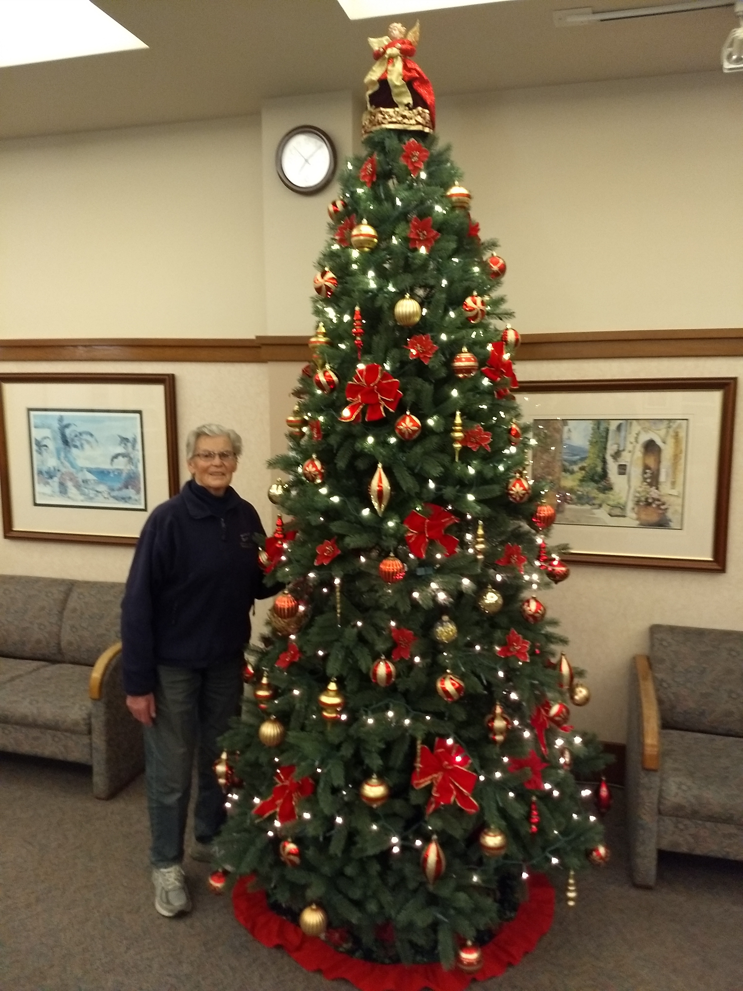

It’s a fight I can’t win… the corporate outside managers are giddy looking at samples and color pallets…
I did my due diligence today and it was noted.
To do the flooring conversion away from commercial nylon broad loom carpet requires sealing the on grade concrete due to the local high water table… the underground raceways will require additional floor prep and stripping the institutional commercial wall paper and wall prep for paint all factor…
The stained hardwood also requires prep for adhesion… plus the 12” base boards will ugly out from the housekeeping vacuum cleaners.
Then the idea to inlay Corp logo adds to the cost…
My standard question is what’s the budget?
I was told this is in part to boost employee morale but employees can go a year and never set foot in the lobby… so not sure?
Looked for a picture and the only one I could find is when mom wanted to see the tree I set up in 2023
I’m having a hard time picturing what’s to be gained with shades of green makeover.
No pictures of entry, reception or registration :-(

So your mom was still able to get around in 2023 to come see the tree. That's a good picture to have of her.

She always said as long as she could get around life is good… at 75 still running marathons and up to the last 6 months still walking miles in the hilly neighborhood where she lived.
She was also 50 years a RN fully intending to be a nun in the nursing order… dad said many times mom is the best thing that ever happened to him.
