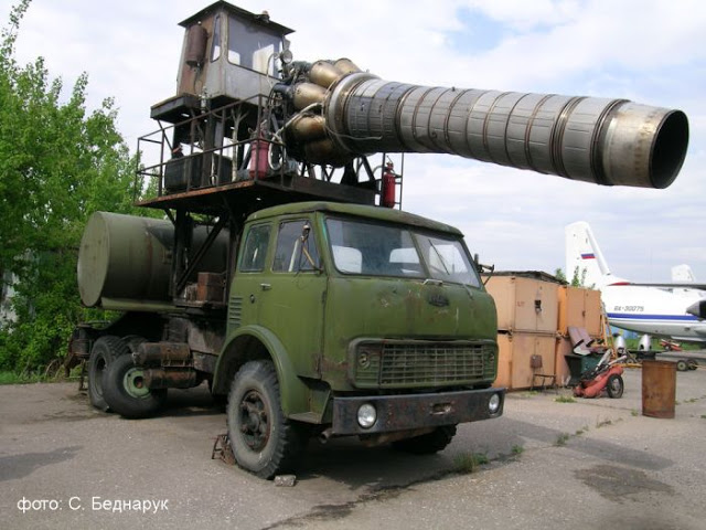

   / Deep snow techniques? #28
Now, that is very interesting! Based on the size of the fuel tank, costly to operate, even with today's diesel prices. Sure could intimidate other drivers.
