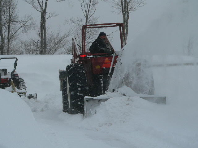

I used a 6' blower for the East Coast storm of 30-35". Fast and no snow banks to contend with. I got some large skids designed for a giant blower and bolted them on the outer plate keeping the blower 1/2" off the pavement. Ran the thing right over the grass to find driveway edges with zero turf or pavement damage.
Anyway... Since the topic is FELs, I cleaned up with the bucket and a clamp on "Ratchet Rake Snow Edge" that was awesome. Protects paved surface, used down pressure, float, and also can load and dump snow with it on. Very heavy duty, and a replacement 2.5" thick plastic edge is only like $65.00
