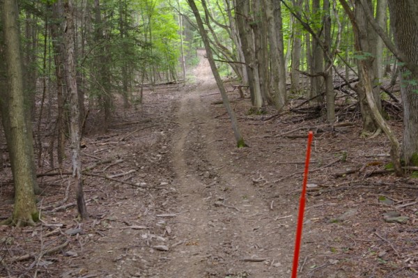

I was pushing some spruce trees over as the ground was soft and that was the only way to get back in the woods when it was mushy. Perfect tree pushing weather. When summer arrives and it warms and dries up I use my box scraper and level the ruts in a couple passes.

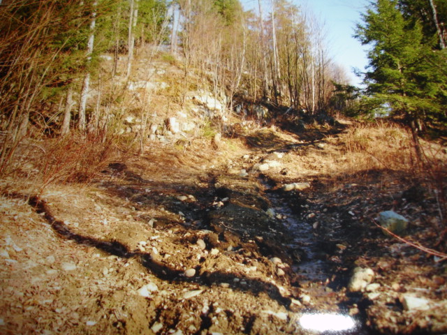

Yes, sadly, I am from Southern California, but grew up in Vermont & Connecticut...I miss the 4 seasons and the elbow room. Anyway, here's a pic of my land typical of the area...hilly, wet, rocky. I was thinking of placing some crushed rock in the ruts which are about 6-12" deep in some areas. Thinking stones 2-3" in size would work...don't know...may give it a try. Some of the locals I talked to said they did the same and no problems except having to occasionally dress them up as they wear down over the seasons.

The rocks will last for a while but will eventually sink back into the dirt. Depending on how long the bad spots are they sell a Membrane that goes under the gravel and prevents the gravel from sinking back into the dirt. I think a 15 foot wide by 400 ft roll is somewhere around $350 dollars. With the price of gravel if you have to buy it seems like a good thing to do to save money down the road. I'd box blade the area and get it halfway smooth then lay down the membrane and gravel in the trouble areas... :)

I put a lot of that matting down before I laid my driveway...it is worth every penny. I don't recall the exact price but I got 300 ft by 12ft rolls. THey had "good" and "best." I spent the extra few bucks on "best." I have muck soil (picture peat meets potting soil) over 13 feet deep and often standing water where I had to put a drive in. I have two layers of that "geo-textile" material with heavy broken concrete then normal driveway stone. I have had many trucks including cement trucks with 10 yards over my drive. I shakes but does not settle. I will never put in a drive without this material. I both stabilizes and prevents mixing of the dirt with your valuable stone. I also have seen no weeds...yet.

Once enough dirt settles down into the gravel weeds will sprout up.
