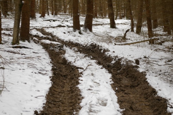

Sounds more like a job for a snowmobile. Hook a sled to the back with your gear and off you go. 30 inches is quite deep for a tractor. This was slick enough for me.

I leave ruts like that as well when it's the wet season. One of my problems is between my ruts are lots of stones of all sizes, so blading out the ruts is problematic. What do you do with your ruts? Blade them out or just keep em that way throughout the year? I was wondering if they could be filled with 2-3" crushed stone which would allow water to pass but hold up against further tractor damage? Any ideas?

My driveway is mostly flat and develops ruts, I originally filled them with smaller rounded stones and that worked very well since over time the stones tend to run flatter (shift so that there aren't potholes).
Then I hired a guy who apparently had only enough neurons to do the "same old same old" and he used item4. That was a bust, only got 3-4 years out of it. Soon I'll be going back to the small round stones. On hills angular material works better, have a few of those. The angular is more expensive, or it was several years ago, now I don't know but I'll know pretty soon-- the hills are slippery when the surface mud softens but the ground is frozen underneath. Stopping on a hill means backing up and trying again in 4WD vehicle, but R4s with diff lock hasn't been a problem...
Due to the snow, most people have more or less clear (ugly wide dirt) driveways so hired plowing is easier/cheaper. I prefer to have two wheel tracks through a field. The unexpected benefit of the ruts is keeping ricer roaches out... getting rid of the ruts might let them back in...:mad:
