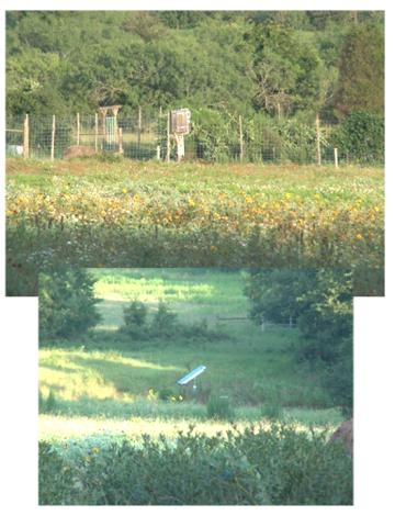

mrmotto, I got some of this deer fence from the farmer's Co-Op. It is 8' high. the picture shows the fence around my organic garden. In the center is my water storage tank which is supplied by my solar pump in a spring pond about 300' away- bottom picture. The water tank acts as a water distribution system. I have 3/4' PVC with small drilled holes and cut off valves for each raised bed. The solar panel is turned east so it get a controlled watering each day.
This was one experiment that actually worked. /forums/images/graemlins/cool.gif
