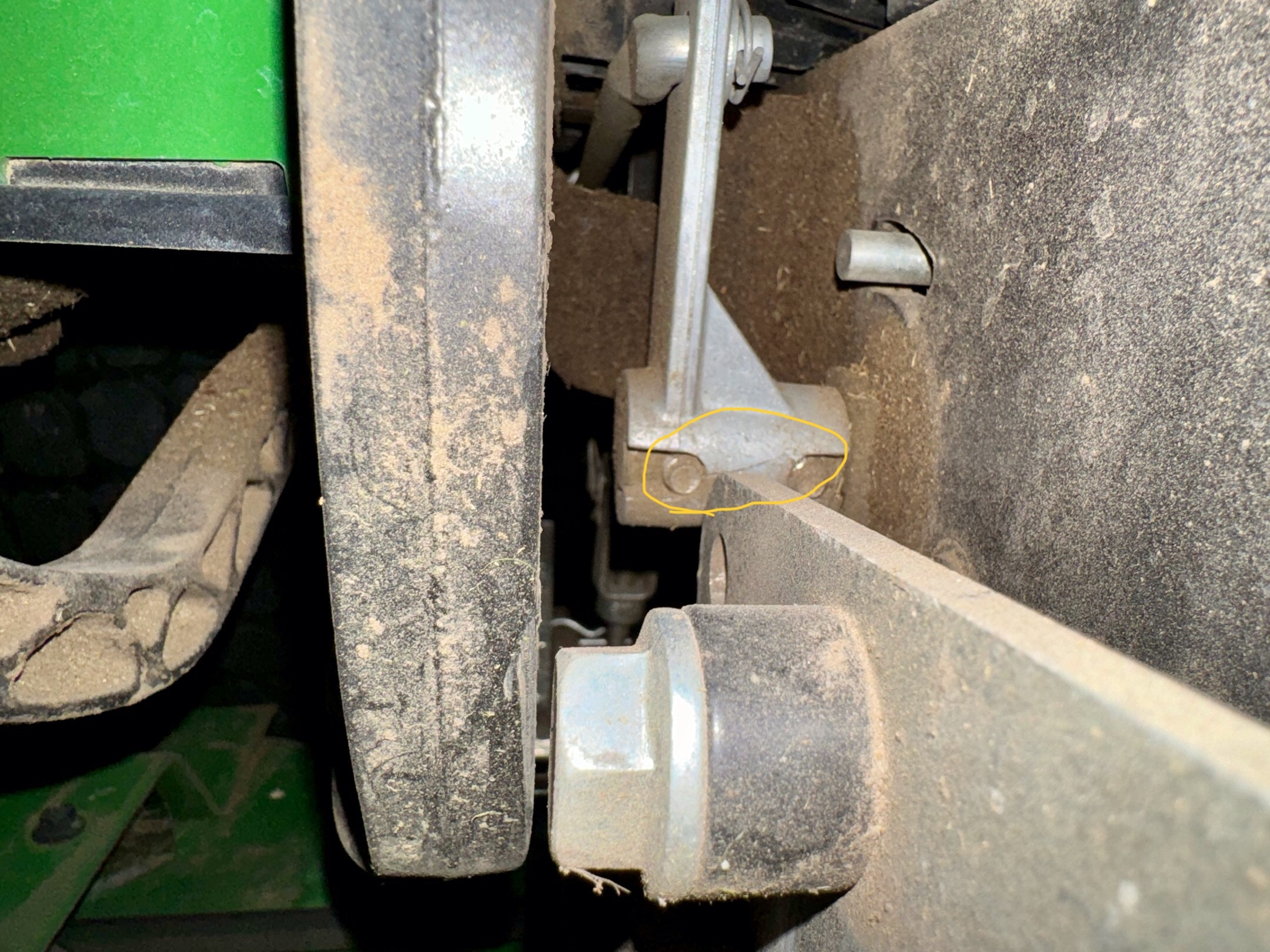

I went out and checked my JD 2025r and the bell crank that is the problem on mine is cracked so it’s really not safe to use. If it breaks, you end up with no brakes. I called the dealer and they knew less about the recall than I did. The recall letter lists a date of October 25 for when the improvement program will be released for mine. I took a pic of mine and circle the crack in yellow.

Edit: Part number LVU31387 (found it, thanks)
Most people using their tractors seldom use the brake pedal as the HST will stop the tractor, however it is a safety device in sometimes critical situations.

It looks to be LVU31387

Looks like an easy fix to replace that cracked piece.
It is easy to replace I’ve read, the problem is the new part would break again. The way I understand the recall will install a better part.
