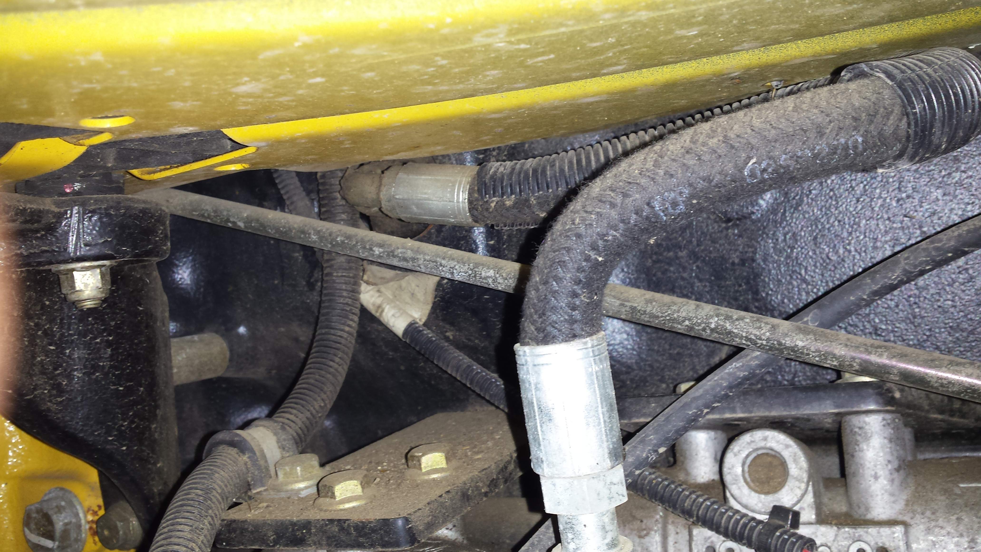

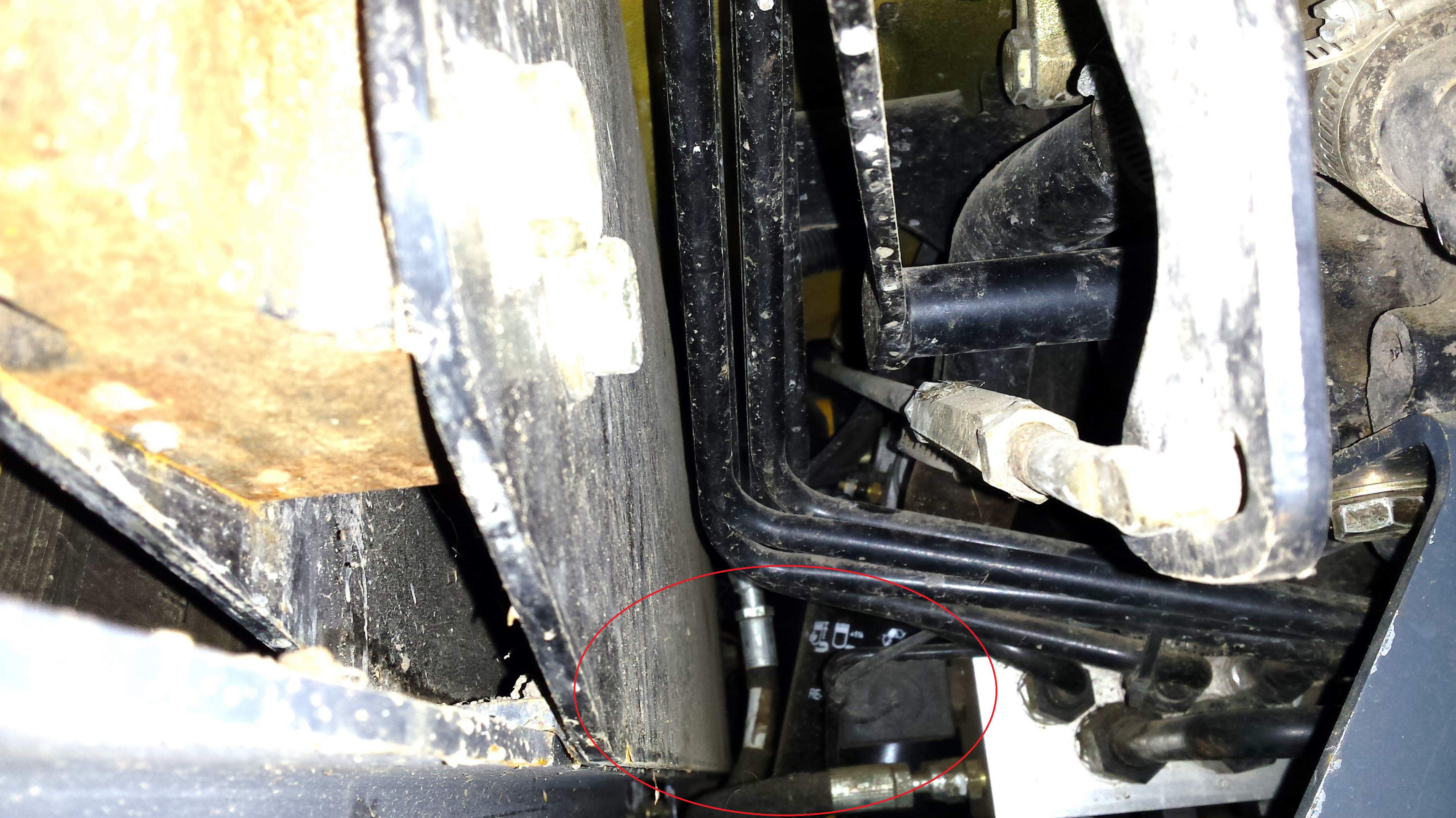

The hose I'm referring to in circled in red.
   / Deere 110 TLB Aux Hydraulics #12
more photos. It's hard to get a good photo with the skid plate on.

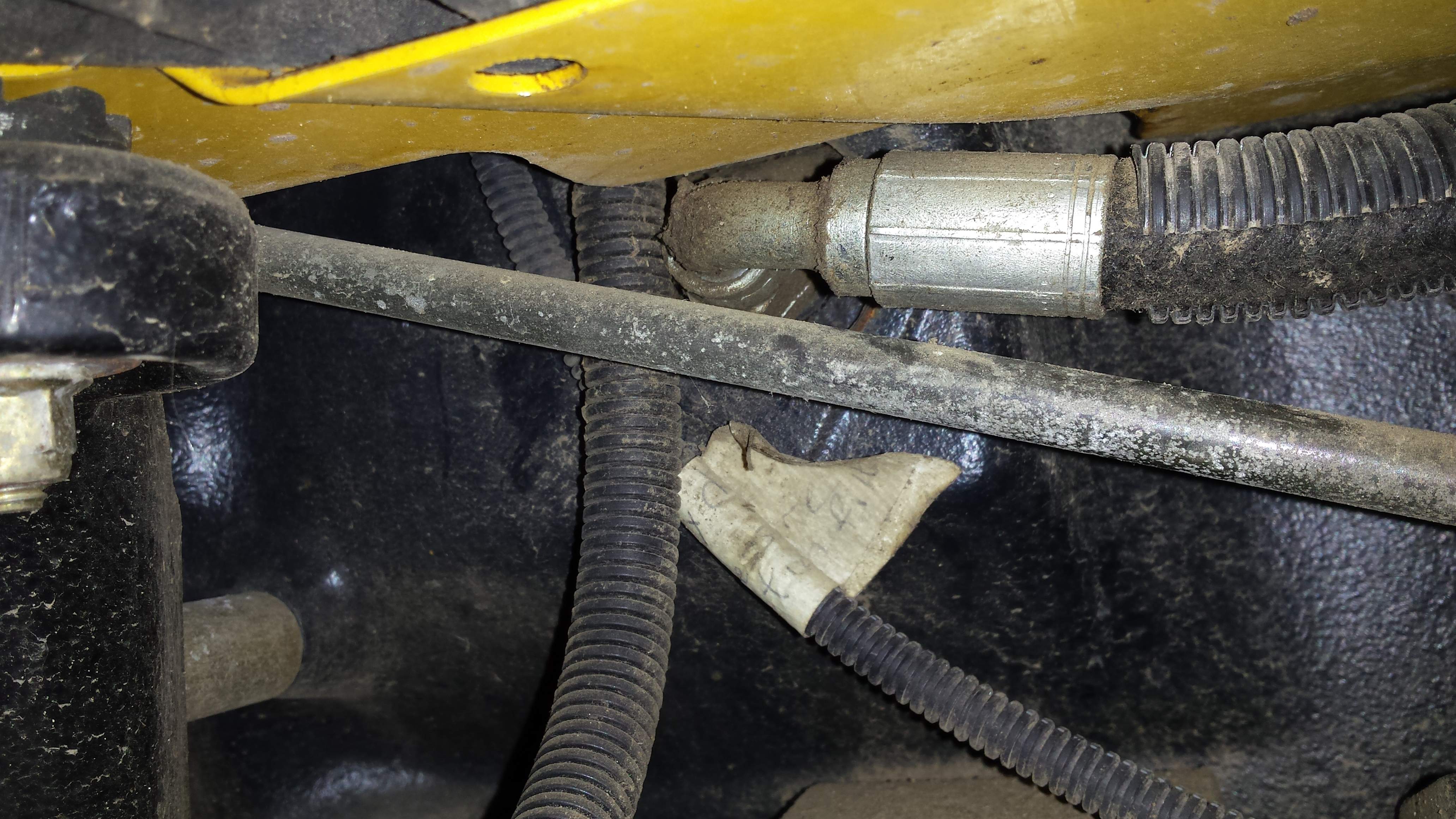

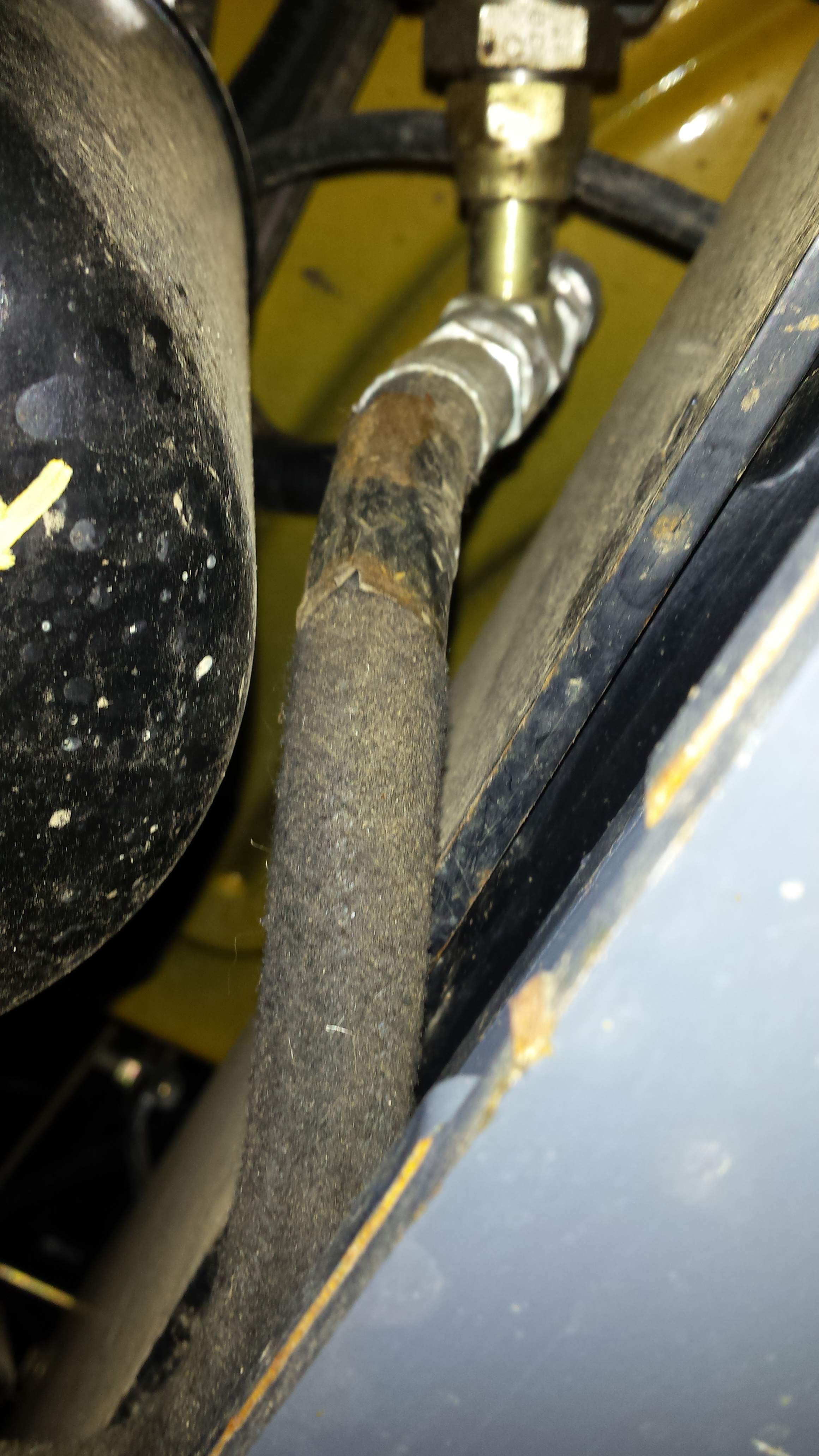

The hose goes up along side the oil filters and "T"s off into one of the Hyd filter head
And then goes up from there.
This photo is from behind the battery box. Left side of tractor
Ends here

Doc I really appreciate the help. I spoke with my dealer about the "factory only" moniker. He indicated that his understanding was that the aux hydraulic weren't available as a kit but there wasn't a specific reason (that he's aware of) it can't be installed in the field. I need to confirm that my filter housing has the ability to be tee'd into. I'm figuring it'll cost me about 3k going this route but I just wasn't happy with the fit & finish of the aftermarket options.
A fitrite setup would be almost 1k for just the valves, but I wanted to be able to remove the valve when the hoe is installed. Brian said it would likely be difficult to do.
Matt
   / Deere 110 TLB Aux Hydraulics #14
The T is in the line/hose not the filter housing.

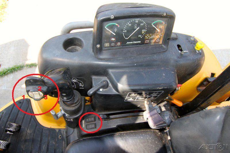

I,m not sure how your 110 is set up. You should also take into account the cost of aux electrical switches, if you don't have them.
#15
Mine is equipped with the switches so I'm set there. I'll take a look at the hose to see if it has a blocked port. Thanks
