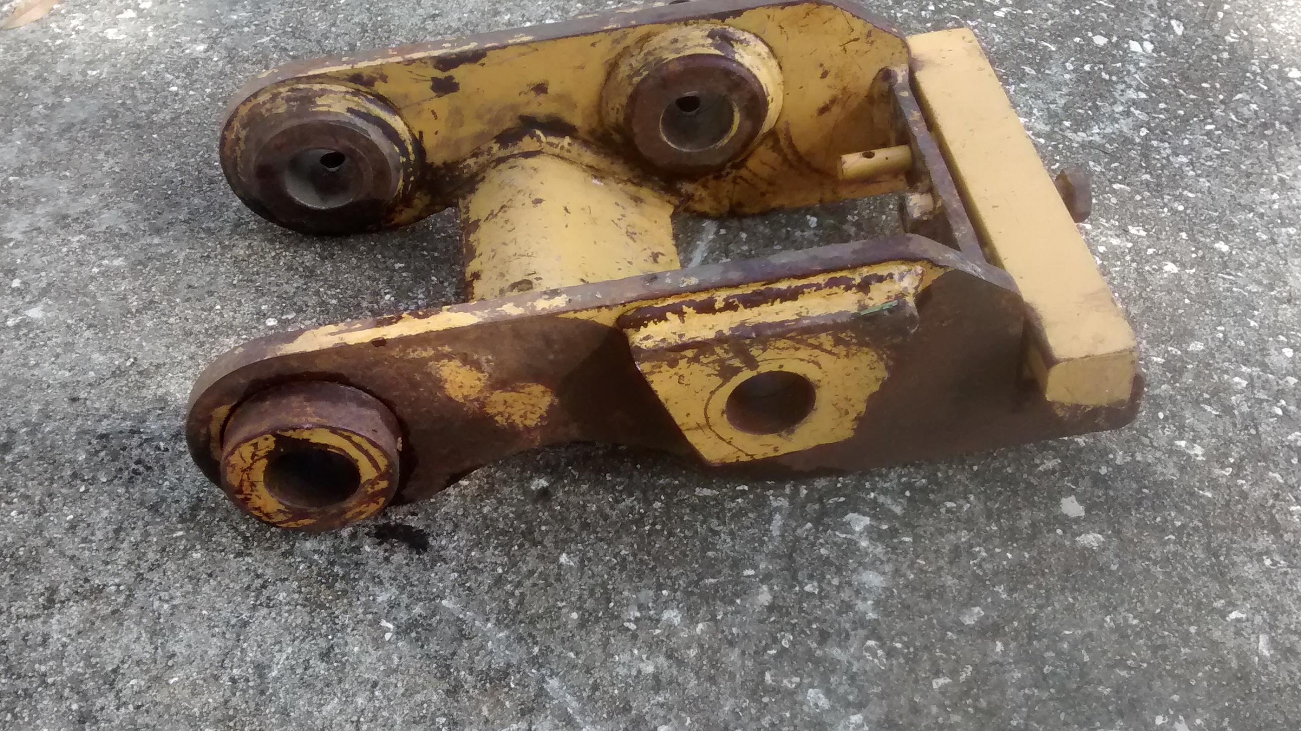

measured pin holes was getting approx. 1.385 to 1.390" which would be just a little over 35mm, or 1&3/8" distance between pins for pin on bucket and coupler not likely to be same. item weights approx. 40lbs before any packaging, and have no idea what shipping would be out of USA. any chance you plan on taking a vacation to mouse land anytime soon? Private message me if still interested, and we can talk $.

forgot to include pic

Hi again,
It seems there are a few different mechanical quick couplers out there. The JD parts diagram is not too clear when it comes to the 110 TLB.
I need this part to convert my pin on setup. View attachment 517370
I have heard that this quick coupler is the same for the 110 as it is for the 27x, 35x as well as Hitachi excavators. I am just hoping for a bit of reassurance that this is true.
Hunt Tractor has them, for the tune of $900....if anyone has a lead on a used one, please let me know.
Thanks again,
Dave
I will be sending your template in the mail this week.
The attachment plate above you pictured should be about $250 to $300 not $900. I would check elsewhere as the cost is way to high. Check for LVB24967 as a whole goods part from a dealer. There isn't that much too one of these and is easily built if necessary.

Yes that I what i figured. The local dealer wants $950 for that...I'll keep trying. Hunt Tractor is way out on that one, they came down to $800...
Thank you!
