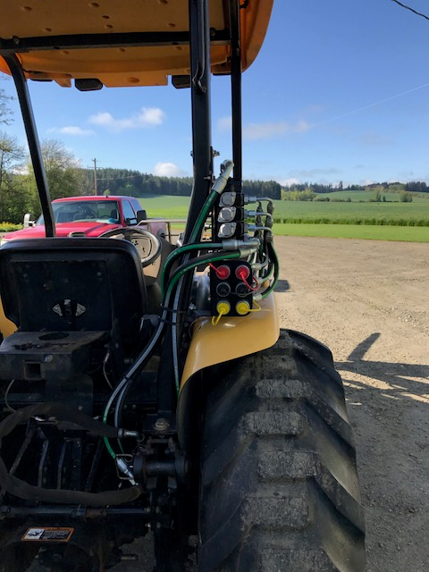

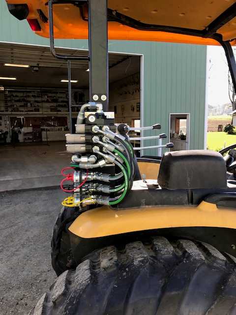

A couple of pictures that a customer sent me. If you look close, it does have the PTO.
Sorry no full pictures. :(
