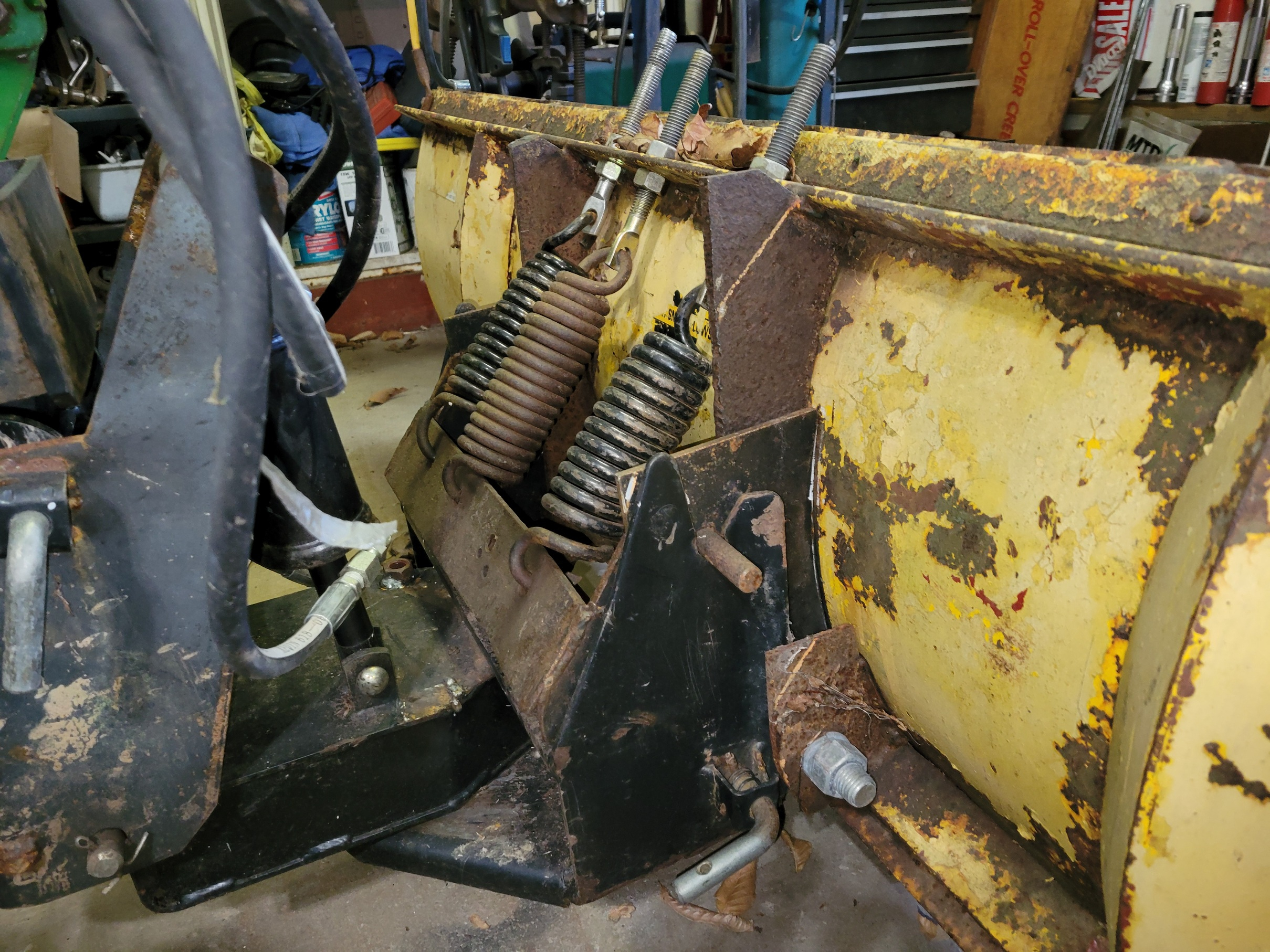

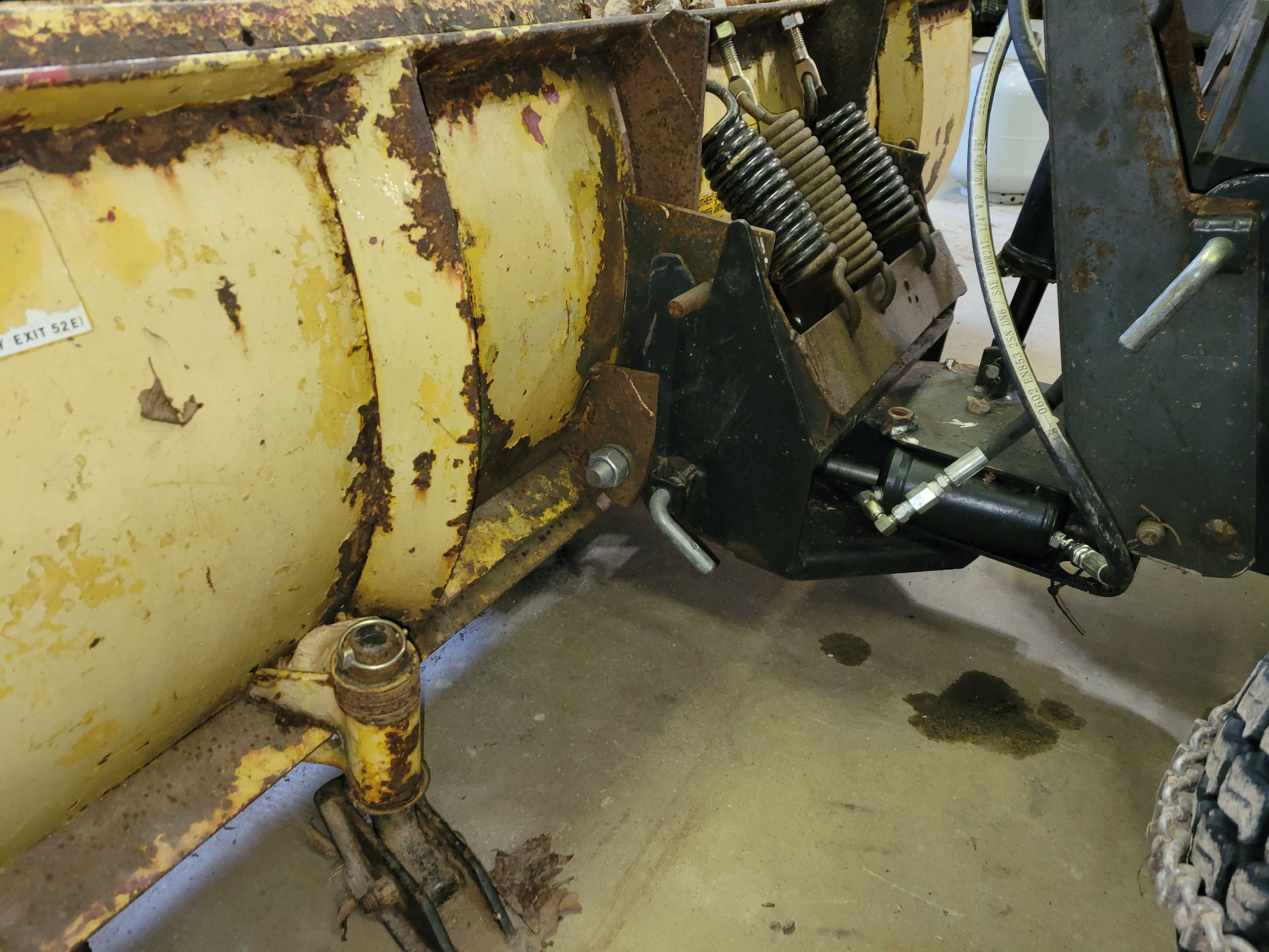

Cut the springs shorter and reposition them. Welded the skid shoes back on also

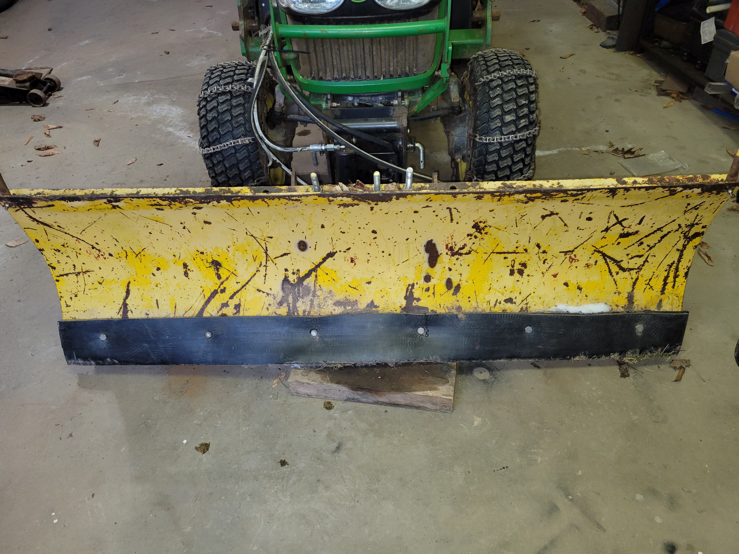

I bolted a 1/2" rubber mold board on it. Found this helps not tear up the yard, and doesn't catch or grab like the steel edge.

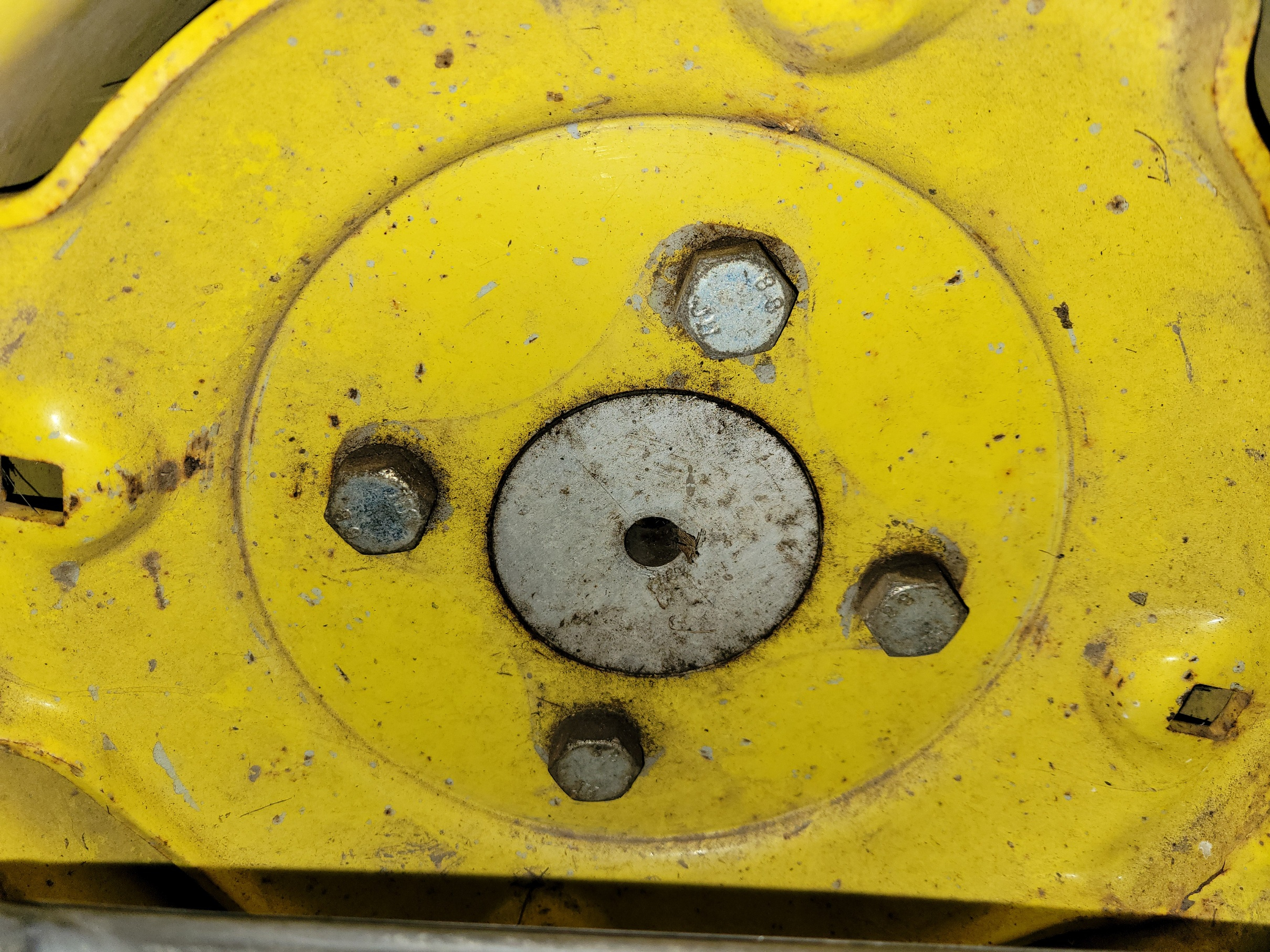

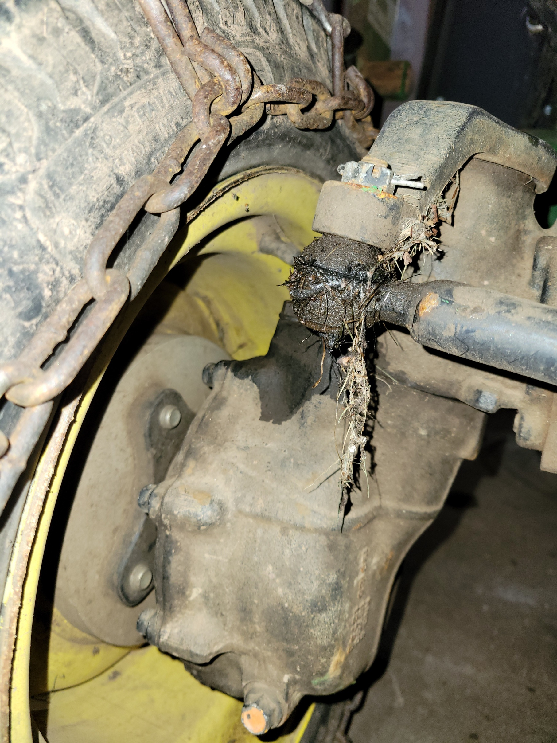

Last thing, I run chains on the front wheels. They would slap or rub on the steering knuckle. So I had 1" spacers made. Milled a shoulder on it to fit the rim and bolt holes drilled.
