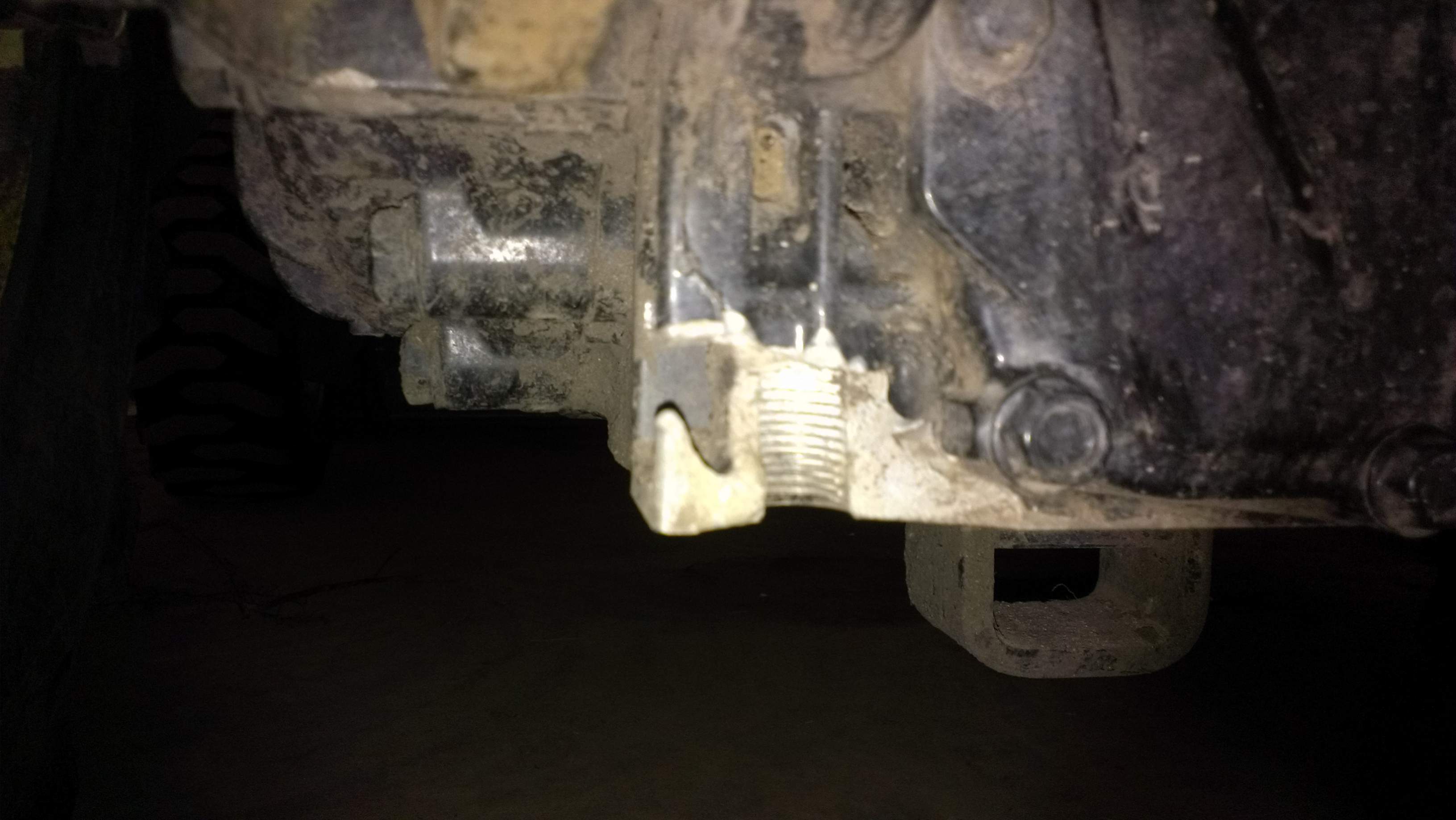

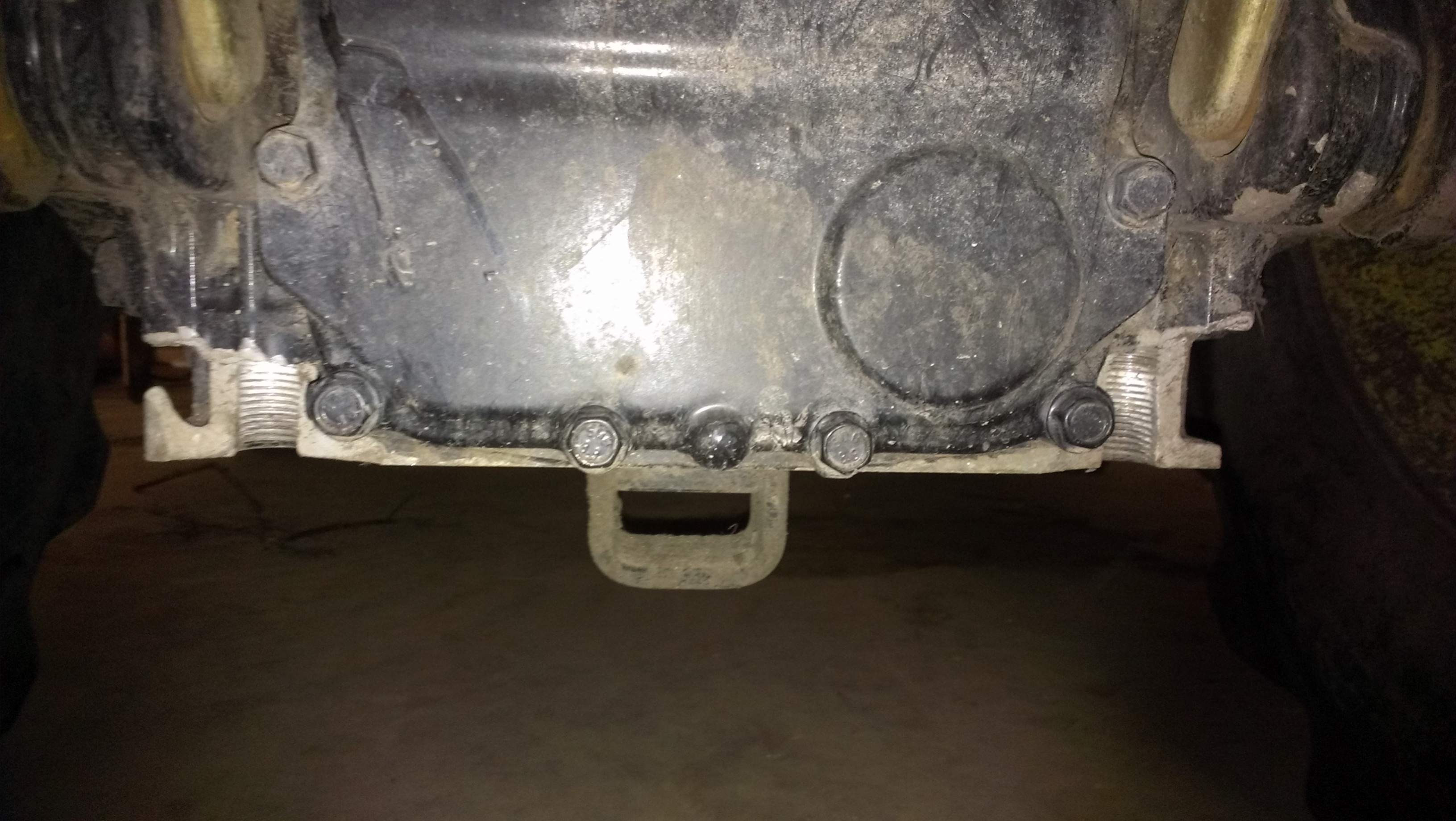

Hey guys... I just picked up a used '07 3120. Overall it seems like a good unit other than the fact that the received bar bracket mount is broke. The gal I bought it from put her husband in the nursing home and she knew nothing about the tractor which is why she unloaded. Anyway, everything else around it looked fine... no leaks, liquid up ect. But I wondering if anyone else has had this or seen it? Is it a weld job and move on to get that tow hitch back on? I'll attach pics shortly. Thanks!

I'm not trying to be a debbie downer, but that is a pretty large chunk out of the transmission housing / rear end missing.
It's aluminum too isn't it?
From what it looks like the bushings and whole part of the rear housing the draft links for the 3pt is missing too isn't it? Looks like something yanked the whole three point off, taking of course the drawbar mount with it there.
Ain't going to be easy if what I think I am seeing in your pictures is correct.

Ok scratch part of what I said. I see the three point is still intact now.
The bottom back edge of the trans housing is broke, I think it is aluminum isn't it?
Still not going to be easy, definitely don't want to replace the whole housing, way too pricey and labor too.
   / Deere 3120 (3320, 3520, 3720) Snapped trailer hitch tow bar bolt houseing - fix/weld? #4
I agree with Dusty, but if your 3 point lift arms are still attached, you can easily use a draw bar attached to the lift arms. Hope it works out for you!

Alrighty... I knew the 3 point was completely in tact but you had me nervous for a second as I'm sitting at work. :eek: It appears that just that portion snapped and yes I believe it's aluminum. My guess, is that I'll just get that receiver bracket welded on.

3 Point is completely in tact and seems unharmed guys... It functions perfect, no leaks, ect. It appears just those 2 mounting bolt holes were snapped. :( But I figured for the price I could live with that or fix it. It came with a box blade, rear blade and 3 pt snowblower so I tested it out well last night with those implements before and while loading up. I KNOW these decent "deals" can go south in a hurry... I think all is OK, just curious if anyone else has seem or fixed similar before I make a plan. Thanks for the quick replies... MUCH appreciate. :)
