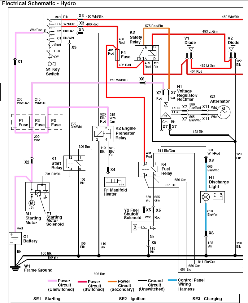

Update. So far after tracing down all the wires going to the control mod, I ran across 3 wires all hooked together. This was totally wrong per the print. I then looked at a print for a Geared tractor as mine is Hydro stat and found 3 wires hooked together on that print. So basically I must have part of a 4115 Geared wire harness. The print doesn't even show a PTO switch or a rear pto solenoid for the geared tractor so im not sure how you activate and deactivate the pto? Looks like I will be tracing down more wire tonight.

Well I hooked up the new module with 2 fuses like I mentioned above. I also change the 2 wires around like the print shows for the HYDRO as it was hooked up like the GEAR print Tried to start it and it cranks but no gas. So right away I looked at the 2 wires I changed. If I put the rear PTO lever in rear only, Then it is basically wired like the GEAR print and V3 is getting 12V. Presto, The tractor starts. This is all so wrong!!!! I went to Deere parts site to see if they listed 2 different Control Modules. One for Geared and one for Hydro. When you look up 4115, There is no mention of Geared or Hydro so that was no help. Is there a number where you can talk to a Deere specialist?? The dealer is not what I need and they are limited on support. At least in my area. The print I have is from CD1 version 7 Commercial and Utility Vehicle Products. DB1481- FEB 05.

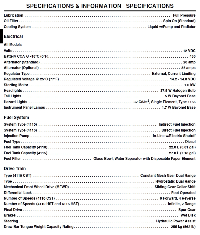

Good to know. Not sure why they have over 50 pages in the service CD for a geared one and a different print?
   / Deere 4115 Fried Control Module Part M807913 #13
All those gear (CST) pages are only for the 4110. The hydro (HST) pages are for both the 4110 and 4115. The Deere advertising for those models also show the 4115 is hydro only.

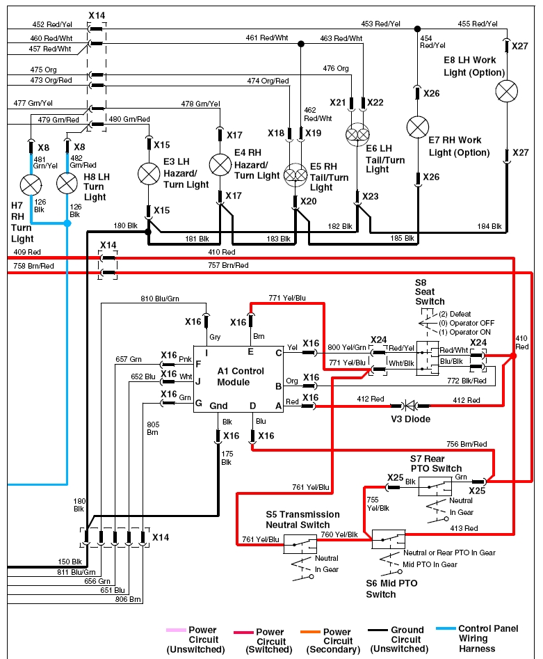

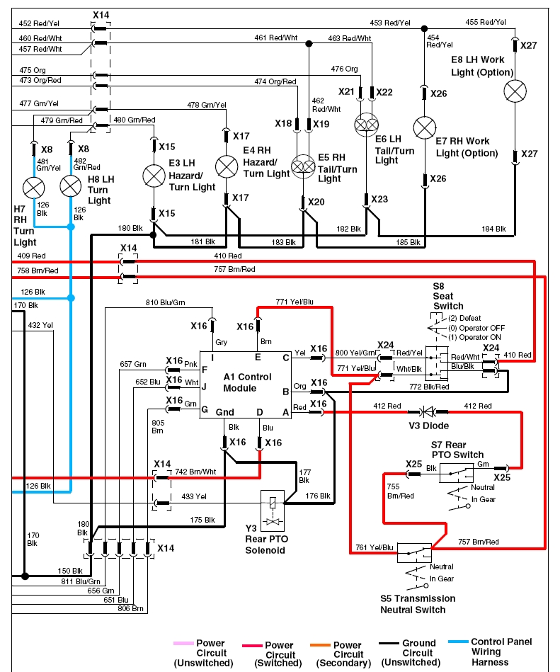

JD755 (If you have time, look at your print and see if it matches my typo below. THANKS
If you look at the print for the 4115 Hydro,
You will see that the A1 Control Module POINT A comes out to X16, 412 Red, V3 Diode, X25, S7 Rear PTO Switch, X25 755 Brn/Red, Connection point at S5 Transmission Neural Switch 757 Brn/Red, X14, 758 Brn/Red, K7 PTO Light Relay and SO ON.
Well after tracing down my wires this is how mine is hooked up. POINT A comes out to X16, 412 Red, V3 Diode, 757 Brn/Red, X14, 758 Brn/Red, K7 PTO Light Relay and SO ON. So the S7 Switch isnt even part of the diodes circuit like the print shows.
SO the Diode has power going through it as soon as the key is turned and S9 PTO switch is OFF and K7 PTO Light Relay is OFF.
ALSO S7Rear PTO Switch also goes to 757 Brn/Red, X14, 758 Brn/Red, K7 PTO Light Relay and SO ON.
SO I decided to make it like the print and cut S7 Rear PTO Switch and V3 Diode from 757 Brn/Red and series them like the print shows. Well it wont work this way but the print shows it this way??????????????????? Well it did work if I put the S7 Rear PTO Switch in Rear PTO Only. Thats because in this position the switch is closed like the print shows. I started up the tractor and then put S7 in Rear/Mid PTO position and the tractor died
Is there a different print??
If you look in the section about the A1 Control Module on the CD, it states Point A should have power going to it when the key in in the run position. So that statement doesn't even match up with what the print shows. Further more if you look at the geared print you will see how they tie these 2 point together along with a third point I didn't mention, the seat switch. This is how mine is wired.
One more note is 176 Blk. It runs from A1 Module B to X16 and then down to Y3 Rear PTO Solenoid. This cant be and I checked mine and its not like this but that would be a direct SHORT if S8 Seat pull up switch was made and the other conditions where met.
I think I have a print issue or their is a mis print?????
I hooked it back up the way it was and called my dealer seeing if they can take my serial number and match a print to it.

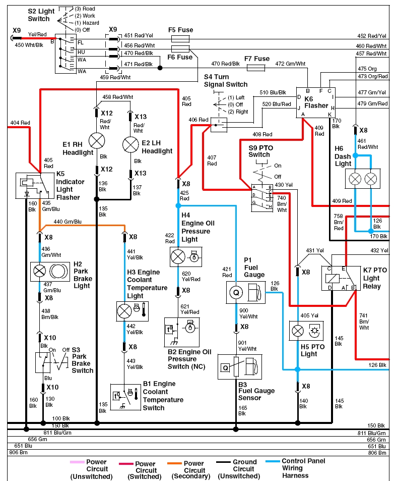

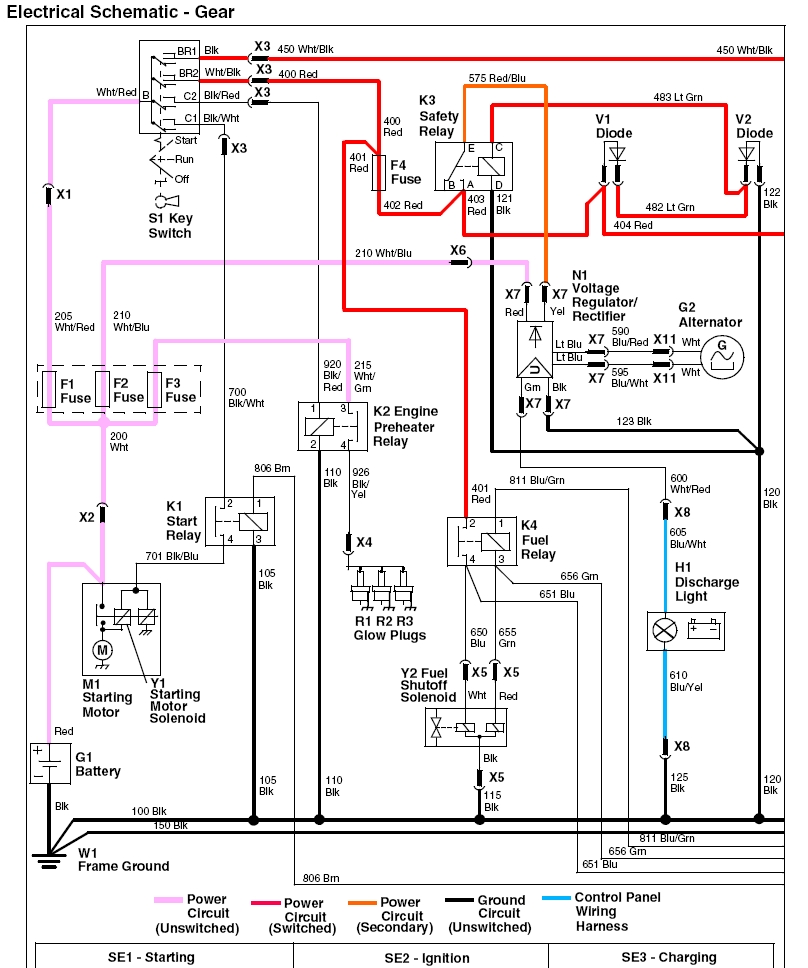

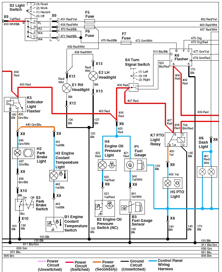

I'll look at it some more, but what I traced so far looks the same. Then I thought I would send you mine. Gear is attached here. Hydro on the next post to keep them separate and in sequence.
   / Deere 4115 Fried Control Module Part M807913 #20
Hydro.
