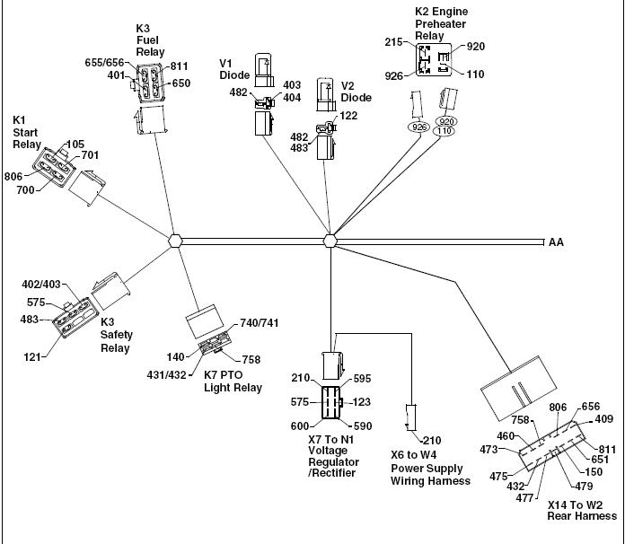

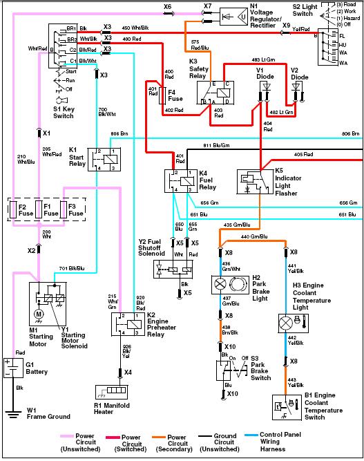

Yes and Yes. This is what I have but did you notice how they show the Hydro wired?? THis wont work as the A1 Module needs voltage to point A or the fuel will shut off. Im going to swap out the pto relay with k3 safety relay tonight if i dont work over and see if my regulator starts working. I wont get the new relays till Thursday. Still cant believe Deere sells them for over $80 when I found the same thing for $5

Finally got to the tractor again tonight. Checked out V1 and V2 diodes. A OK. Put regulator back in and swapped out the pto Light Relay with the K3 Safety relay as they are the same type. Dont need the PTO right now. Started up the tractor and turned on the lights and at first only had 12.5V. Which was good considering before I had 12.2V and it was dropping. After a minuted the voltage topped out at 14.5 at 2800 RPM. So all is well and I should have my new $5 relay tomorrow. Better than $80 Deere wanted. All this just in time as we have snow flying will get around 7" tomorrow.
Ive been trying to call Deere about the schematic error for the Hydo. My dealer doesn't seem to care but it activates me. Ill post again after I hear from them.
