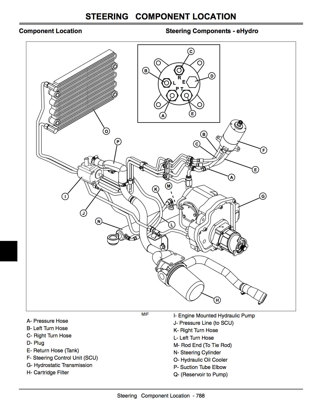

The front hydraulic pump supplies hydraulic pressure to
the steering control unit (SCU). The SCU utilizes an
open center control valve to operate the steering
cylinder. When the steering wheel is turned, the SCU
directs hydraulic pressure to the appropriate steering
cylinder hose, pushing the steering cylinder ram, which
pivots the front spindles and wheels. The SCU has no
relief valve. The SCU and steering cylinder are not
rebuildable, and must be replaced as complete units.
This from the tech manual for the 4300, under "theory of operation". Note the comment about "no relief valve".
I'd suggest getting the tech manual if you are going to pursue this further. Along with a pressure gauge so you can find the different lines and check them out one by one.

I just checked on my tech manual and they stated it could be an internal leak on the steering cylinder or on the Steering control unit. This is for a 4310 so I do not know if it is the same layout or not. It almost sounds like it could possibly have air in the cylinder but after turning side to side several times it should have bled any in the system out
I don't know if this layout is the same as yours but hopefully it can provide you some assistance.
Thank you a ton, Yes the tractors are the same but for the E hydro is via servo.
I think ill double check my front ram and then only thing left is the steering motor at 670.00 GEEZ

My 4310 ehydro manual shows a relief valve set at 1500psi that can bypass the power steering valve.
