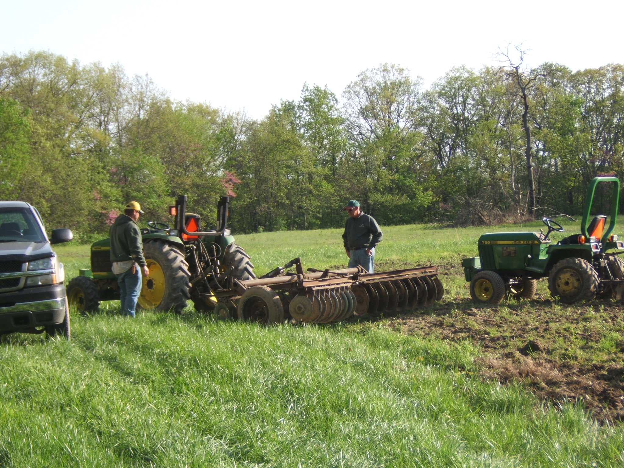

I have pulled a 10 ft wheel disk and a 10 ft field cultivator with a 4700 and it handled it fine. I would think it would handle your planter you are talking about. I am planning on buying a 4 row in the future and using it behind the 4700. I attached a pic of the disk and tractor
