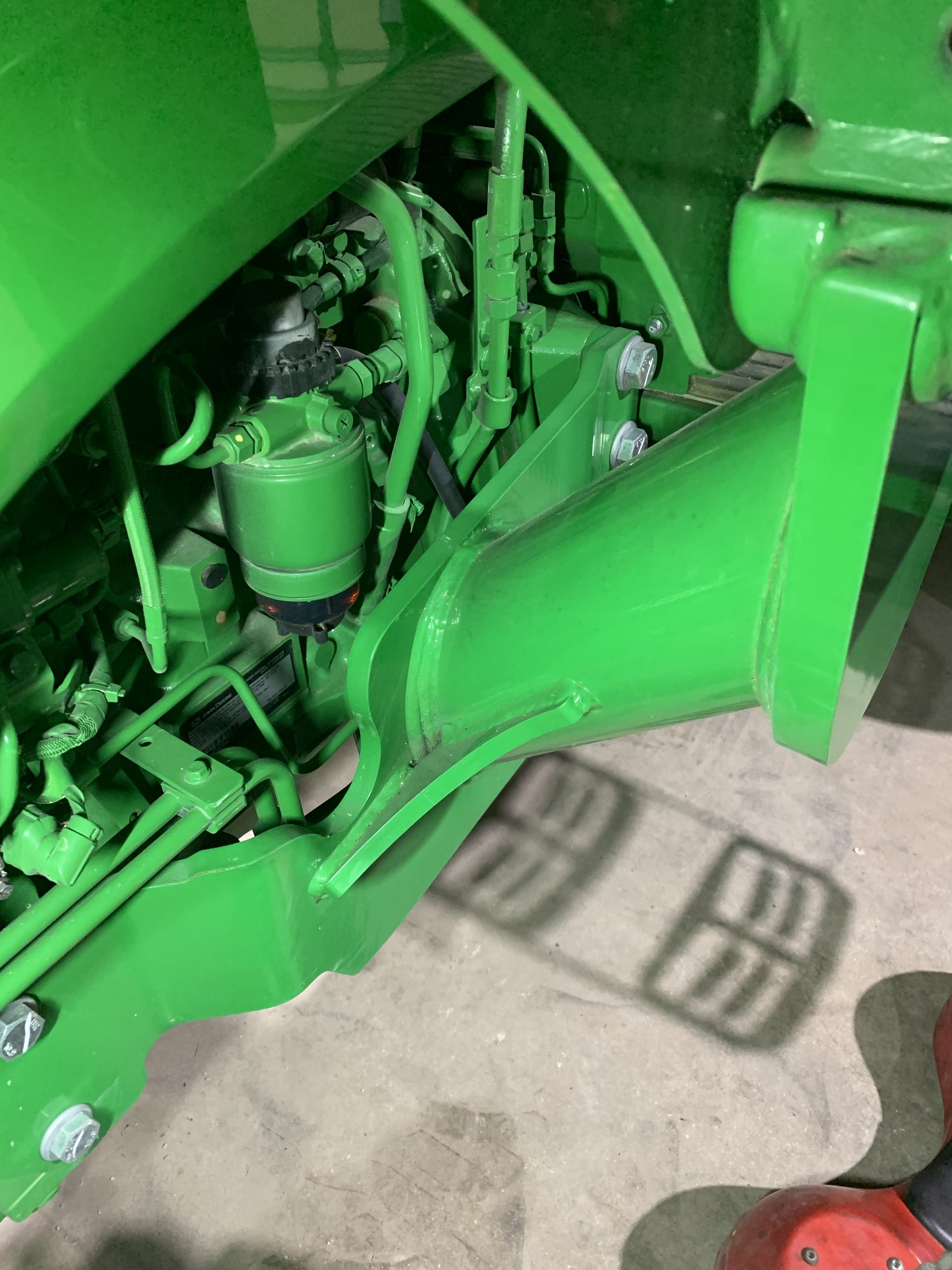

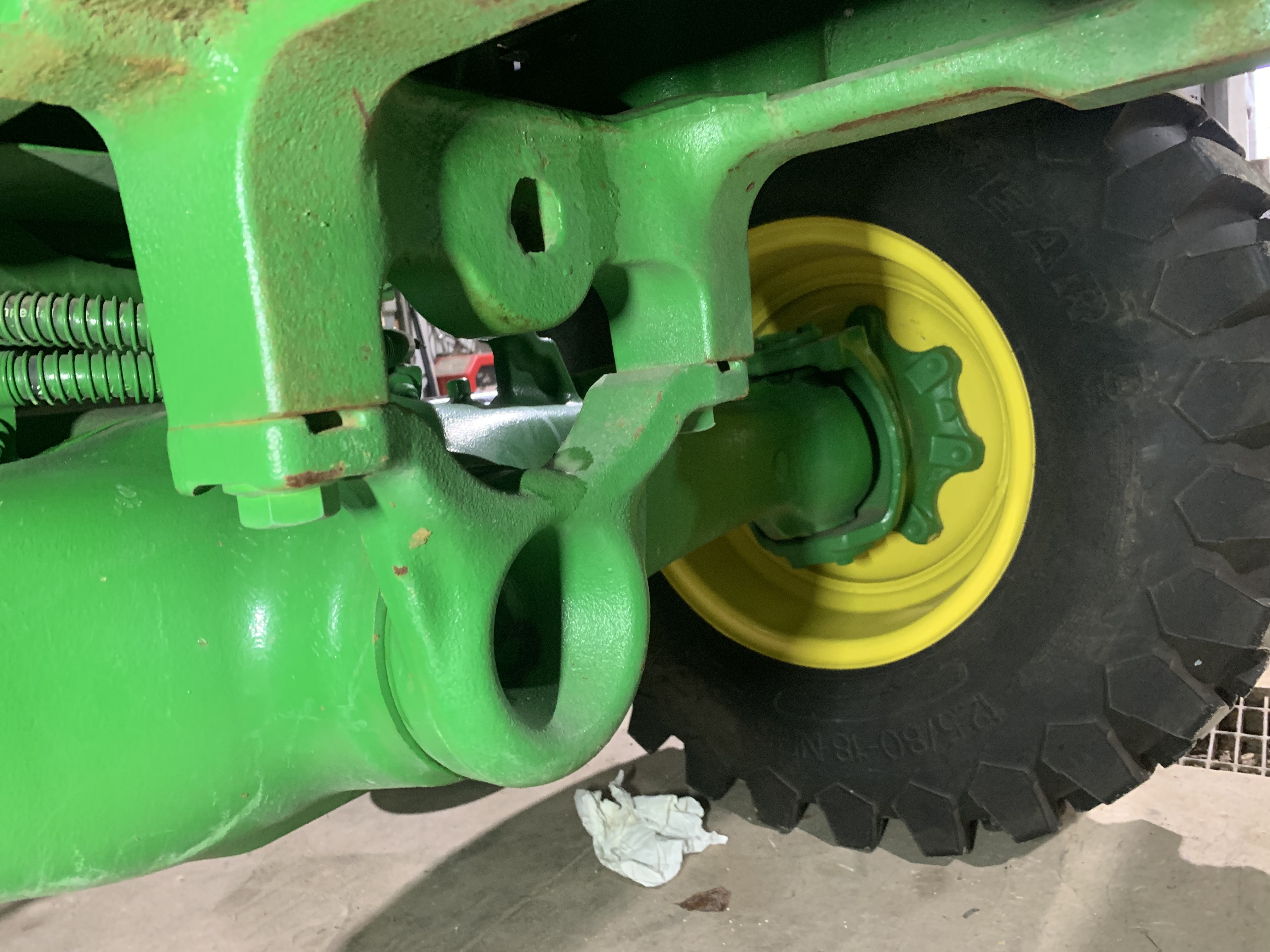

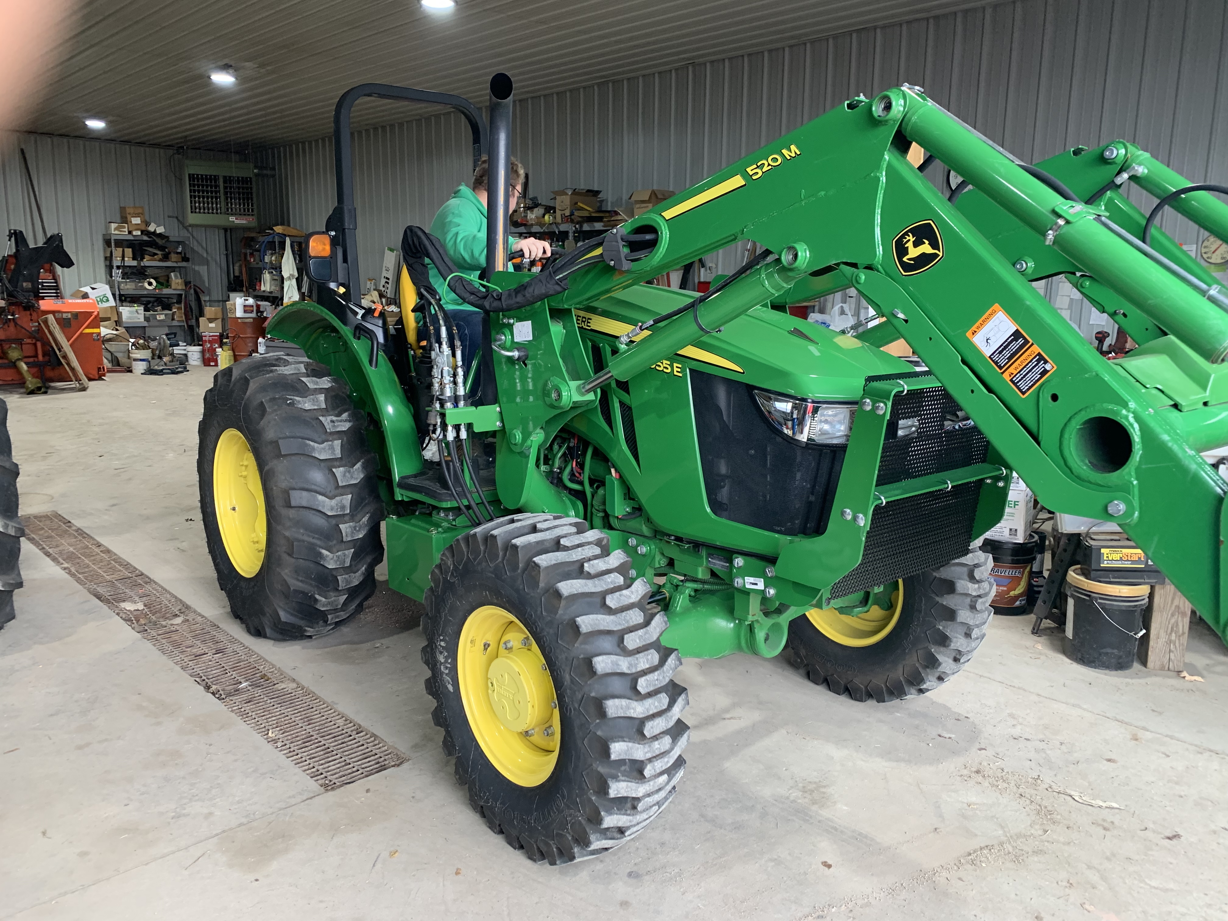

I really think that 520m loader will not have any issues with a 5x6 bale , It’s substantially heavier duty than what you’ve got. Loader and standard bucket weight is listed at 906kg or about 2000lbs, very stout for size . The tractor also is built heavier especially the front axle with planetary out drives , in my opinion much better for the long haul when lots of heavy loader use is required. Also notice how the JD loaders make use of gussets and reinforcement plates at high stress points, cast pivots at back end of loader arms 💪. For a farm tractor loader in that size pretty hard to beat.

The loader does seem well built and specs are higher than the basic one from Kubota. The m series is about the same and it's an alo/quicke loader so it's built stronger as well.
I've been wondering about the axle differences between the straight axle on the Deere and bevel on the Kubota. Thanks for your feedback. I think the main drawback is lost ground clearance on the Deere.
