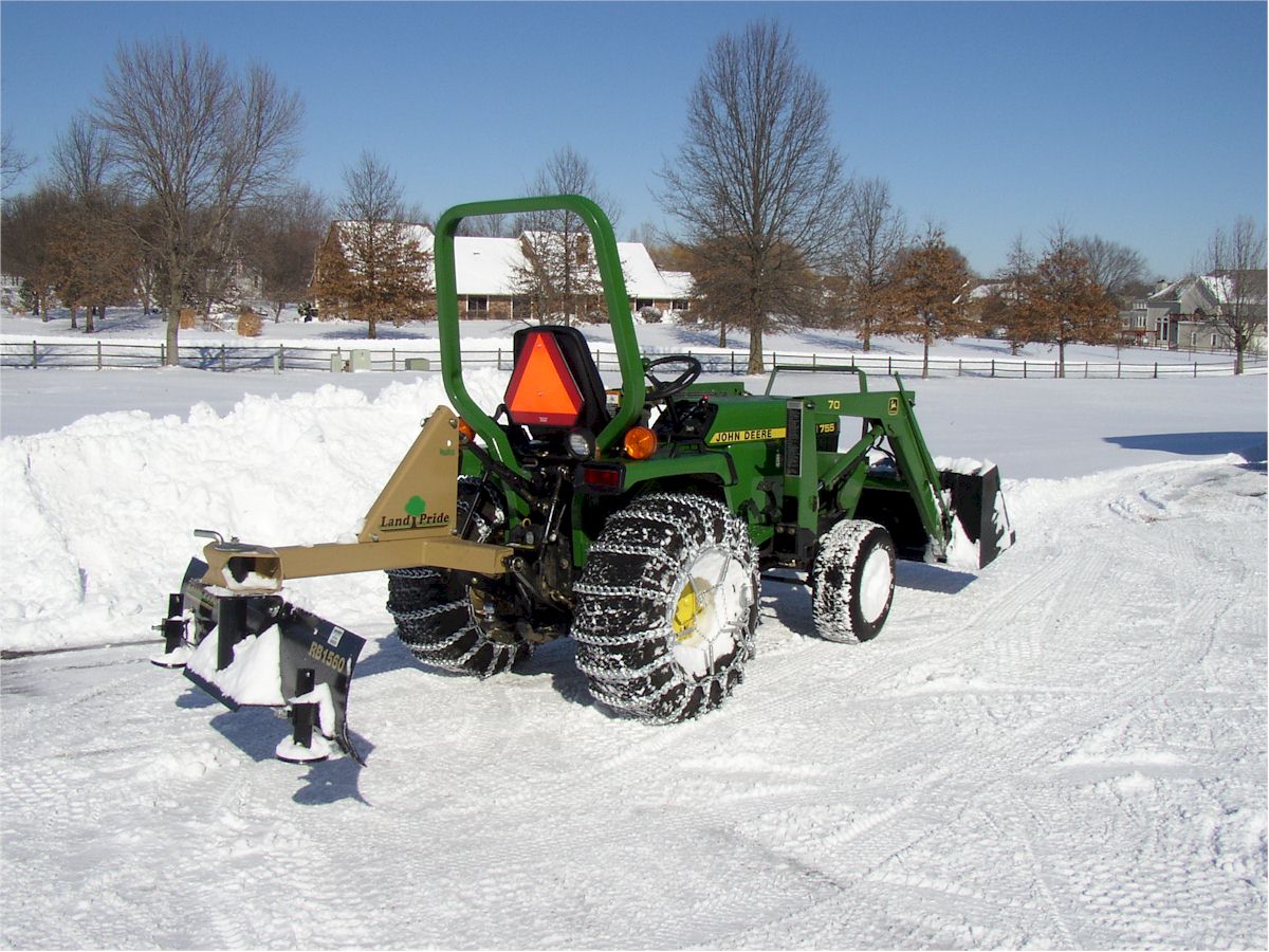

I had a 380 front blade but sold it because the hassle of changing brackets, like Mechanos mentioned, was a real PITA. A simple rear blade is what I use now. I used that in reverse mode until I got tired of twisting my back. So I added chains and now drive forward with the front bucket set to just knock down the really tall stuff while the rear blade grades everything to the side.
You may decide later you want a blower, but a rear blade is something you can buy anywhere for cheap and has other uses. My blade has skidshoes which work well on my 300 foot concrete drive.

Removing the loader is nice when you're mowing (if you expect to mow with the 855) or other tasks where the loader isn't required. The rear blade is also usable for other tasks...grading, etc.
Just don't like that blade dig into your drive.

As far as pulling or pushing, I've done both. There have been threads on guys damaging their lower link arms when pushing. The 3PH is designed for pulling...and a rear blade has no trip springs to absorb some of the impact when you hit something.
Most recently (before I sold the blade), I was pulling forward for the most part...works fine.
I'd suggest getting chains for the rear tires. Less stress on the MFWD...you might even not need MFWD with chains ( use MFWD less with chains....frequently, not at all). I use 4 link ladder type on turfs, but they are bumpier riding then 2 link ladder types.
You can add hydraulic angle to a rear blade. Others on TBN have done it...but I'd try a season or two before I spent money on that. You may find out you don't need to angle the blade much.

I went a great number of years with this tractor never using chains. The key was never to drive through where I had not already plowed. With the front blade that was no problem. Same with using the rear blade while driving in reverse. When I decided to use the rear blade while in forward motion I knew I needed chains. They are necessary for that mode and have really done well for me.
When I had the front blade the hydraulic control was nice. When I went to the rear blade I thought I would really miss that. Turns out you just develop a plow pattern where you never need to adjust the blade from one setting. At the most you may need to change the direction one time while plowing. All just a matter of thinking ahead and developing a routine.
You will find many threads here about using chains on the front tires. General opinion seems to be they can provide too much of the wrong kind of load on the front gears and cause damage. Also, concerns about using a rear blade in the reverse push mode may damage the three point which is designed to pull instead of push. I used reverse for many years but was always very careful about it.
I do use the bucket for for cleanup in some areas and find it makes a nice combination with the rear blade.

- no skid shoes?!? i could weld on a set, but guessing there's a reason non are provided.
I do like how a rear blade can be used in combo with the loader, but do worry it might tear up my driveway, unless I add some skid shoes.

Some rear blades have Skid Shoes as options. I think the Land Pride JD755 has are the optional skid shoes. The concave side of a rear blade can dig in (that's what they're designed for). Skid shoes, adding a non-metallic edge, adding a rounded edge (split pipe) are all things TBNers have done to prevent digging in.
