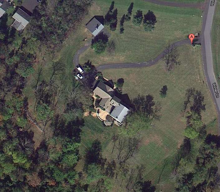

Hmm... had thought about a 3-point blower, but chose against it for a few reasons. Maybe I should reconsider. The reasons I had considered the rear blade over the rear blower are:
1. Cost. We do occasionally get a 24" - 36" storm, but most storms are only 4" - 6". More often than not, the snow from one storm melts before the next, although there are some exceptional winters that come to mind.
2. I can drive forward with a rear blade. Just chain up, and drag the blade behind me.
3. My driveway is a big "U". Essentially, 300' in to the house with a parking area, and then double back 150' to my shop with another parking area. I figured I'd have to be pretty selective in where I blow the snow, whereas a plow just sort of puts it next to the driveway.
4. I don't have a cab. Most folks I see using blowers insist on having a cab to stay clean.
5. I figured I'd be more nimble around vehicles and such with the blade, but maybe the FEL eliminates that factor.
6. I figured a blade could scrape the drive clean, especially with a rubber scrape edge attached. My experience with blowers is that they always leave something behind.
7. Storage space. I'd want to store that big expensive blower indoors. I don't mind leaving a $500 rear blade sit outdoors.
That said, please tell me where I'm wrong! I haven't made any purchase, yet.

Addressing your comments in order.
1 Cost - A good used 60" blower would run $1000-$1500 around here and new ones $2000 to $2500 and up. A new blade will run $600-800 and a used one $500. I have both.
2 Drive Forwards. Yes - you can drive forwards with the blade. You will have to drive through the snow to do so and that can cause issues with traction depending on depth.
3 Driveway shape. If you can plow it there, you can blow it there. You can blow it places you can't plow it to. That said - you don't want to blow it towards your windows and you only blow downwind!! But with the blower you can start on the upwind side and blow it across and over the drive to the downwind side, clearing the other side on the way back. Trying to plow all the snow to one side is a major pain.
4 Cab - Wear a toque, don't blow upwind and check your chute before engaging. Other than that - it's no colder with the blower than the blade.
5 The blower is actually better in tight quarters. You're looking at it and where you're going at the same time and it doesn't try to pull you sideways into your wife's car door.
6 Both the blower and the blade have the same cutting edge technology. Depending on the way you set it up you can scrape right to the surface or leave a small amount behind. I leave 1/4" to 1/2" on purpose to form a hard packed layer of snow over top of the gravel - I scrape the neighbours paved driveway clean.
7 Storage Space. My blower is the same width and depth as my blade, but it is taller with the chute. Both of mine live outdoors.
Maintenance - The blower needs a shot of grease on the chute and bearings and lube on the chain every month during winter, and I check the gearbox oil every fall. It eats 3-4 grade 3 bolts a year (shear pins) when I catch something I shouldn't. The blade gets greased once a year too.
Fuel - I use twice as much fuel blowing as using the loader (or a blade) but I get done twice as fast.
Traction - I DON'T have chains for my tractor. I have turfs on the rear and R4s on the front. Traction is not an issue on my slightly sloped drive.
I know everyone has their own needs and preferences. Not trying to convince you either way - just want to make sure you have as much info as possible. In 15 years I've plowed snow once with the rear blade, 25+ times with the loader alone, and the rest of the time I use the blower. Most snowfalls are 6-8" but we do get drifting and I've seen 30" overnight.
