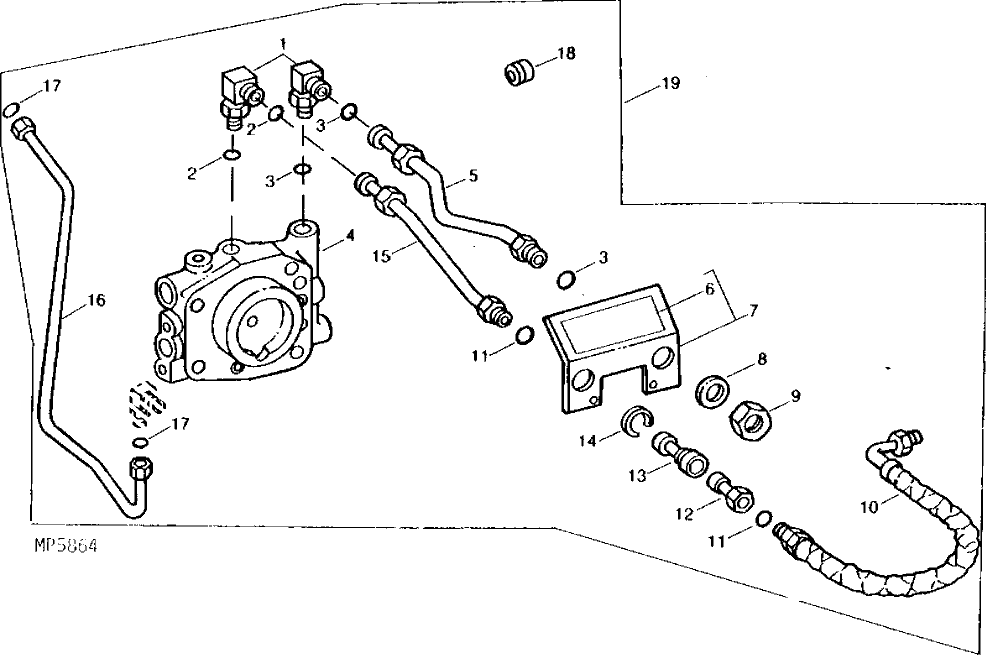

The kit is still available. If you look it up on the JD parts website, it says NLA... but don't believe it. It comes up that way because it is a "bundle" part and bundles don't show up on the website. If you call you dealer and ask for a price, he can pull it up and price it for you. I just did this about 6 months ago... the kit was about $250.
Bringing back an old one, today. I have a new need for the Power Beyond kit, and ran into two issues:
1. My local dealer tells me it's no longer available for the 855.
2. I found two versions of the kit, for different serial number ranges, and neither range includes my tractor.
Kit BM16762 for sn range 800001-820000 includes a hydraulic cylinder cap and extra oil line not included in the later kit. Kit BM16763 for sn range 820001- does not include these parts, but is otherwise similar. All references I find to folks installing Power Beyond on 855's are using the latter kit.
However, my 1986 MFWD 855 with SCV has sn 366633. Not in either of the listed ranges. In fact, I'm not seeing any 855 tractor year falling into these ranges, when I check TractorData.com. What am I missing?

Well, I figured out this serial no. referred not to the tractor serial number, found on the plate below the PTO, but to the transaxle serial number. This is stamped in a place one cannot easily read without disassembly, but after some craning and creative lighting, I think I read it as 801705. If correct, it looks like I need the the less common BM16762 kit. Figures, this is a first model year 855.
If anyone has any advice on buying this kit, I'm all ears. My dealer tells me it's NLA. I may try a salvage yard, but I suspect all I'll find is the 16763 kits. I might have to buy this kit thru parts, or piece together a 16763 kit with the few odd parts I need from 16762.
   / Deere 855 - third hydraulic function #25
The kit listed for the early trans adds the housing the PB ports actually screw into. I imagine the labor operation for that would make the whole thing scarry enough to consider buying a different tractor.
The later trans has the ports and the main thing needed would be the 90 degree ports. The later kit would most likely only require the seat bracket to be removed.
I haven't looked in the service manual but it would be nice if someone had install instructions for both kits.

Power Beyond kits BM16762 and BM16763 are no longer available from Deere, nor are they showing up on ebay anymore. I was able to piece together my own BM16762 for my early-model 855, with the exception of one of the two hoses (AM105470), item 15 in the diagram linked below.
I'm thinking of having one made, either flexible hose or hard steel line that I can bend (I have benders) to fit, but I need an estimate on length. If anyone knows whether or not a flexible hose would work there (will it pinch? chafe? is there enough room for a 1/2" ID (> 3/4" OD) hose?), that'd be good to know, too.
Anyone got access to one they can measure? This is the same as the more common BM16763 kit, the only differences are items 4 and 16 in the linked diagram. I'm thinking of having a hard line made up at 12" length, which I can bend to shorten and fit as necessary.
Thanks!

Instructions for installation are the same as the more common 16763 kit, used on the later tractors. There's just the one extra step of swapping on that cylinder cap, which isn't the biggest part of the job. Several folks have posted it took them 4 hours to do their 16763 kits, so I'd expect this one to take maybe 4-1/2 hours.
