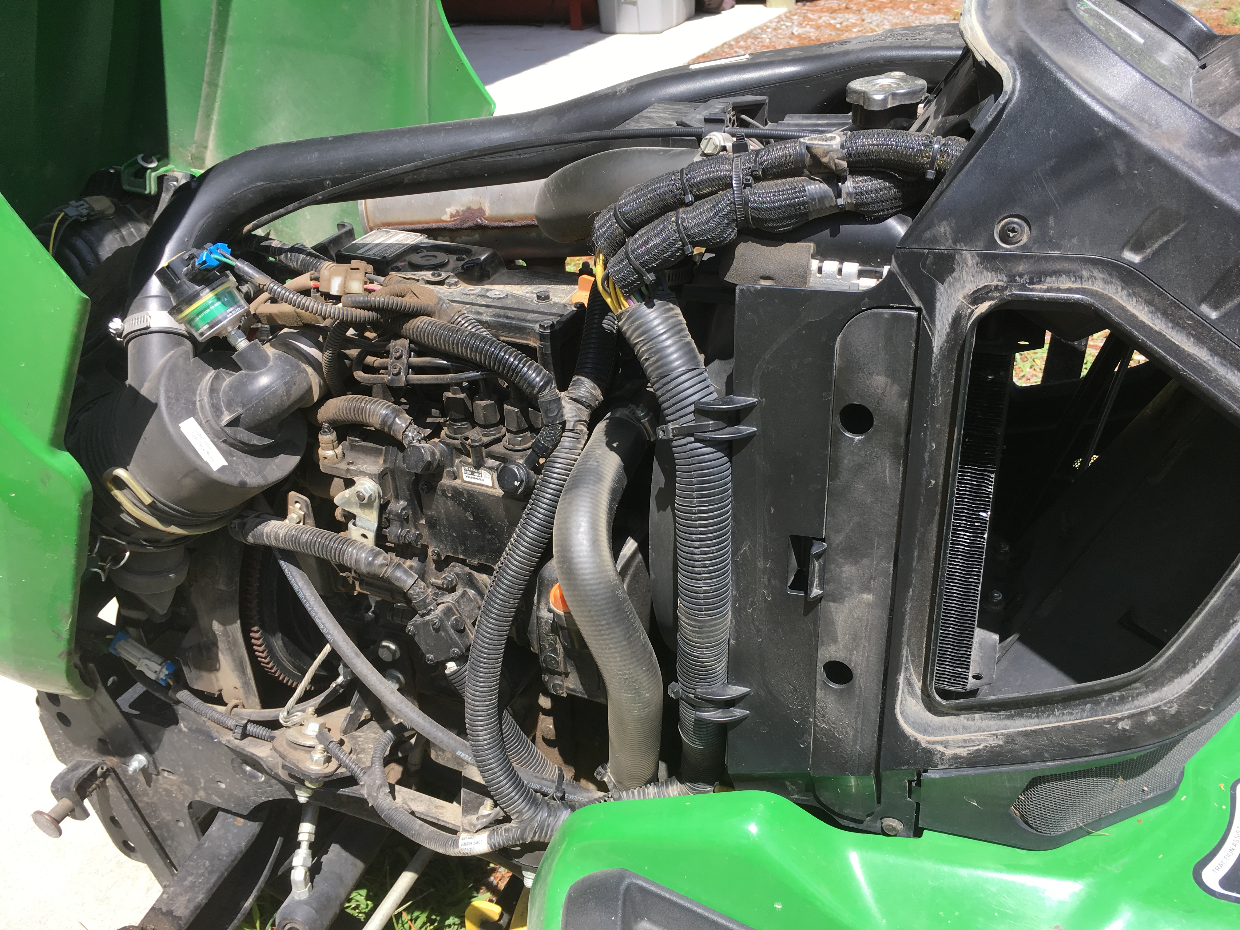

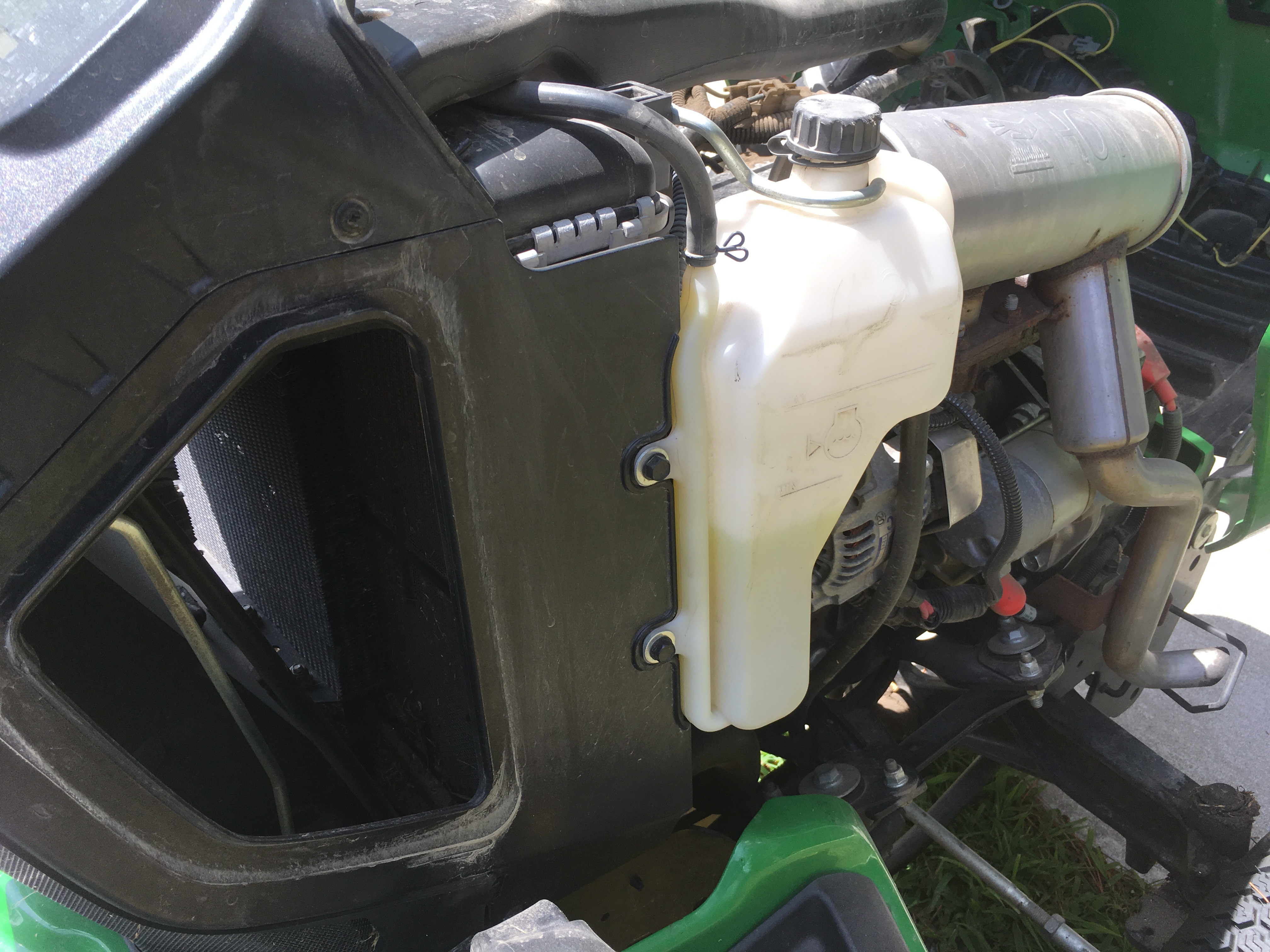

Let's try this. I think I have the most basic model with the least amount of additional equipment on it.
Do any of you have additional internal shrouding that could be specific to your model? Anything to change the air flow
as seen in these pictures? My temp gauge goes up about a quarter of the way and sticks there like glue.

The x7** series radiator was not open to back blowing to get compacted dust out of the radiator. You have to get creative to get air to the engine side of the radiator...like a rubber hose tied to a blow gun with a wire attached to bend for shape. Use a light and mirror to SEE if light can get through the fins.

I read a big reason for compacted dirt is getting moisture in there for any reason and the dirt cements onto the cooling fins, obviously reducing effectiveness of the unit.
Trick is to keep them clean, if you can, before they get thick accumulations. I don't like powerwashing in there except using my low pressure electric washer, and even then, like to take it pretty easy on any radiator assemblies. Yes, compared to a "regular" tractor, this is sort of backwards. My hand held Makita blower with rubber tip bends around to allow me to get in there, I hear you on the creativity. I just don't have a problem with it, yet.

I reread Kish's very good list. Coolant pump. If inadequate water flow, temps would rise quickly under load and high outside heat, and have nothing
to do with screen clogging whatsoever, or not core problem.
Gosh I'd go buy an inexpensive IR temp gun and start gunning this engine and log some numbers.
Find out if you really are getting hot at all.
If you are getting hot and your intakes are relatively clean, start looking elsewhere like pumps and bad grounds, etc.

My Kubota tractor heated up more than normal a month ago when mowing, had to get off every 30 minutes or so and clean the air intake openings. When I serviced the tractor a week ago, I used compressed air to blow back through radiator every direction I could (hard to get around fan and shroud), I was surprised at the amount of dirt that came out of certain areas. I kept at it until I couldn't get anymore dirt out). Yesterday, I mowed about 7 hrs without stopping once to clean the air intakes.
I don't know if perhaps you have some dirt clogging up your radiator, at least partially blocking airflow.
