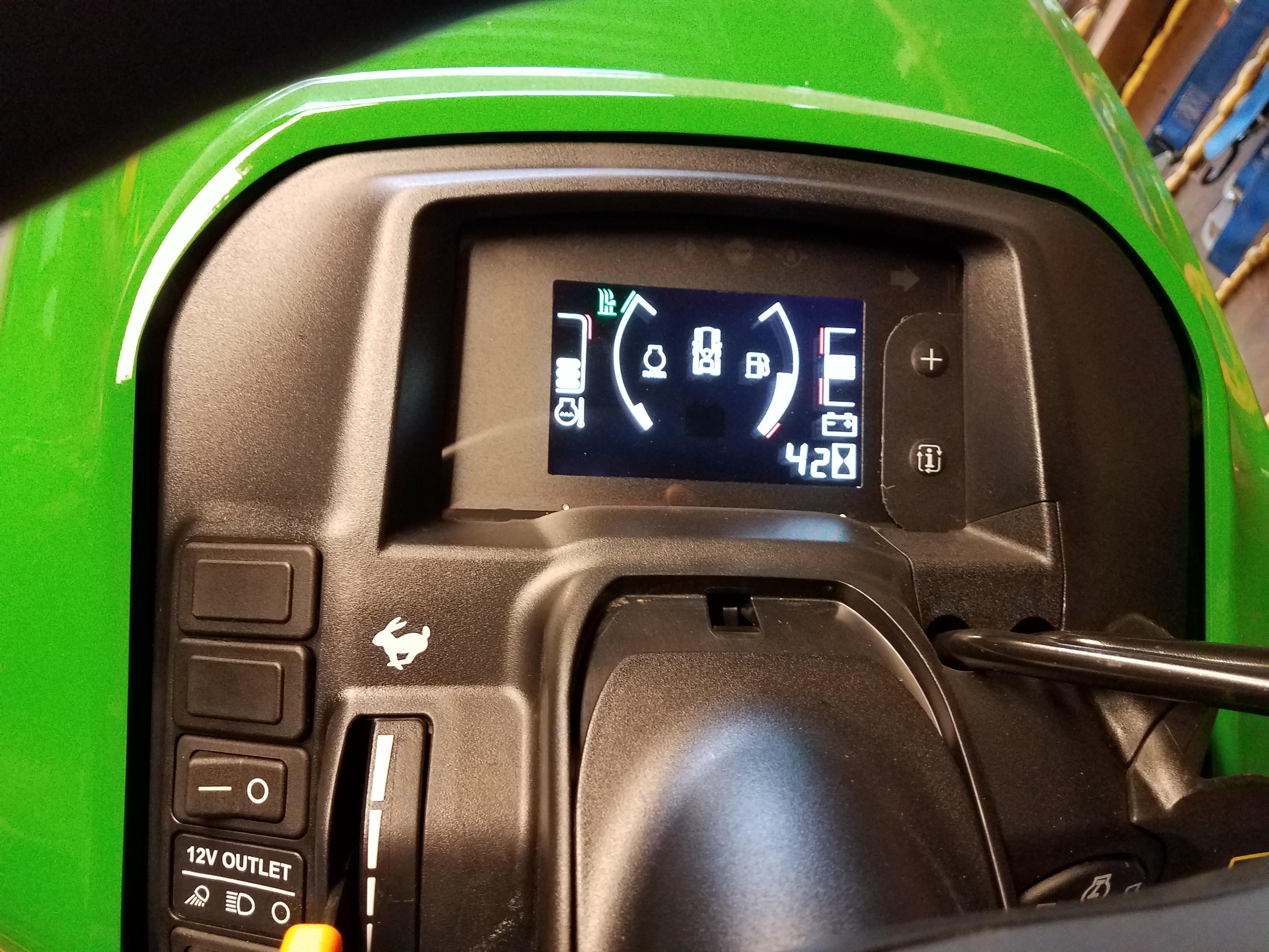

Humm, interesting, no numbers, just green and red.

06-28-19 John Deere.jpgOn the 2019 dash for the 700 Signature Series, this is what they look like.
3 notches showing is the hottest it has ever been, I know, not many hours.
   / Deere site reviews indicate the X754 has overheating issues. Why not X750 or X758? #34
new dash, have to admit not all that easy to read, kind of like the old style better for viewing, but I'm sure this
shows more data points, alarming, idiot lights. Oh to have six nice round gauges in front of us...:rolleyes:

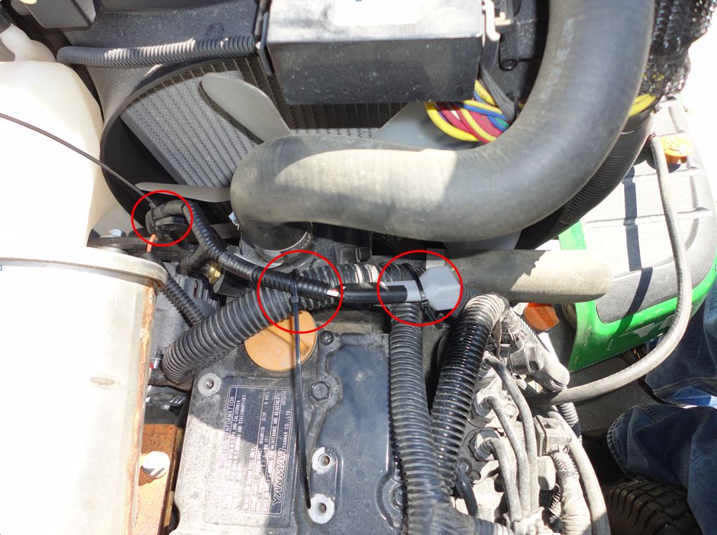

Talked with our RDO Tech support person. Found a bulletin retarding the overheating issue.
Complaint or Symptom :
Engine overheats and/or PTO shuts off.
Problem or Situation :
Instrument cluster may be reading incorrect temperature from coolant temperature sensor.
Solution :
NOTE: This solution is NOT applicable to X7 machines above S/N 040000 OR X950R machines above S/N 030000.
FOR DIESEL ENGINES:
Order part AM146977
To Install:
1. Cut zip tie used on engine coolant temperature sensor wiring
2. Plug male end of jumper wire into harness
3. Plug female end of jumper wire into engine coolant temp sensor on engine
4. Zip tie harness (3 locations) as shown in
FOR GASOLINE ENGINES:
Order AM147229
To Install:
4. Zip tie harness as shown in
Additional Information :
This added resistor will not exceed Engine Manufacturer’s temperature specification.
Also refer to DTAC solution 110474.
X734, X724, X758, X748, X749, X738, X739, X728, X729, X950R, X750, X740, X730, X720, X754, X710, X744, X700
Will order the part, install and report back.
