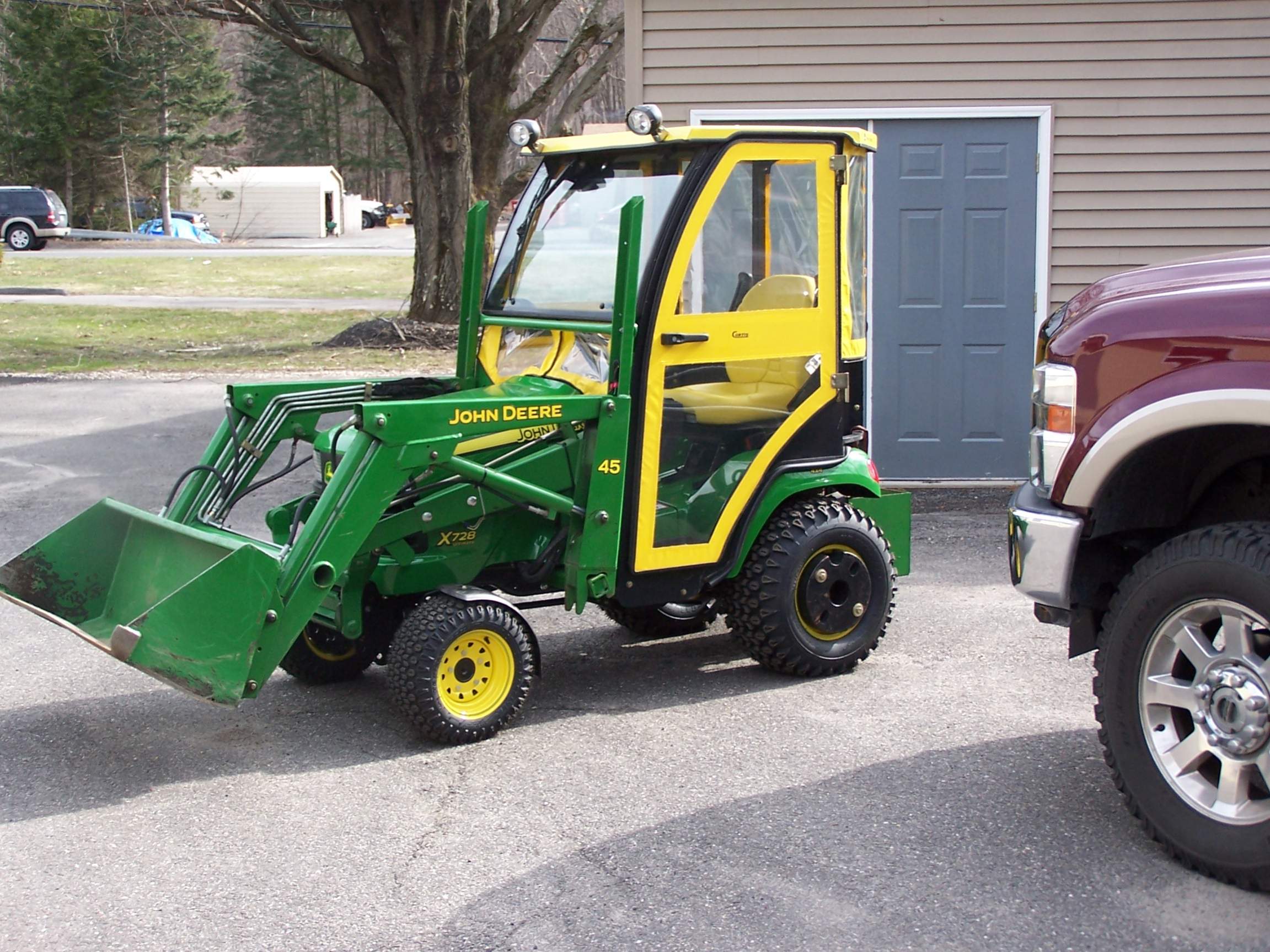

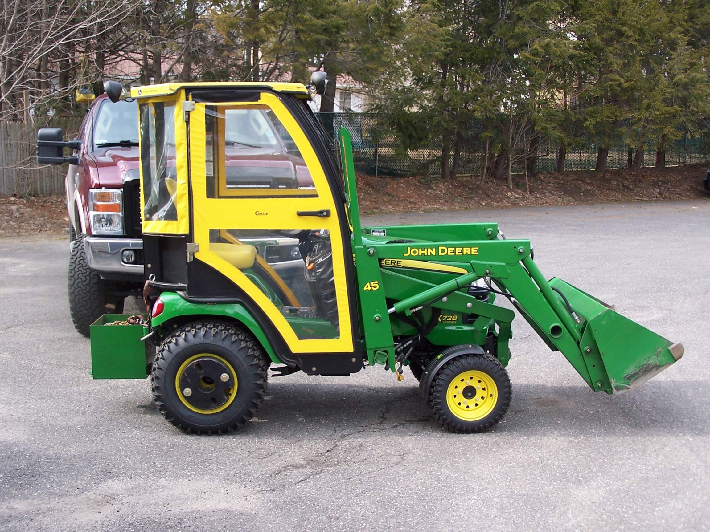

They would switch over cab, heater, loader and I'll need a different front PTO.
The cost of new is $4100 another $500 misc parts and labor of around $1200.
There is no chance of rebuild.
Dealer has a X728 in stock going to try and make a deal, I really have little choice as far as I can see.
Thank you to all for your great responses.

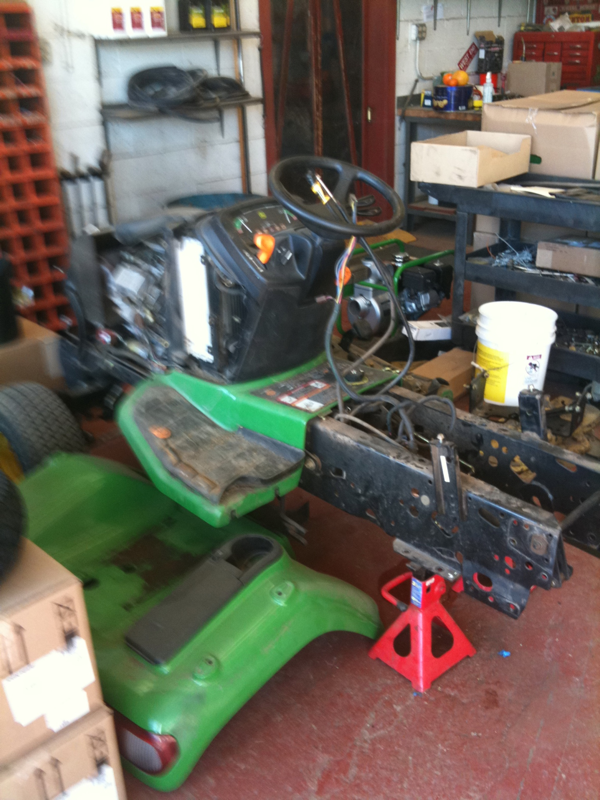

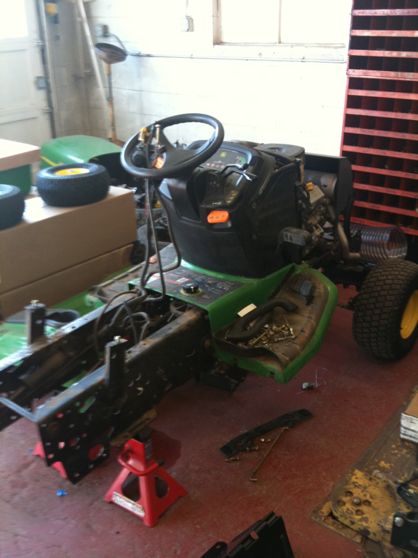

Here is my X485, what's left of it!
