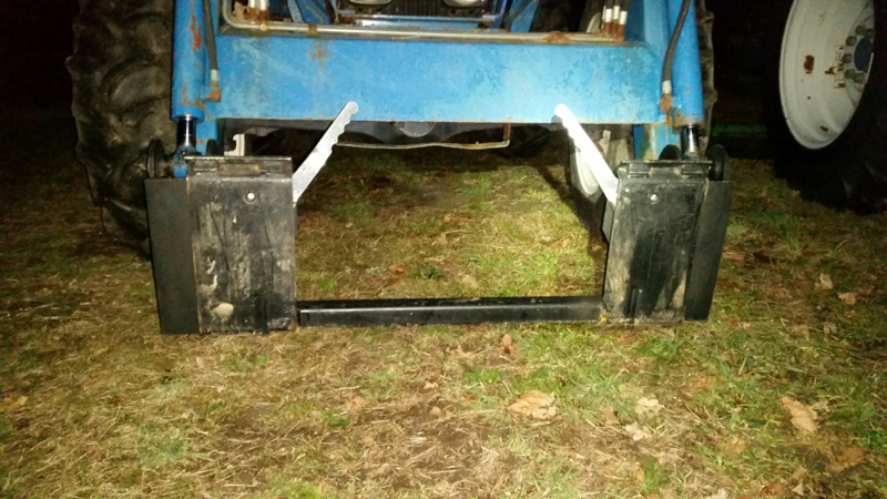

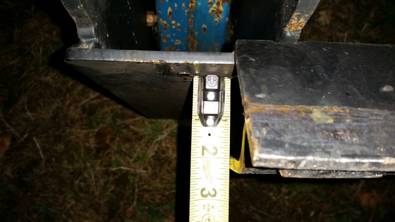

I emailed off more pics and measurements to the folks at ETA today, they sent me a couple emails first thing this morning to follow up. Anyone else with a SSQA adapter on a tractor loader run in to similar issues with clearance between the adapter and plate? If anyone is willing to chime in with a depth measurement on the adapter end (male) where it contacts the (female) end of the plate on the attachment or bucket.
View attachment 404474 View attachment 404475

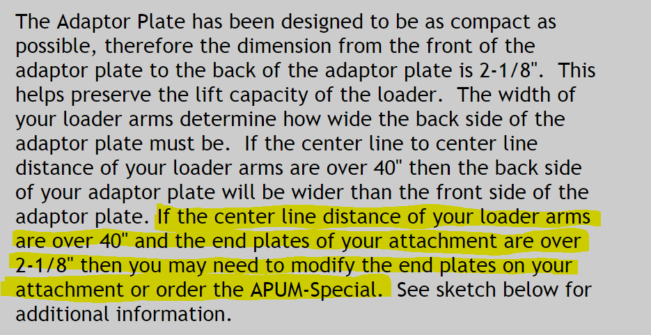

Did you get the W.R. Long APUM-Special?
From their Website: Adaptor Plate

Did you get the W.R. Long APUM-Special? From their Website: Adaptor Plate <img src="http://www.tractorbynet.com/forums/files/owning-operating/404545-definately-time-quick-tach-plate-wrl-png"/>
Good eyes my friend, that's the first I've heard of that, ETA didn't mention it when ordering, I'll have to ask. I will say that Travis at ETA has been very good in staying on top of things.

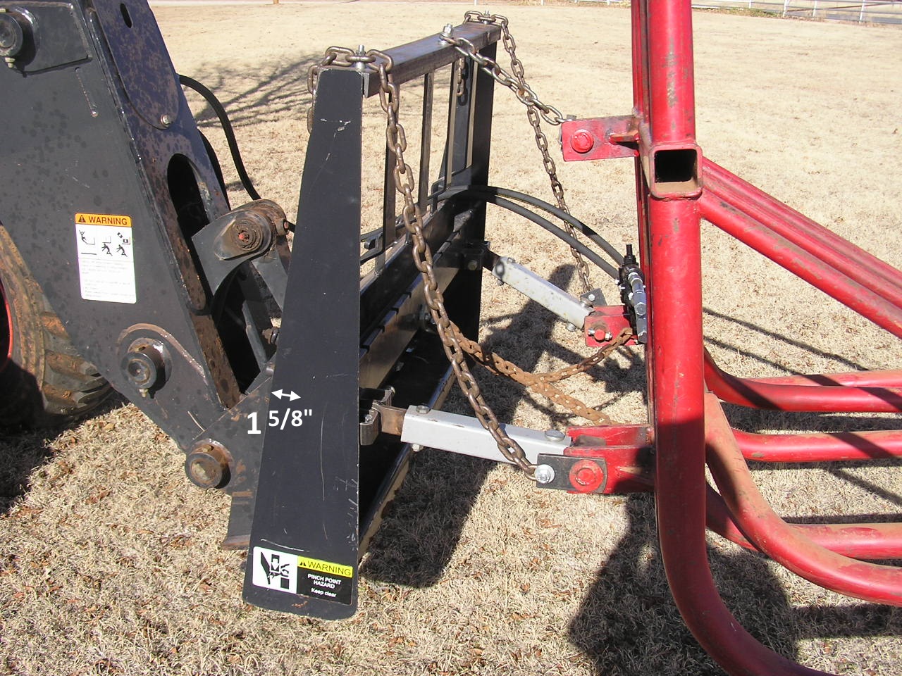

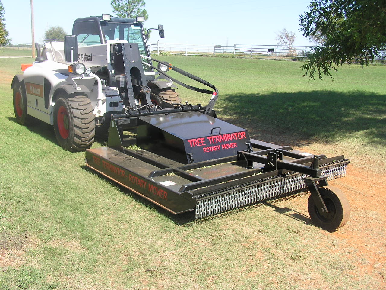

One other thing that I thought of, you could go to some rental places and skid steer dealers and measure their adapter plates to see how many won't work on your QA.
Here is a modified pallet fork frame that I didn't measure, forgot about it, don't use it now.
It would work on your QA. :thumbsup:

One other thing that I thought of, you could go to some rental places and skid steer dealers and measure their adapter plates to see how many won't work on your QA. Here is a modified pallet fork frame that I didn't measure, forgot about it, don't use it now. <img src="http://www.tractorbynet.com/forums/files/owning-operating/404615-definately-time-quick-tach-plate-cedar-tree-cutter-m-0-a"/> It would work on your QA. :thumbsup:
Another good idea, thank you again for your time Xfaxman

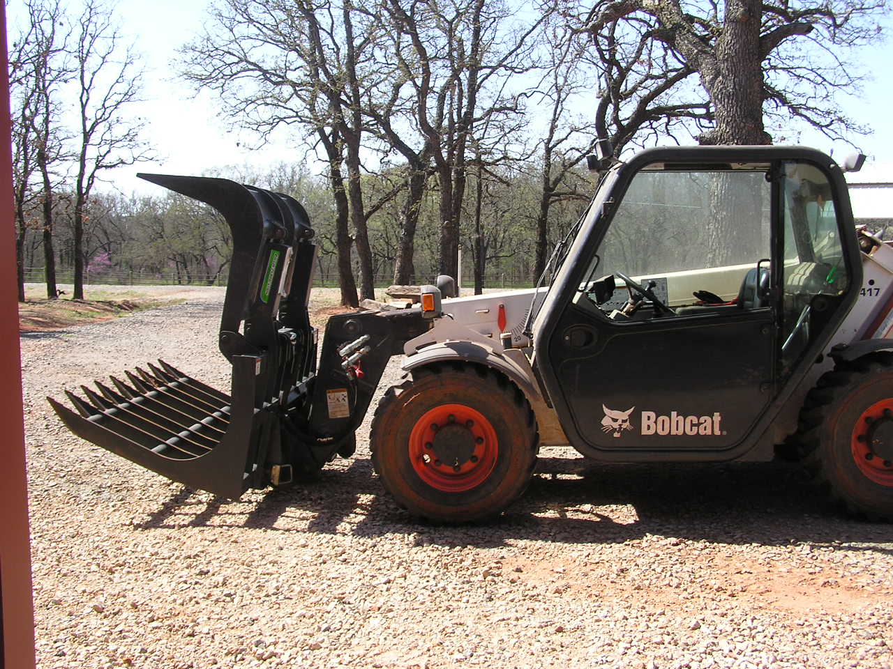

Your'e welcome. Since you probably have never been to a skid steer dealer, I think most have attachments that they rent. I know the Bobcat dealers do, that is how I found out about my Monster Grapple and brush hog, from two different dealers.
