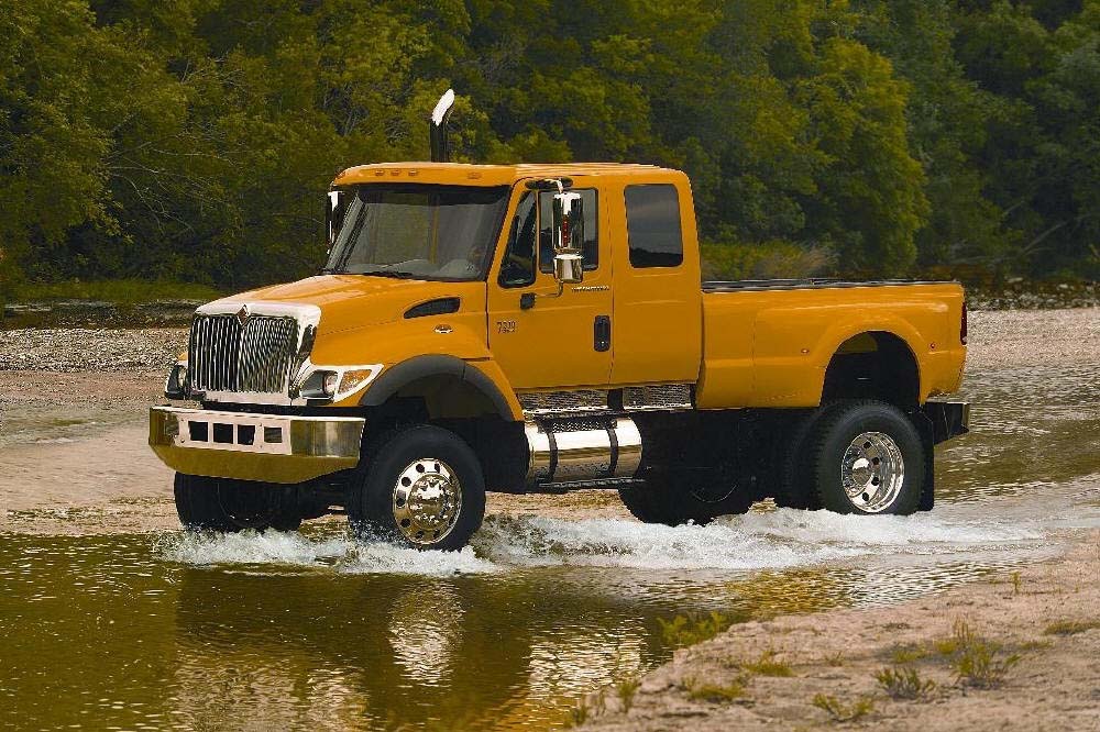

IllMarty1 said:
If I read the Fed USDOT law correctly, any single mototrized vehicle over 10,000 GVW is considered a commercial vehicle, and any single vehicle with GVW 26,000lbs requires drug screening. Also any trailer over GVW 10,000, regardless of what it is being towed with, triggers drug screening in addition to Class A CDL also.
I think you may be incorrect about the trailer over 10,000 requiring Class A. My understanding is that the trailer can be over 10K as long as the total combined weight (actual, registered or on title) is not over 26K. So a 16K trailer behind a 9600# truck, or a 14K trailer with a 12K truck, is OK with no CDL.
Here is quote from current NY DMV. I believe CA is the same. Anyone know for sure?
NYS DMV said:
The NYS driver license classes include:
Operator, Class D: Issued to drivers age 18 or over, or to drivers age 17 with Driver Education. Valid for passenger cars and trucks with a gross vehicle weight rating (GVWR) of 26,000 lbs. or less. A Class D driver can drive a vehicle that tows another vehicle (for example a trailer) that has a maximum gross weight of 10,000 lbs. or less. A Class D driver can tow a vehicle with a GVWR of more than 10,000 lbs only if the combined weight rating of the two vehicles is 26,000 lbs. or less.
NYS DMV - NYS DMV - Driver License, Learner Permit and Non-Driver Photo ID Card
http://www.nydmv.state.ny.us/forms/cdl101.pdf
http://www.nydmv.state.ny.us/forms/mv500c.pdf
I think the situation in CA where they put a weight limit on the definition of pickups was partially brought about by things like pickup style beds on F-450's and other such modifications to 1+ ton and larger trucks. I guess they felt they had to draw the line somewhere and other states will do the same.
