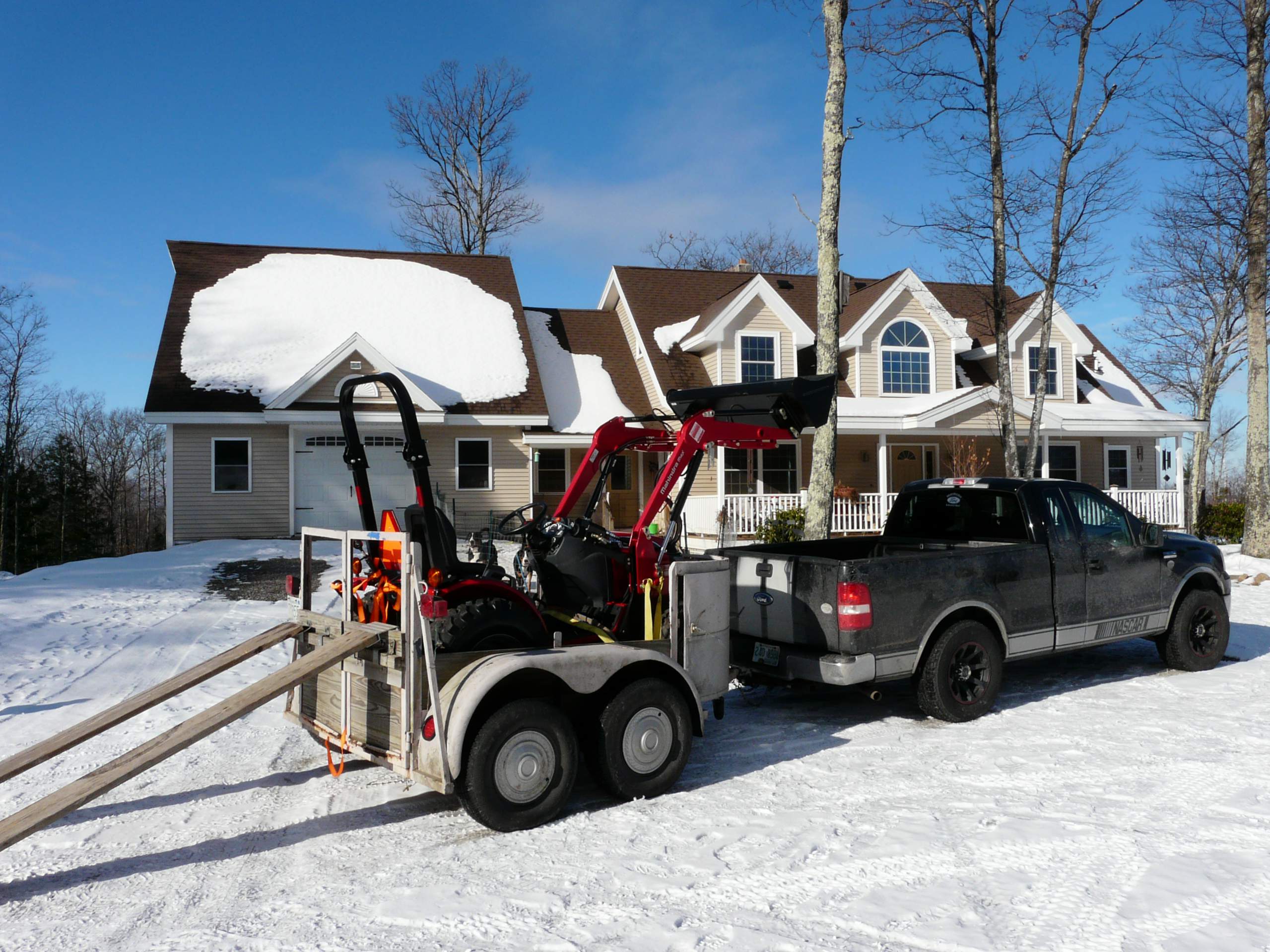

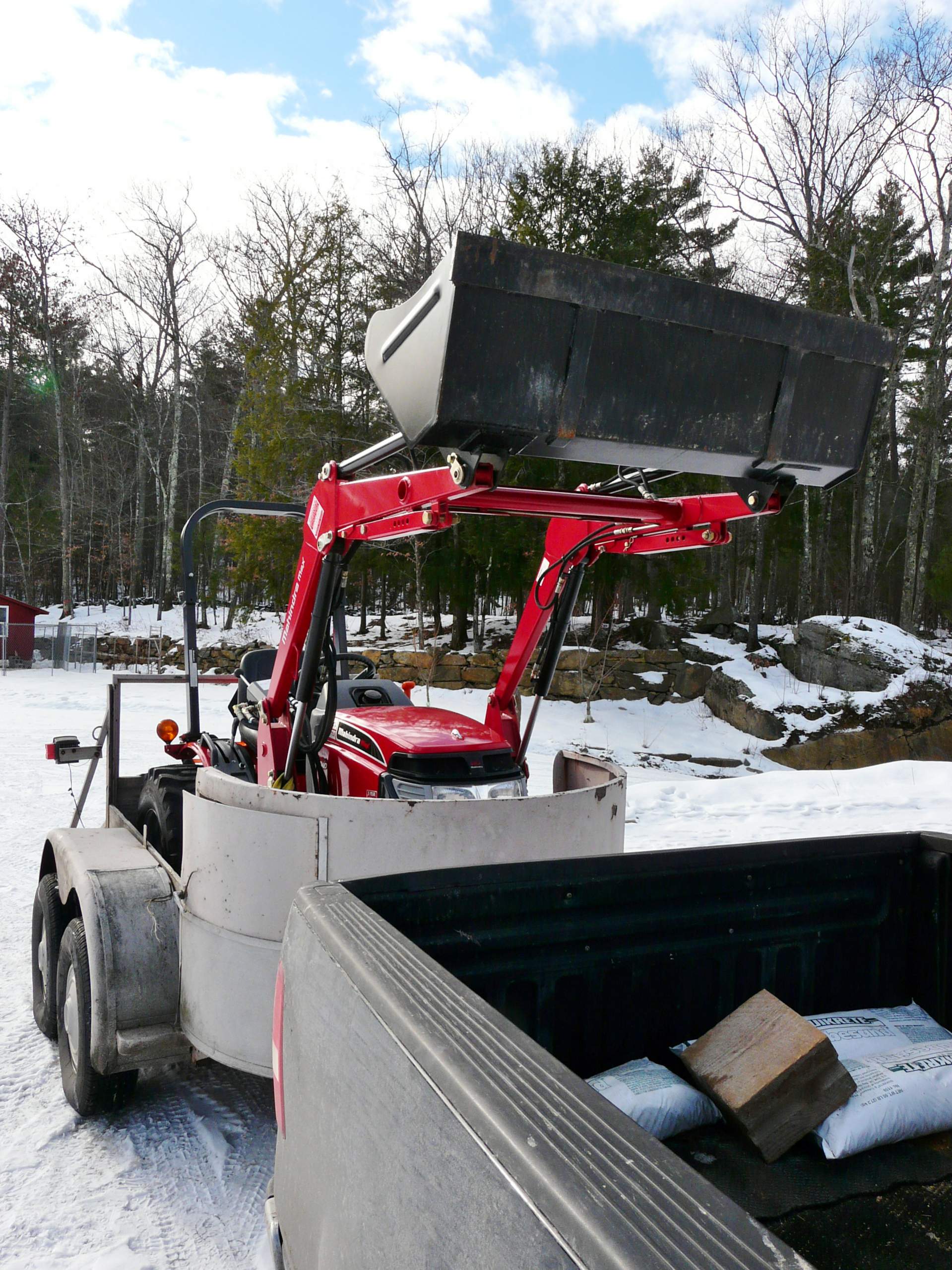

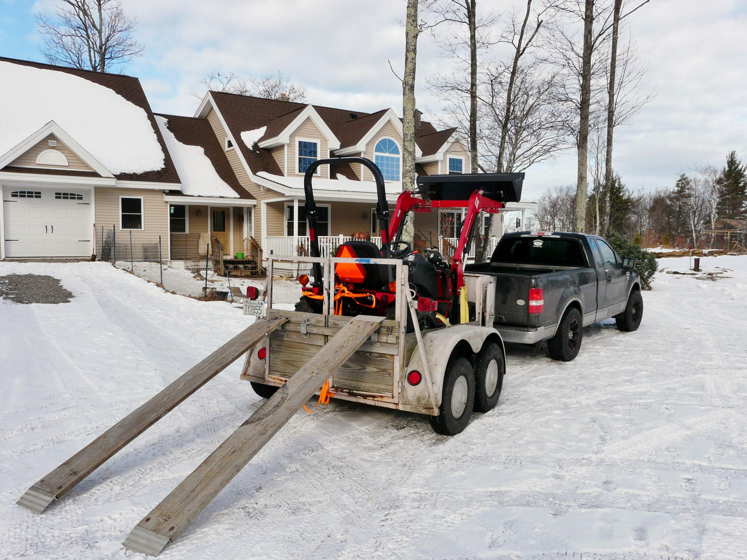

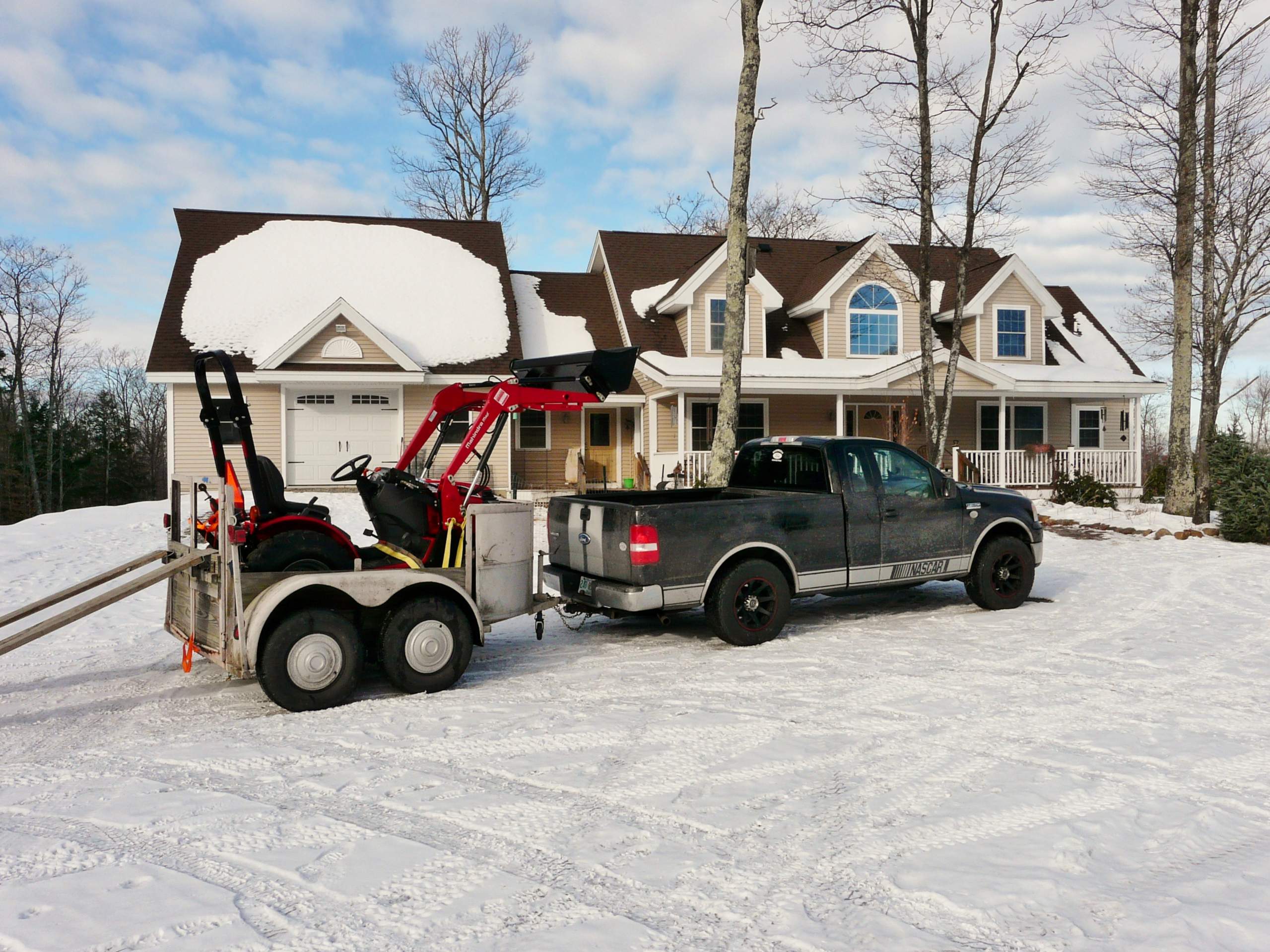

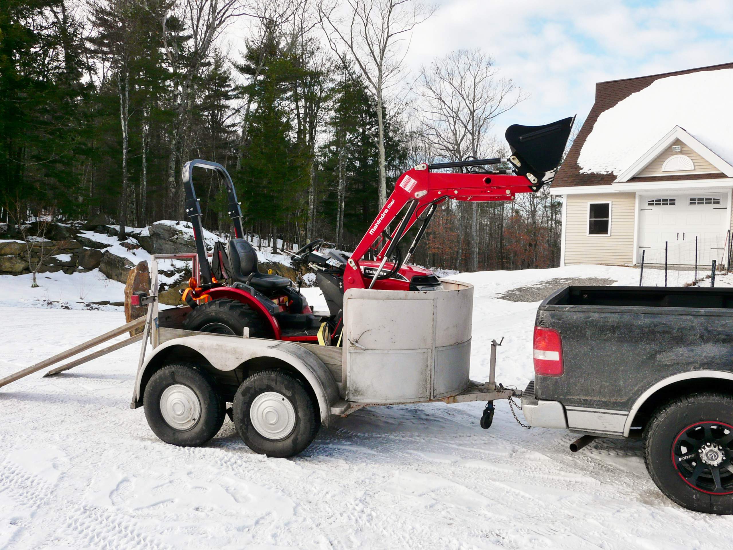

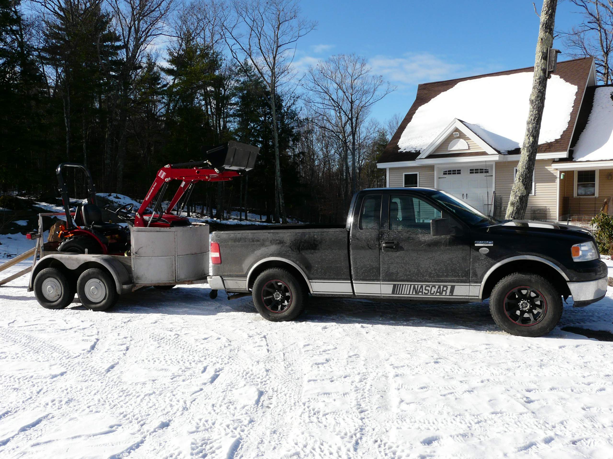

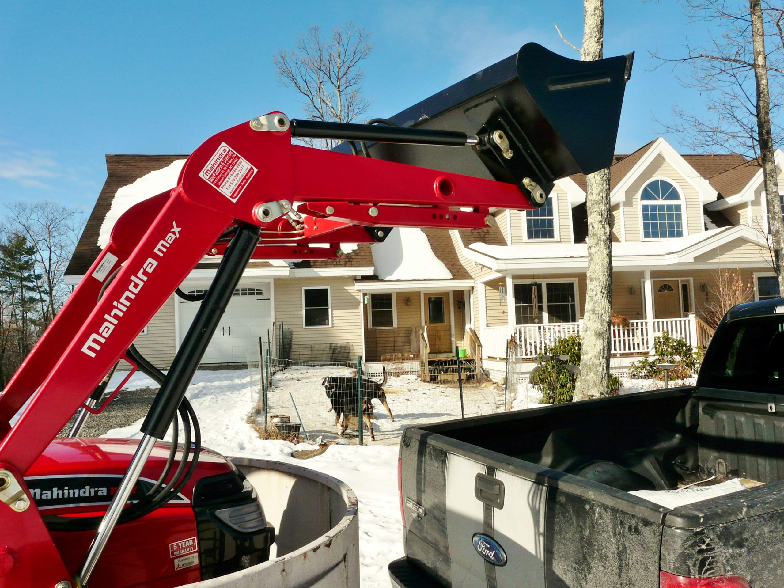

'Well, I hope my doubts are groundless.
It was a long not so fun and slow ride over Rt. 7 & 9 thru Vermont last night, snow squalls coving the road. Going out to NY during the day, the scenery was beautiful, but what should have bee 9 hours on the road took over 12 hr Travel time, nearly 15 hours total.
Towing with a 2 WD Pickup, 400 Lbs of sand bags in bed, limited Slip, and Blizzaks, I was turning around in a relatively flat parking lot on the way out, (no tractor) and the tires just found a wet . I was stuck.
(Thank you kind Samaritan with the $WD dually!)
The 2006 4.6L V8 had its hand full just towing a bit over 9500 GVW, with the little but heave horse trailer, The Max 28 I found out today that it does not have the loaded tires as promised I would hope that the dealer will reimburse me for the cost of having the tires loaded locally.
We got home safely, and will now unload the little bugger.
I had to wire up the stabilizer links and we removed the grill guard to get it on the trailer. A bit bigger and as least as heavy than my Kubota, even though the Kubota has 300 Lbs Iron bolted to the frame and loaded tires also.
I still have my doubts that the loader is good for 1400 Lbs at the pins. If it can handle near 1000 lbs in the bucket that will be plenty. A quick check is to verify it can lift my Fisher plow.
Can anyone tell me if the Max. comes with an extra set of keys, I only got one Key?
