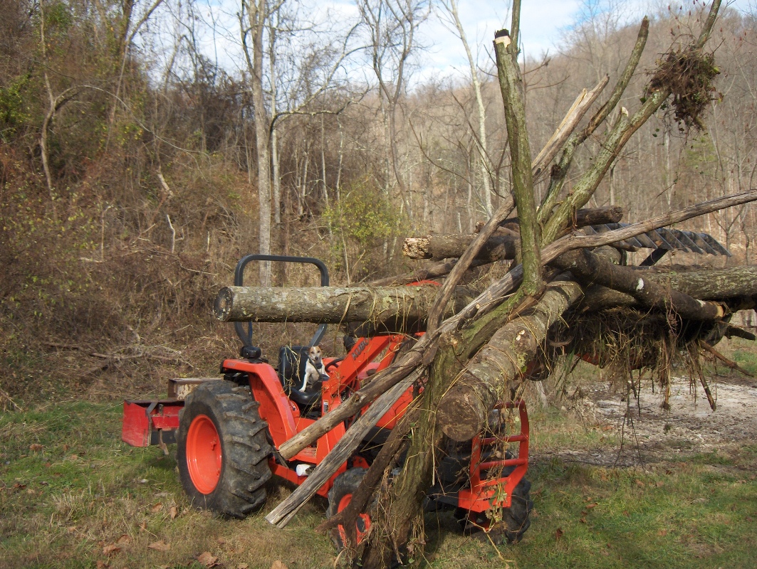

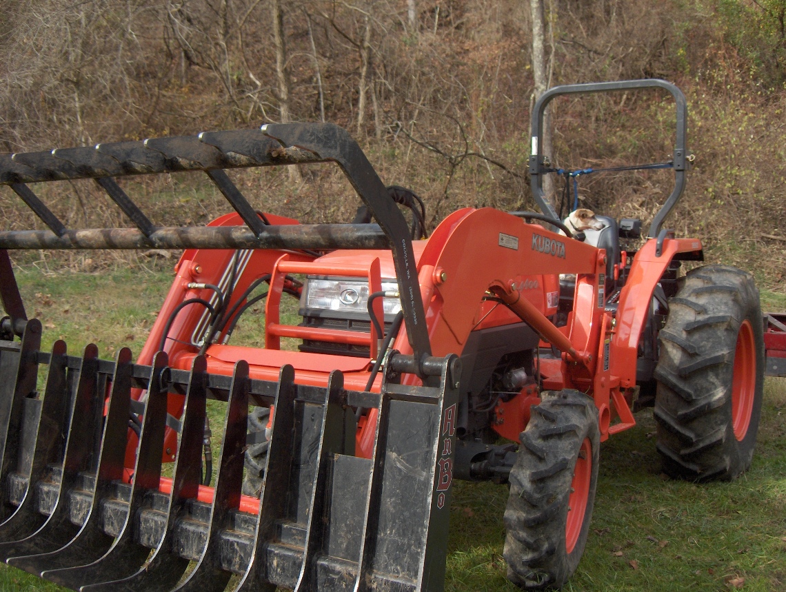

I think that when you work in the brush and logging with a tractor a Grapple is one of those attachments that you wonder how you ever got along without it. I got a Anbo GRM 66" Grapple and the weight was one of the reasons I went with Anbo it weighs only 340# and is plenty strong. The LA703 loader is much weaker than the you loader that you have so you will be impressed with what you can do with it on your machine.
   / Dehnerwelding Grapple dialup warning #40
Mine with the QA and everything will weight in at a little over 400 lbs. I wanted a Grapple that did not have forks so to say. I want the weight as close to the pivot point as possible so I can lift more. I am looking at around 3200 lbs of lift at the pivot. I am impressed at what you have in it in the second pic.I was about to order one 2 years ago and then something came up and I couldn't.BTW how long did it take you to teach the pup how to operate the Bota.
