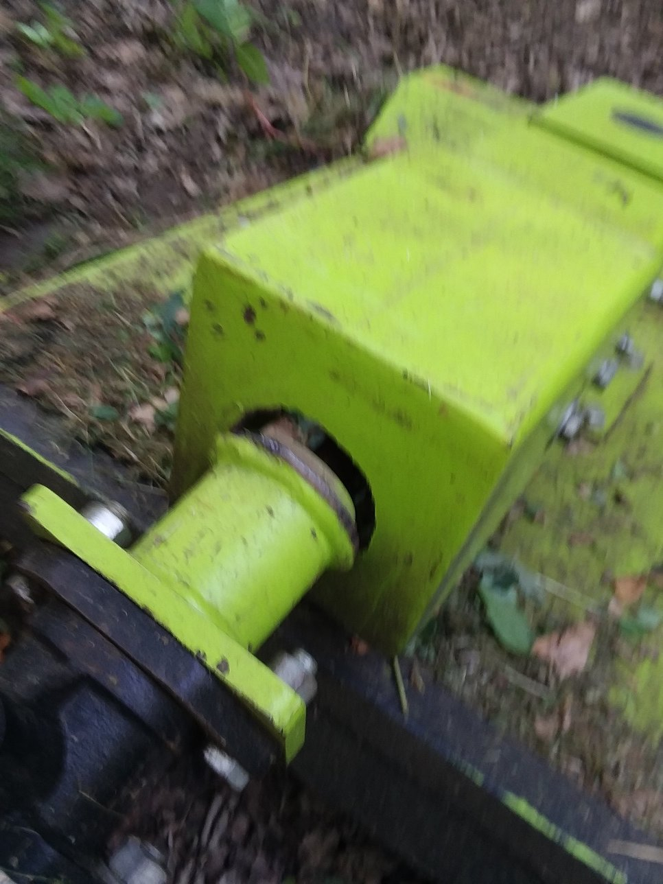

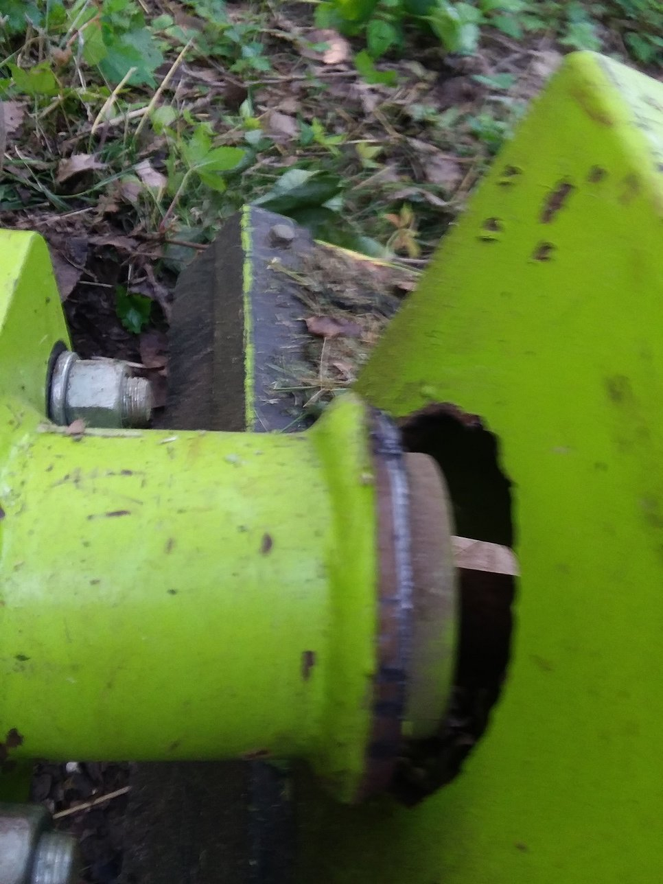

I've been abusing my Del Morino brush mower for 7 years. It finally decided it had enough. Broken weld and broken drive shaft.
   / Del Morino mower finally broke #2
That is certainly a catastrophic failure. Was weld faulty or just too much stress ?
   / Del Morino mower finally broke #3
Brush Mowers do live a tough life. How many hours would you estimate? What were you cutting?
Maybe 1000 hours, maybe more. Hard to guess.
I cut everything I can with it. It's been repaired many times for more minor issues.
I believe this issue was caused by me lifting the front end (by pushing down on the handles) when turning.
I had the part welded and have the new shaft, just got to put it back together now.
