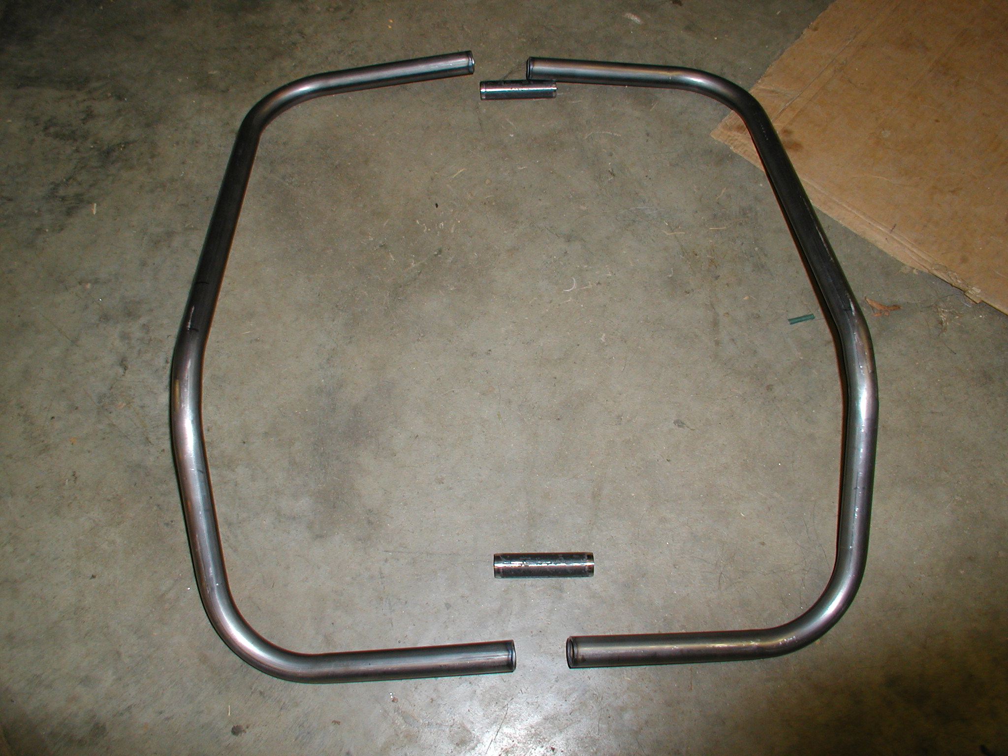

But, I plan to modify the grill guard on my 110 in a very similar way that I reworked my JD 970 grill.
Heavier extruded grating than the JD deluxe grill guard and 3/8" x 1-1/2" flat stock braces behind the extruded grating.

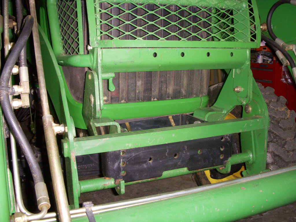

The deluxe guard still has a opening you can get to at the bottom, don't ask me how I know.
Ahhhh, let me guess. You have a JD 4120......... and hopefully didn't have a puncture thru the opening.

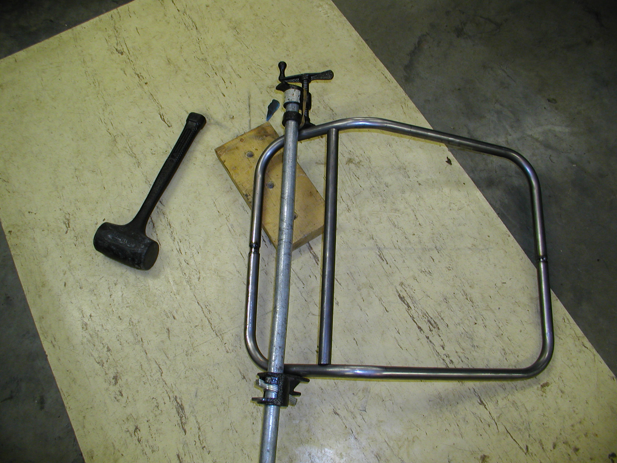

I went through the same thing with my dealer. After about 20 minutes, they quoted me $1300. I built my own, for under $20 and it's built a heck of a lot better than the cheesy sheet metal junk you get from the dealer! I'll put up pictures of it as soon as I get our new computer.
Thanks for posting that pic. That area is where I poked a stick through the screen. The stick didn't go through to the battery, or past to the oil cooler and radiator. But made me more cautious pushing into a brush pile. Have intended (??) to get a better protective guard built, but it hasn't happened yet. Maybe this thread will get it done. Might just go out and measure it up now. :D

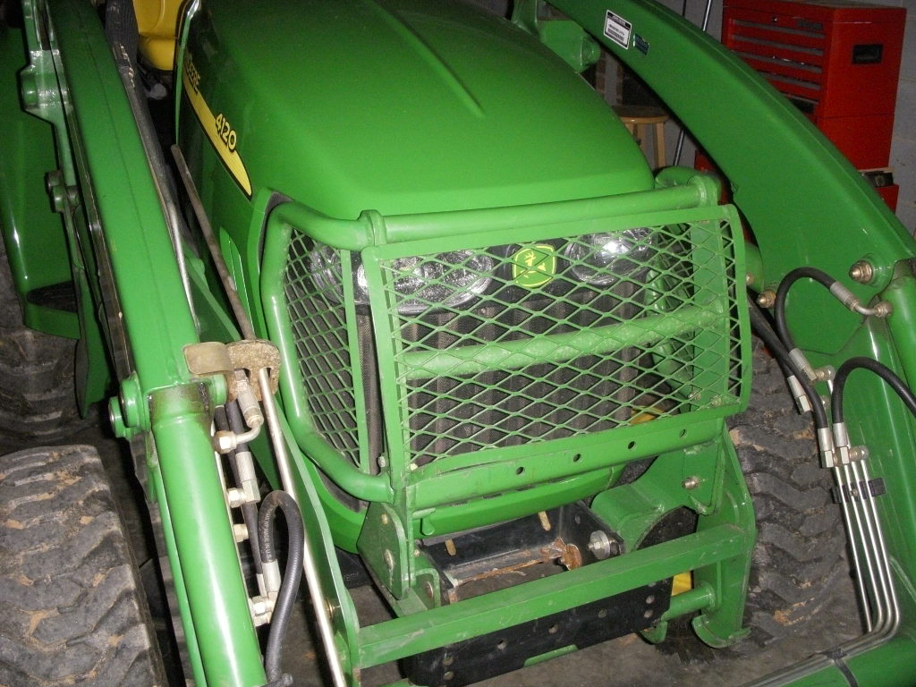

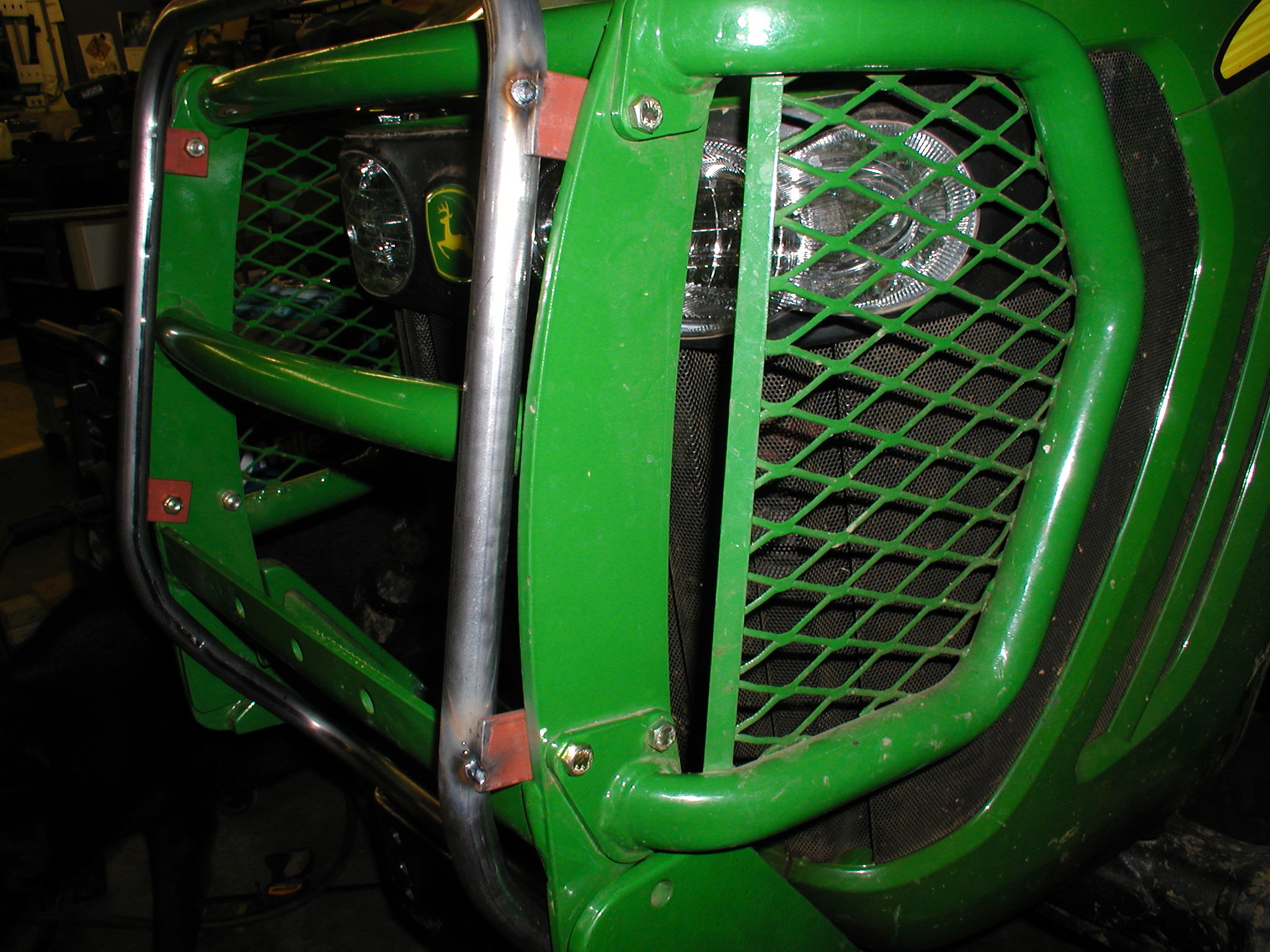

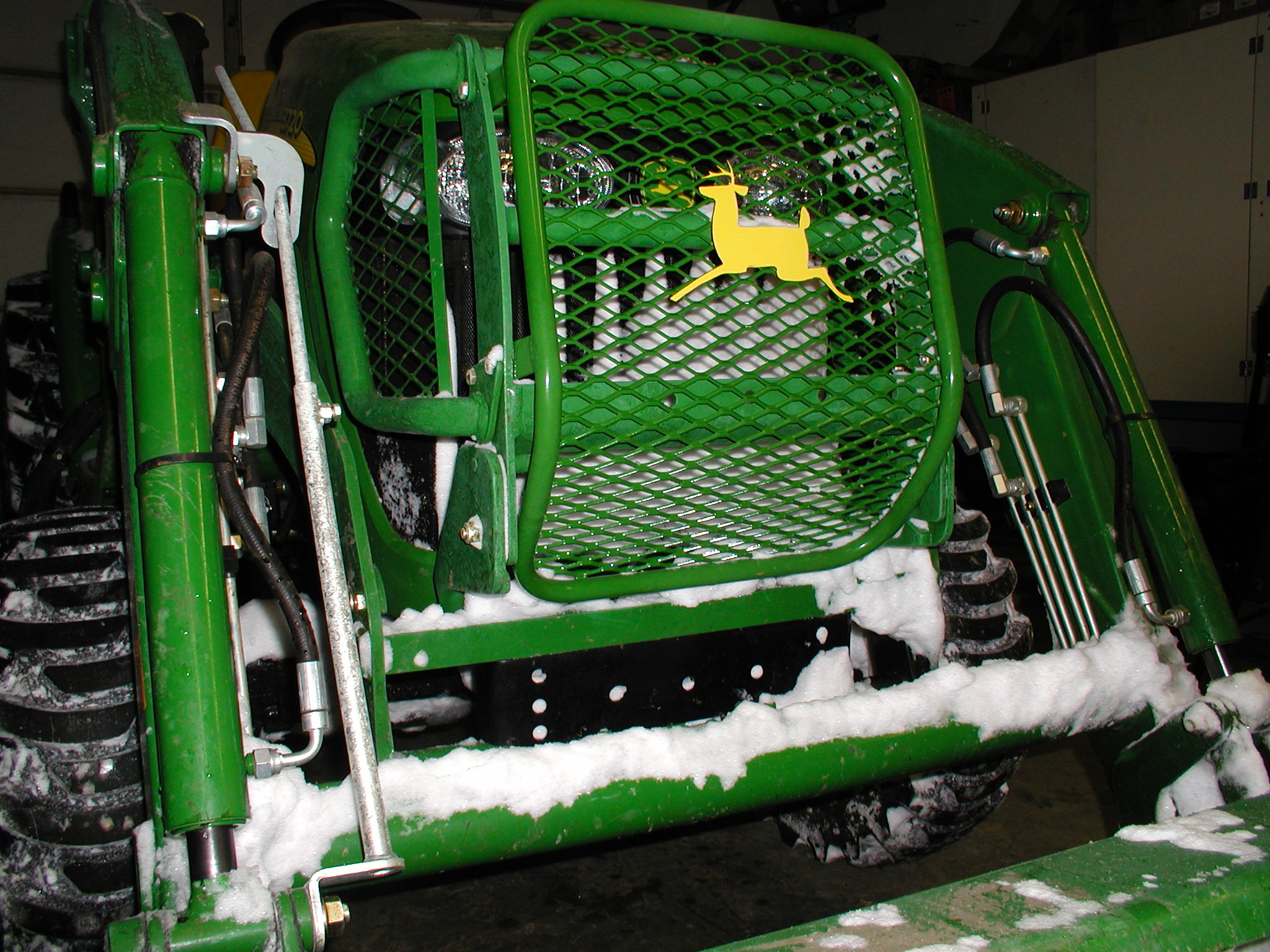

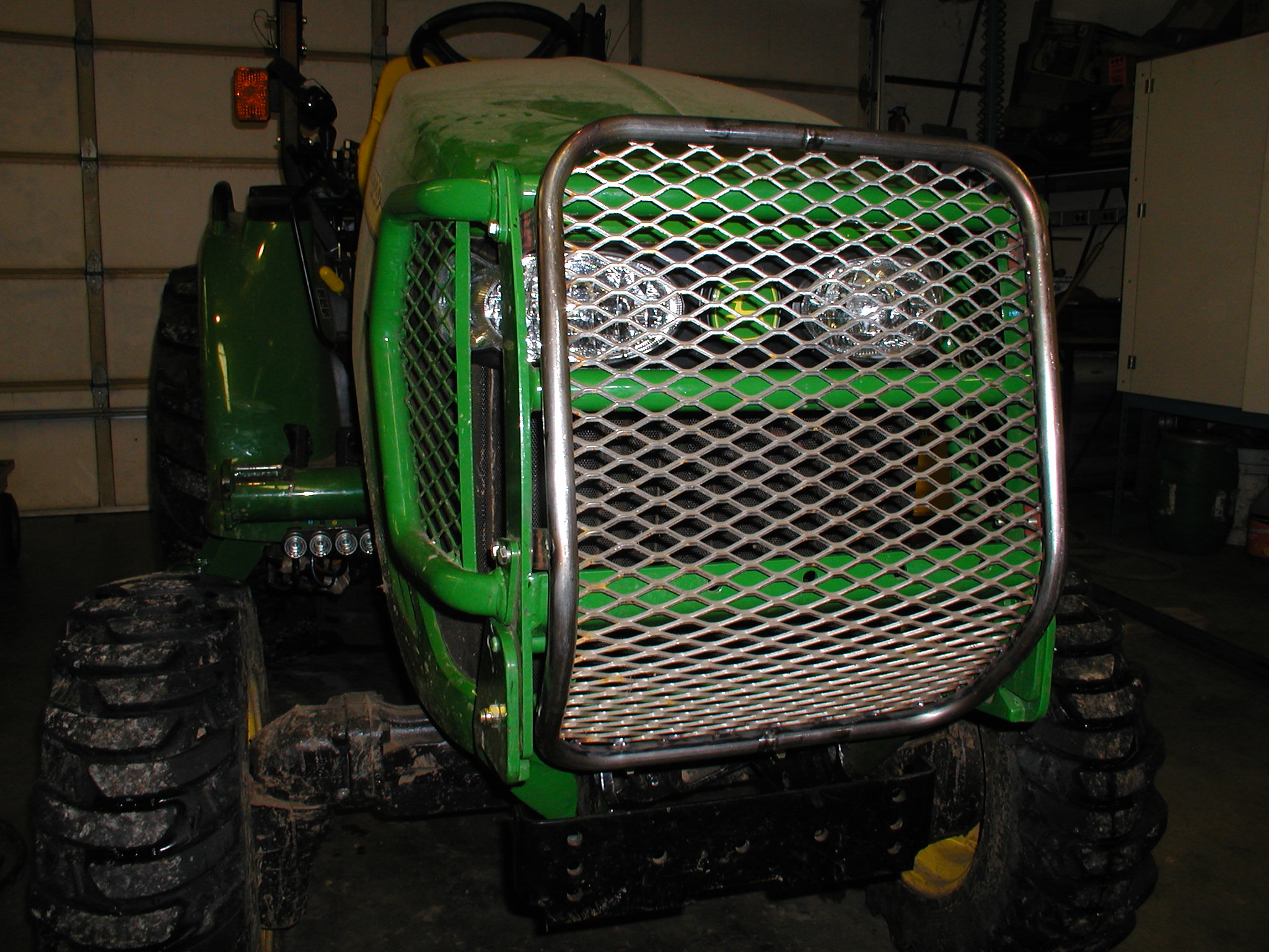

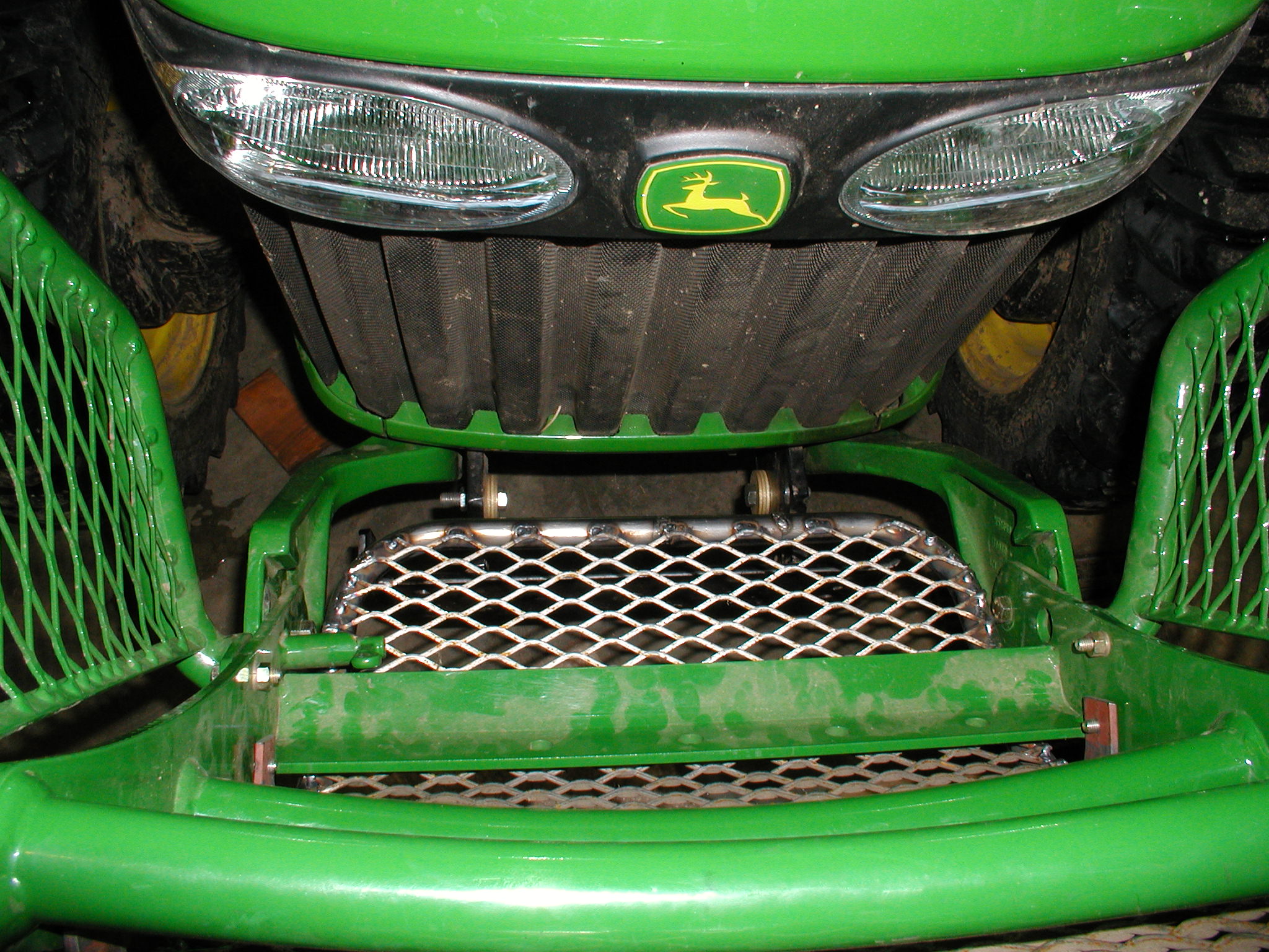

I fell for the "deluxe" hood gaurd for about $260 with the tractor (3720) purchase last year. By the end of the summer, the lack of grill protection down low was readily apparent, and the gaurd itself was dented in a few places, obviously made too light of rolled metal (not expanded). I was able to straighten the grill corrugated metal ( aluminum I think! ), and then added a much better-coverage version of the center section. Mine is built with actual expanded metal, about 12 gauge thick and TOUGH to get to conform to the frame. and the coverage is complete now. Have pics here somewhere...
