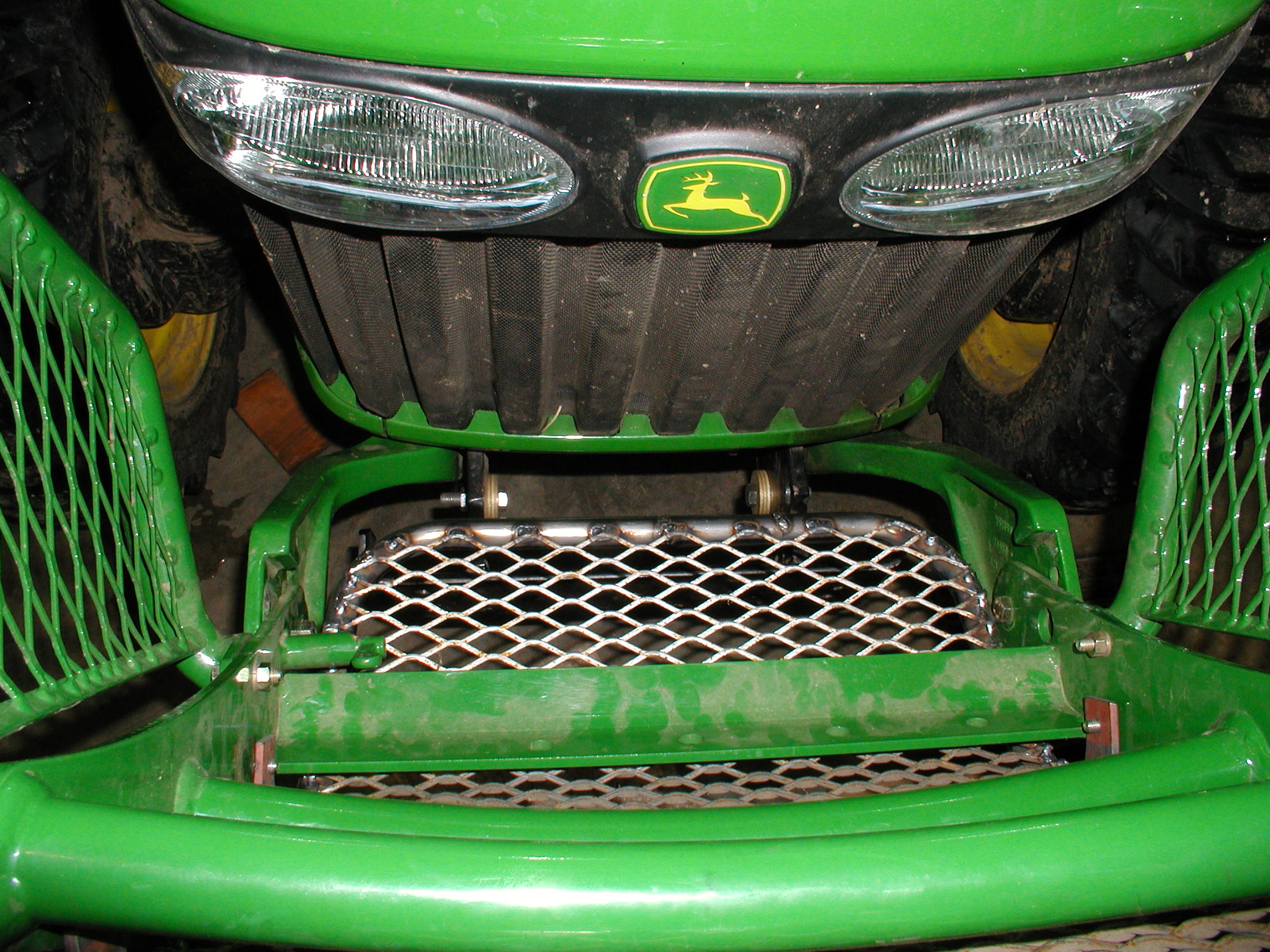

Could you get the expanded metal you used locally? What guage is it? Any other specs.
I like your design.
   / Deluxe Hood Guard #22
That looks good jimgerken! Does it still have the full travel in pivoting forward in order to open the hood?
   / Deluxe Hood Guard #23

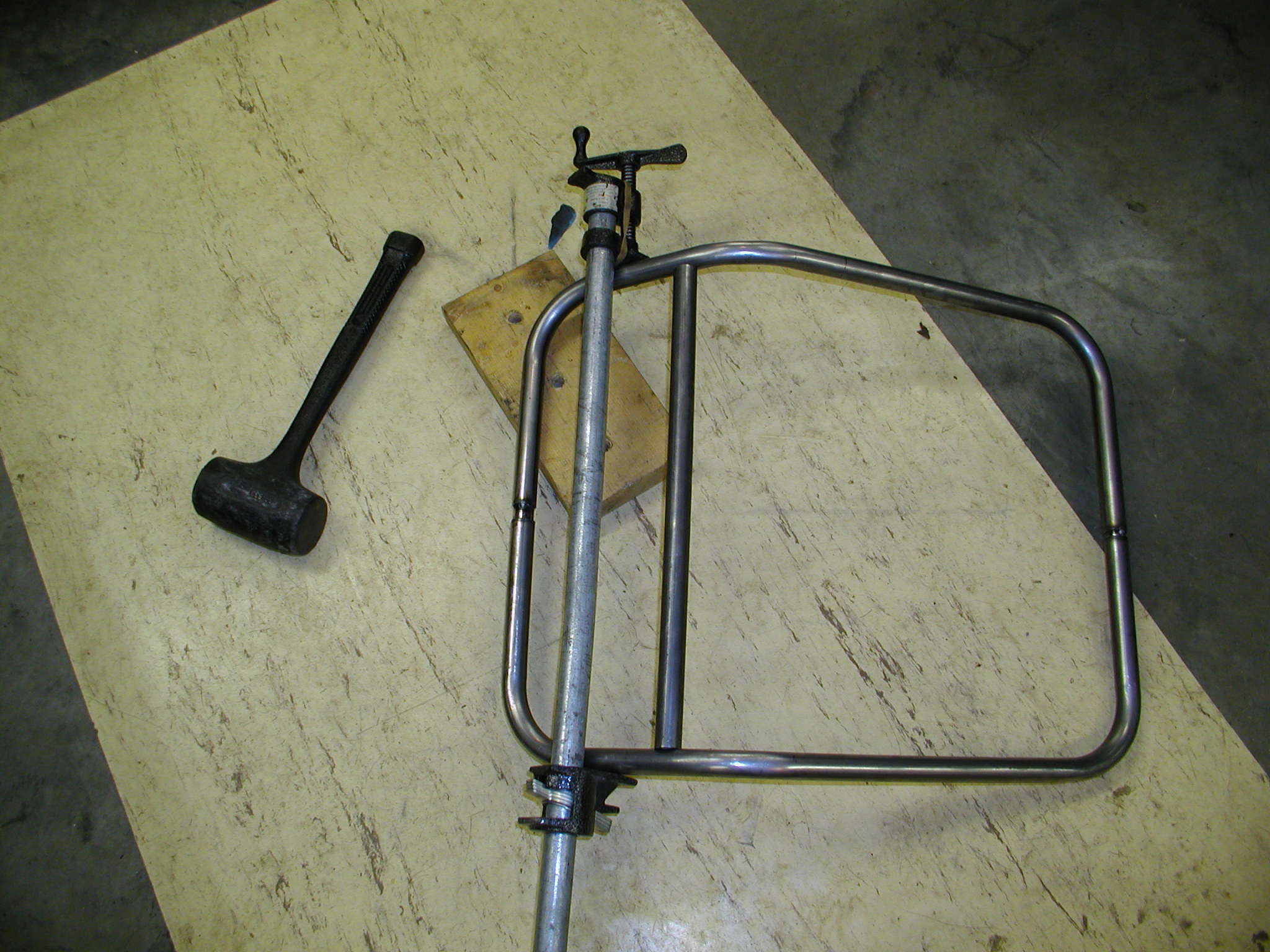

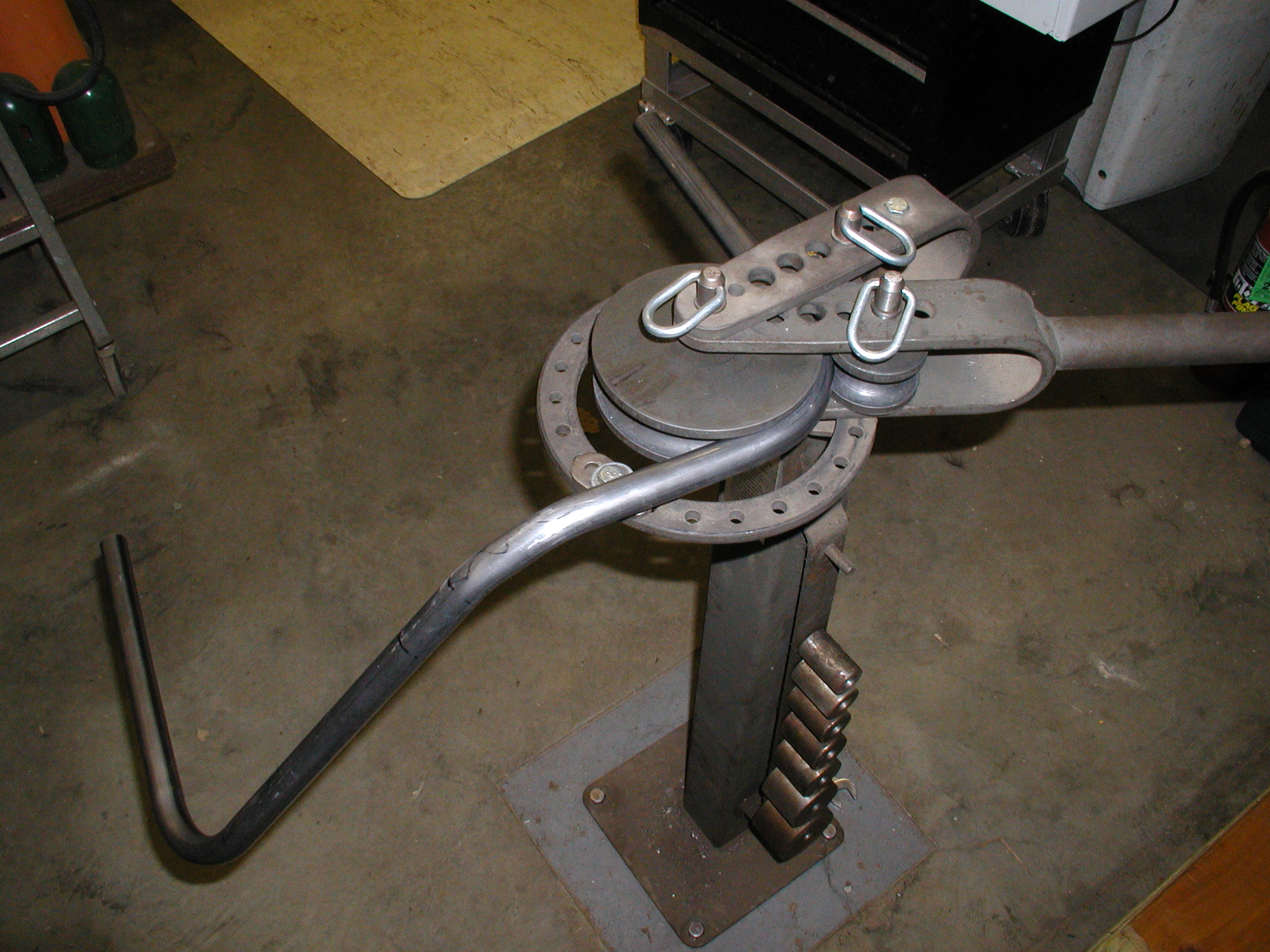

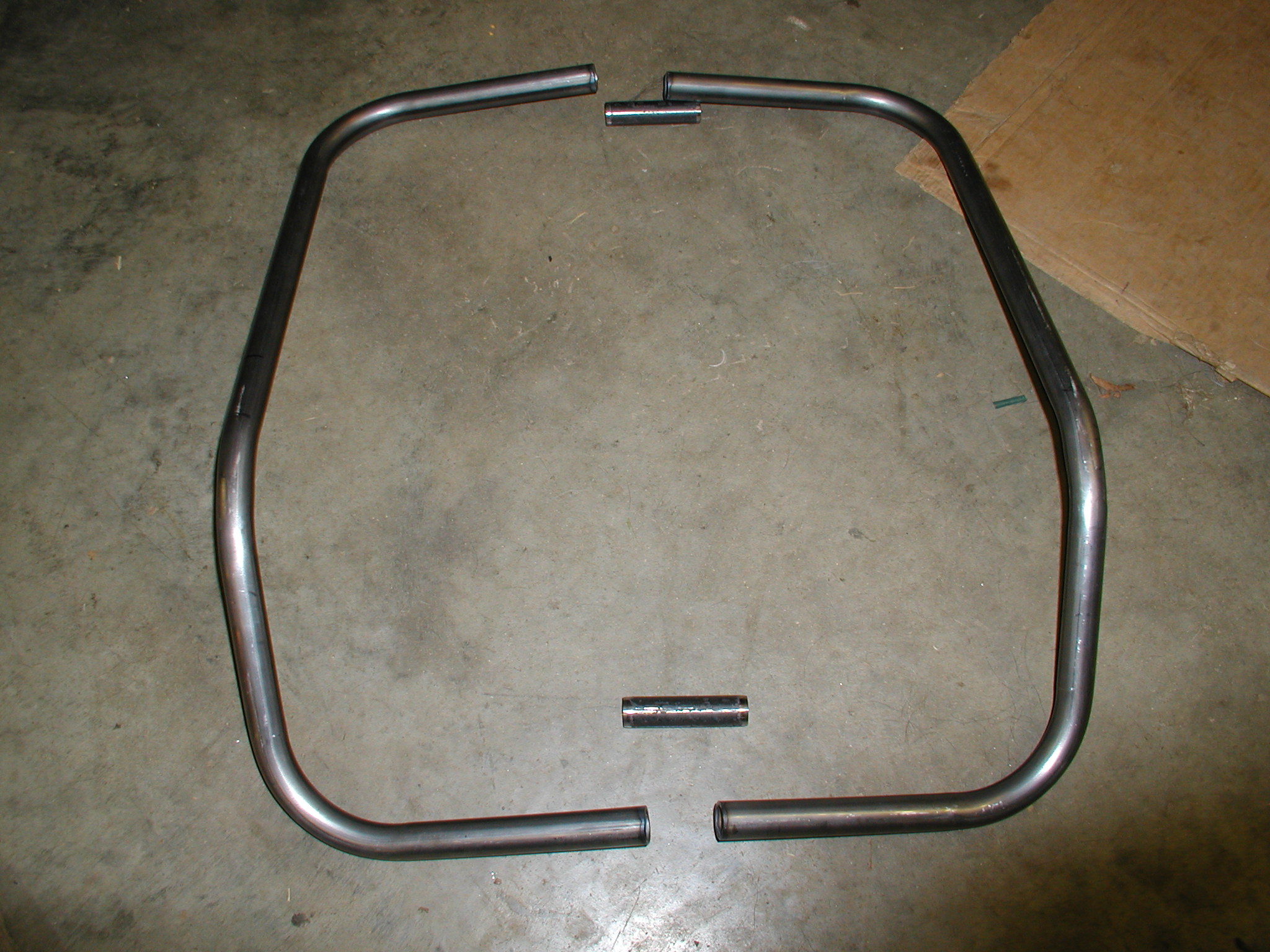

Yea, the 12 gauge expanded was found locally. 12 gauge is about 0.105" thick. The entire gaurd still tilts forward just fine, but it is a bit tight to reach down in there to get to the latch. I can do it bare-armed, but not with a jacket on. More pics attached, 'cause we all love pics. The last pic is a top view, gaurd opened forward to access the hood, and before paint, which helps show it better.

That's a thing of beauty!! Well done. (If the rest of your shop is outfitted with other goodies on the scale of that pipe bender -- I'll be down around 9:00am! :D) The floor mat is a nice touch, too.
