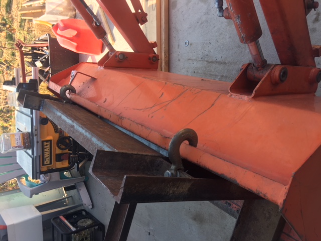

lol, lots of interesting ideas here. I totally understand the concerned bout blowing a hyd line and contaminating the grapes, doesn't sound great. I have maybe 30 bins i need to tip in the end so multi use is important. I think i'm going to take the risk this year and roll with the mini x version. Keep it simple and use a ratchet strap to keep the bin on the forks. It won't be glamorous but the seasons is getting near so i'm ging to keep this simple. I'll start throwing up pics as i roll it out. Thanks for all the feedback so far.
   / Designing a bin tipper, sizing hydraulics.
#60

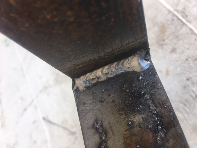

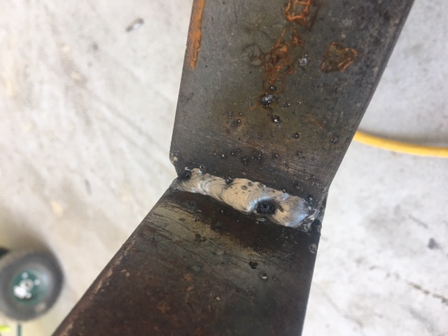

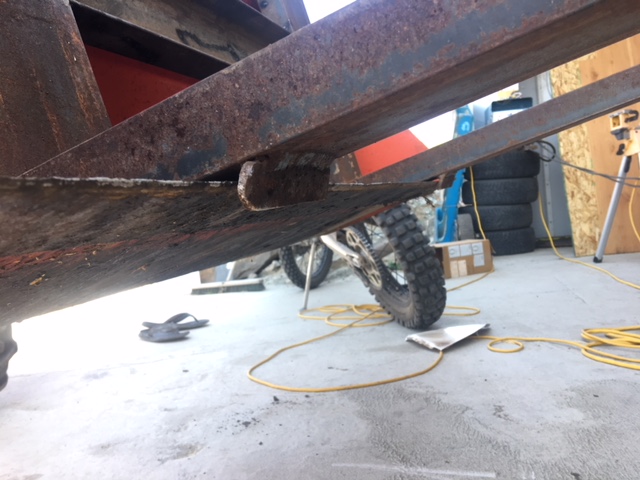

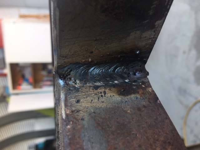

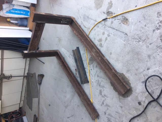

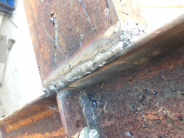

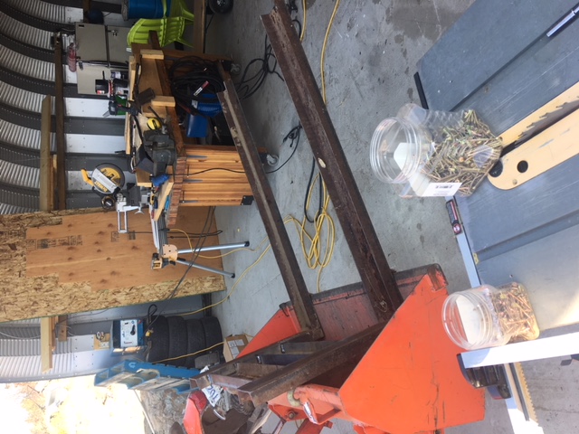

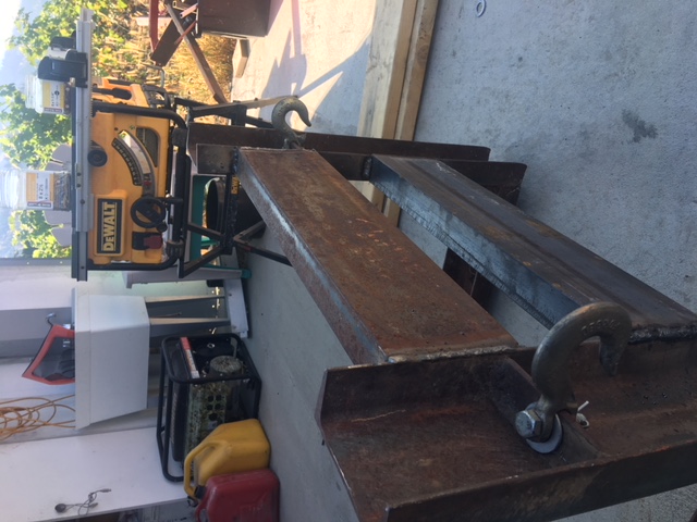

ok, it was a reasonably simple build, but there are some questions in here about what i have cooked up. It's been a while since I did any major welding so some of my seams are sloppy but I feel good about the strength. So question number 1. I built it to also be able to slip onto the bucket on my tractor. Right now I just have a couple of burly hooks rigged up. It seems like I will have to thicken the tounge that they latch to. I'm wondering if the hook setup is going to just fail on me or if i should be able to count on some durability. 2. I have not adapted it for the mini-x yet, but I was thinking I would just use say 6x 3/4" bolts through the channel and through the bucket bottom for mounting. Thoughts? Also I added a couple stubby hooks on the bottom to engage the blade so it doesn't want to slip around.
