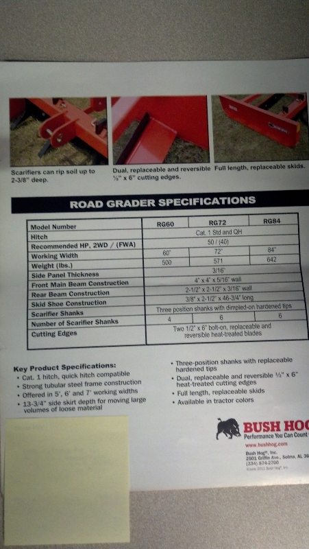

Found some specific sizing info.
   / Designing a LPGS #26
I just bought the 5' model of that. Mine is actually a Dirt Dog, who makes it for Bush Hog. Going to try it out this weekend, so I will let you know how it works.
   / Designing a LPGS
#27
It was a Woods, so I consider that a name brand, so the thicknesses hold some merit with me.
Would love to know how it works. My guess is *great*, based on everything I've read, seen, and talked to people about.
Just need to get mine made or free up the cash to get one; rain kills my over-traveled seasonal road. My fab guy hasn't gotten back to me with a quote yet (just don't have the time to do it myself...)
   / Designing a LPGS #28
It was a Woods, (looks like a Bush Hog to me:confused3:)so I consider that a name brand, so the thicknesses hold some merit with me.
Actually if you look at the weights of the bigger names, Woods, Land Pride etc., their LPGS are actually on the lighter side. Don't get me wrong, as far as I can tell, they all work pretty good, just that the heavier units simply work better in a wider variety of conditions is all. ;)
