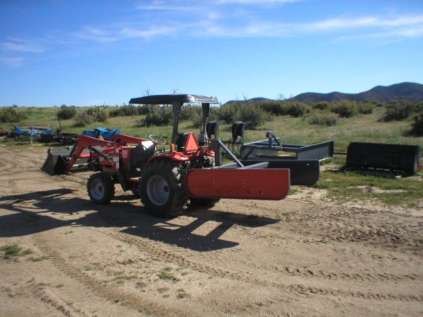

I've been following this as I intend to build one for myself soon. I see that some designs have angled blades and others have them mounted straight. Is there a specific reason or advantage of one vs the other? Or disadvantage for that matter?
Supposedly the angled blades transfer material side ways so as to help maintain a crown in a drive. While this is good in theory, the material moves such a small amount (less than 1" in my experience) that in reality it makes no difference.
The angled blades should cut wash boarding better than the straight blades. There are TBN members that say that their straight blades work just fine.
I have 2 units that I purchased, they have angled blades. The best that I can tell, all the manufactured units have angled blades while most if not all of the home made units have straight blades. Now why do you think that is? Wouldn't be because it's easier to mount them straight than it is at an angle. No, that wouldn't be the reason. :rolleyes: My thinking is that the difference that there might be between straight and angled is so small, that it really doesn't matter.
I think that one of the biggest things that can't seem to be decided on is how far the cutting edges should be set below the runners. Some say flush, some say more, all I know is that mine are set 1" down and everything works just fine for me. ;)
