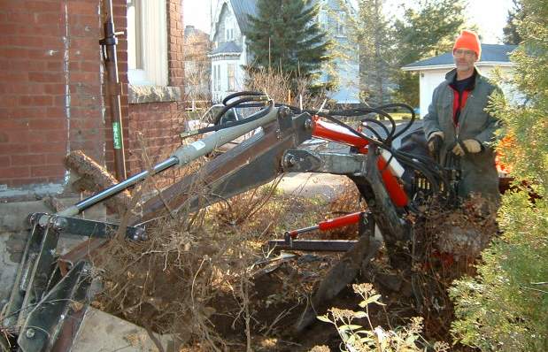

I designed and built a backhoe this past year, and yes I'm one of those Canadian guys over at MBN (Machine Builders Network) /forums/images/graemlins/smile.gif.
There are lots of pictures of what I built, and several threads covering the trials and tribulations of the design process.
I looked at the various plans that were available, but didn't find any that met my needs. The closest were the CDP plans (were a bit smaller than I wanted), and the ubuildit GroundHawg ones.
I've seen some of the CADdigger/CADtrac plans and I wasn't impressed with the professionalism of the plans. Granted lots of people have built to them, but I think they could and should be much better.
The design process was quite time consuming. A good portion of that was the research process, I spend ages trolling the web looking at everything I could find. Those Landpride manuals were useful. I also looked at a good number of commercial units, in fact pretty much any one I saw! It would have been good if I'd had my digital camera during this phase /forums/images/graemlins/smile.gif. I also liked the Shaeff/Terex mini ex boom design, so pattered a fair bit off it. It also looks like the new New Holland mini-ex's are similar, with the boom cylinder on top of the boom.
I should note that I was a mechanical engineer once upon a time, so I could "run the numbers" in a few places. There are some fairly significant stresses in some parts of the hoe (e.g. end of the dipper).
I used 1" pins for all the joints, except for 1.25" for the main boom, dipper and swing pivots. I used two swing cylinders so I could get the full 180° rotation there. I did excel spreadsheets to help design the geometry associated with each cylinder.
I got it "operational" (not finished /forums/images/graemlins/smile.gif ) about a month ago, and used it to dig for the front porch foundations, and to take out some trees. Overall it works very well. I was able to lift a 650# welder, and some big lumps of concrete, so it seems pretty strong.
About the only changes I'd make (so far) would be to go for more bucket rotation ("uncurl") to make it easier to dig small, deep holes (I had it this way first, and re-designed it to have slightly less rotation, but more power /forums/images/graemlins/frown.gif ). I'd also probably widen out the base at the lower end of the boom, to better transfer the swing loads, although I haven't had any trouble as of yet.
I have it mounted on my AC D14 for now (it's also designed so I could use it as a "stand-alone" type hoe like the Ground Hawg (and others)). It was/is a fun project. I probably spend more hours on the design than the build ... certainly very close. I had never used a backhoe until I got mine going, so that lack of experience slowed me down too. I'm pleased with the way it's turned out, and happily it turned out to be quite easy to run. I was able to dig out and lift the concrete after about 30 mins of use!
I've also uploaded a couple of the pictures to the photo albums here. For the rest go to the MBN forum, e.g. Final Progress Topic , there are others in there too (search on hoe), or MBN Backhoe Pictures.
HTH. Andrew
PS. Don't let that Bobodu guy scare you off either ... he's really a great guy and he's in therapy to get over his Canadianaphobia so I hear /forums/images/graemlins/grin.gif /forums/images/graemlins/grin.gif /forums/images/graemlins/grin.gif

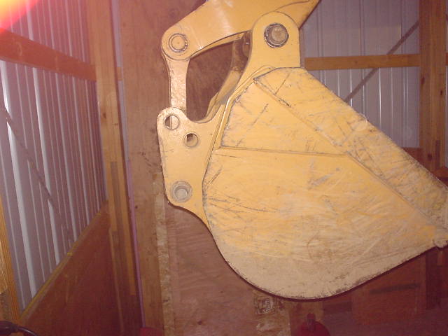

" About the only changes I'd make (so far) would be to go for more bucket rotation ("uncurl") to make it easier to dig small, deep holes "
Banjo,
My bucket has two holes where the linkage attachs to the back of the bucket. Pick one if you want a lot of uncurl; pick the other if you need to lift high, to load a truck, for example. Not having to cover such a large range of motion lets you design the linkage for more leverage. Sorry if you already knew this.
John
   / Designing and Building a backhoe, Need Help!!!! #19
John,
yes I know this, but didn't consider it as part of the design and implement it /forums/images/graemlins/frown.gif. In fact my initial linkage design had about 190° rotation and covered both cases, but I wasn't happy (on paper) with the power at the uncurl end of motion.
How often do you find you move the linkage? Actually the only time I've needed the greater "uncurl" was when trying to dig a smaller hole with a vertical back face. One I got down a bit, and had the dipper rotated, I ran out of bucket movement. How much rotation do you get with your hoe bucket?
I think I'm going to redo that part of the hoe when I change over to a quick attach for the bucket. Someone gave me ( /forums/images/graemlins/smile.gif ) a half built trenching bucket, and I'd like to build a wider ditching one (using the old trip loader bucket). At that point I'm going to seriously consider the two holes.
"Experience is what you get right after you needed it" /forums/images/graemlins/smile.gif
Appreciate the insight. Andrew.
   / Designing and Building a backhoe, Need Help!!!! #20
Andrew,
Here's a picture of how Case does it. I forgot there were 3 choices. Its almost always in the position for the most uncurl. (shown) The only time I miss the extra curl is when I try to dig too close to the tractor.
John
