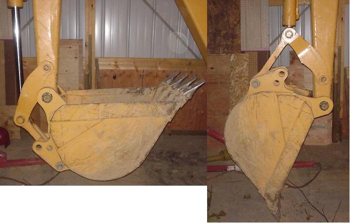

John,
thanks for the picture. It sure looks like there's a pretty big change in bucket movement available with those three holes. In the picture, it looks like it's in the full curl postion at that hole setting, right? Sometime if you could do a picture at full "uncurl" in that hole it would help too. It seems that something close to having the bottom of the bucket parallel to the dipper arm is about as much uncurl (there must be a better term /forums/images/graemlins/smile.gif ) as I've seen, but perhaps yours has even more at this setting?
Appreciate the effort and input, will really help me when I re-do mine.
thanks again, Andrew.
   / Designing and Building a backhoe, Need Help!!!! #22
Andrew,
Here's both positions, side by side. That bucket backside in the uncurled position doesn't look too vertical here but if you could see the whole tractor, the dipper really isn't in a normal dig position. As you reach back 35 degrees with the dipper, the back becomes vertical.
To others going thru what you have in designing these type of linkages, I'd recommend making cardboard scale models of the links' silhouettes, pin them together with thumb tacks at the pivot points, and run them thru their range of motion.
Good luck with your BH.
John

   / Designing and Building a backhoe, Need Help!!!! #23
John,
thanks for the pictures. I was looking, but don't seem to have a picture of mine uncurled, but I think it's not too far off what yours has, so maybe I'm not so far off. When I was digging my first "test hole" I was trying to get a vertical back, and figured I'd like to be able to get deeper than I was able. I'll have to take some next time I have it "fired up".
To design my linkages I did some spreadsheets to calculate the movement. For the bucket linkage, I used these for the first link, and then did the second ones on paper (I didn't have the patience to try to work out a spreadsheet in one go /forums/images/graemlins/smile.gif ). The spreadsheets were interesting too, as I could look at how the speed and force changed through the range of motion, and could change the endpoints so that I moved the force to where I thought it would be needed most.
I did do scale paper models, with drawing pins for the pivots. They helped a lot too to confirm I was close. I didn't do the vertical hole test case, so missed that one.
