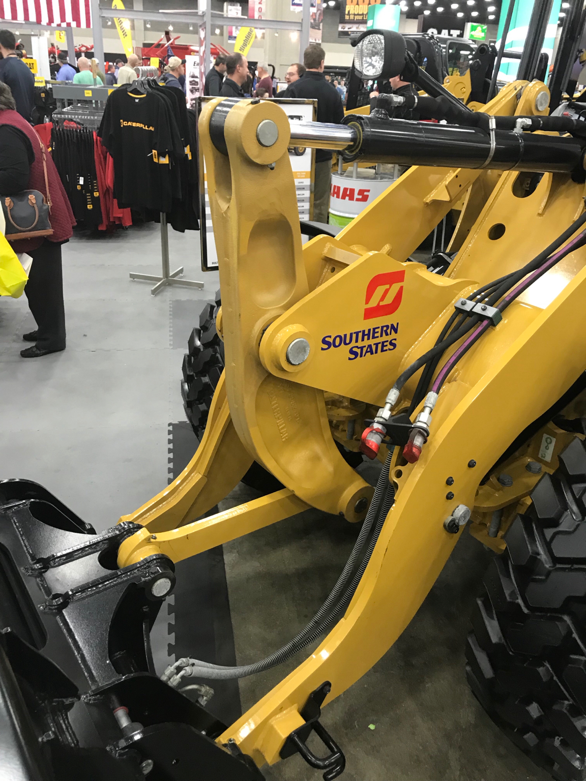

Physics lesson number one. This is the only way to curl a bucket up while extending the cylinder, without moving the cylinder under the bucket.
